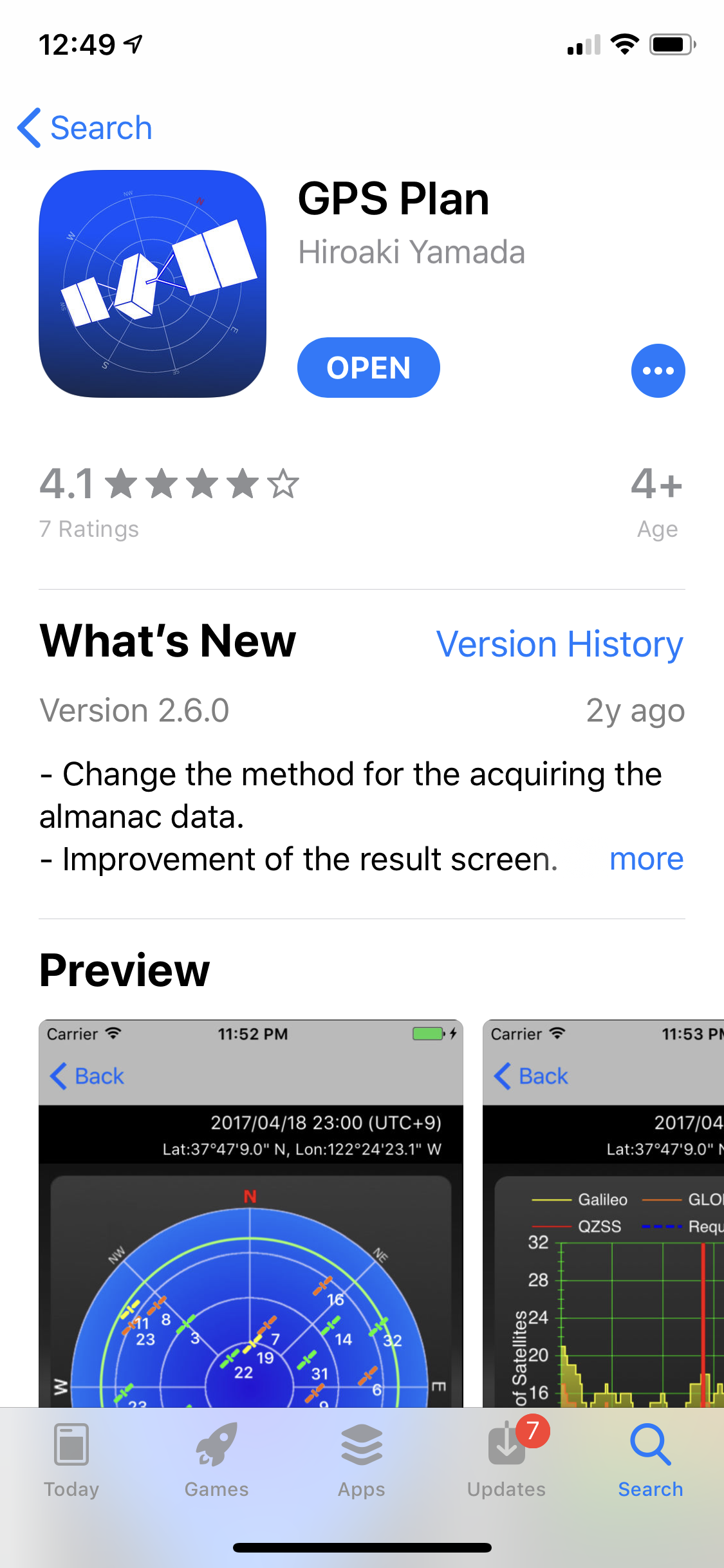

This app works good! You can set the angle above horizon limit and get a better idea of what GPS coverage will be.

I remember couple of years ago someone showed me a site which was like schedule of satellites. one could look how many satellites will be in your area tomorrow morning, by hour. and then you see number of satellites changes all the time, like sea tide. I can't find that site any more, but it would help me to go there when there is more satellites around me. Do you know of such resource by any chance?

This the one??
