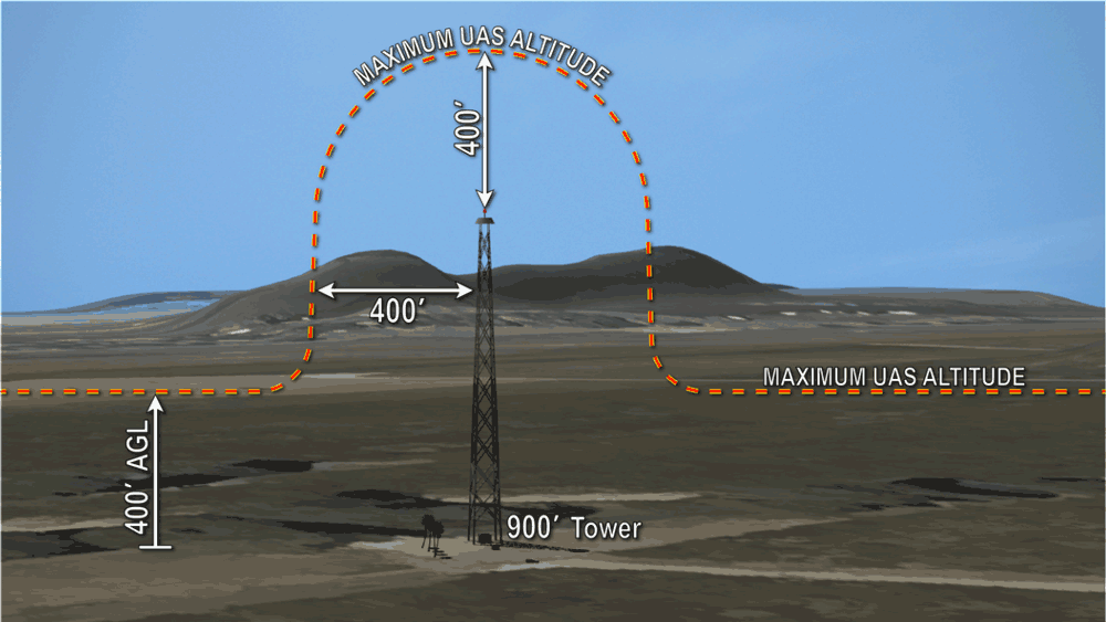

I realize the FAA recommends flying below 400 feet altitude but I’ve read here of drone pilots going 400 feet over the tallest structure in the area. I have a ham radio tower and antenna that extends 130 feet up so am I allowed to fly 530 feet around this structure? And, if correct, how far away from this structure can I maintain this altitude?

Yes you are correct. That applies to both Section 336 and Part 107 pilots. You can fly up to 400 feet above the top of that structure as long as you are within a 400 foot radius of the structure. So in your case it would be a max altitude of 530 feet within 400 feet of the structure. One other important part is that you can do so as long as you are not entering any other type of restricted airspace.

§107.51 Operating limitations for small unmanned aircraft.
A remote pilot in command and the person manipulating the flight controls of the small unmanned aircraft system must comply with all of the following operating limitations when operating a small unmanned aircraft system:​
(a) The groundspeed of the small unmanned aircraft may not exceed 87 knots (100 miles per hour).​
(b) The altitude of the small unmanned aircraft cannot be higher than 400 feet above ground level, unless the small unmanned aircraft:​
(1) Is flown within a 400-foot radius of a structure; and​
(2) Does not fly higher than 400 feet above the structure's immediate uppermost limit.​
(c) The minimum flight visibility, as observed from the location of the control station must be no less than 3 statute miles. For purposes of this section, flight visibility means the average slant distance from the control station at which prominent unlighted objects may be seen and identified by day and prominent lighted objects may be seen and identified by night.​
