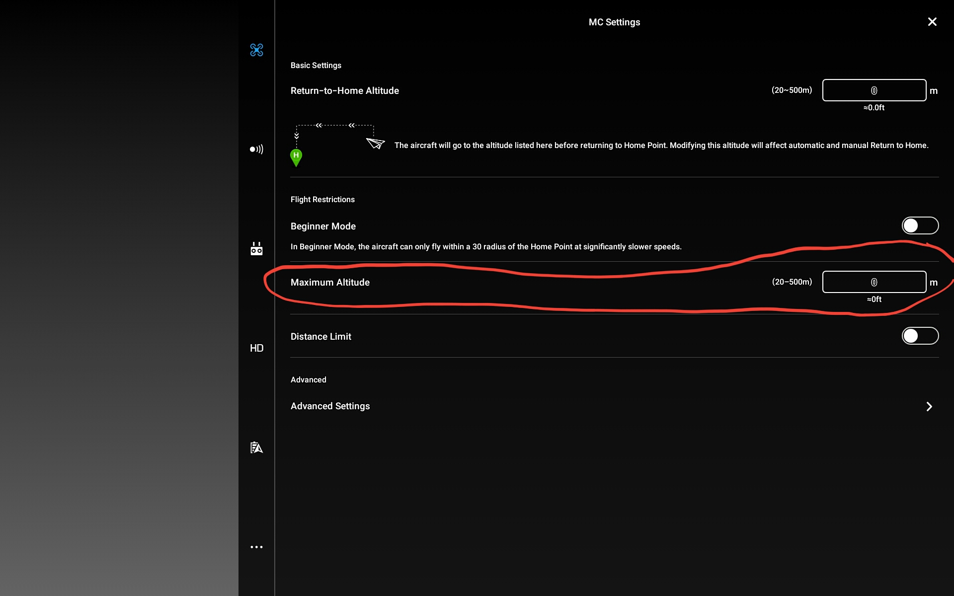

Tryed changing here,,it might not successfully set unless you accept, haven't try since me other p4 but got it to 1650ft by if remember right that's software limit,,I think that corect I have to check....at me old place I used to go up 1000ft to see over hill what ocean was doin
Tryed changing here,,it might not successfully set unless you accept, haven't try since me other p4 but got it to 1650ft by if remember right that's software limit,,I think that corect I have to checkView attachment 111451
Thanks for writing.
That limit was set to 400ft when I started the drone. When it requested MC change, i upped it to 450 ft, and it accepted the setting. now it shows 450ft as limit. But it still did not want to go higher than 20 ft without gps signal....
Any different when sttings changed like from imperial to mtr or no change in height ,,just have to go out for 5min but I be back
I actually changed a few times to metric and imperial, no difference. and different altitude settings. I just wasted battery trying these things out of desperation. so i think these settings are ok.
It has something to do with no gps signal, for sure. but can't figure out how to tackle this. Thanks for thinking about it! Cheers!
Yes 7 sats I think on limit but bit poor for p4p so I would suggest imu calibration to sort any funny issues like this,give it a try,something not quite right,my p4s gets up to 20 sats so that amaze me,,,is it restricted anywhere else you fly,,I think it normal to lose sats when around cliffs or shelter ,,,bit stumped myself on this so I have bit of a search around....I would also be cautious of take off in atti mode,,I'm unsure if home point is set

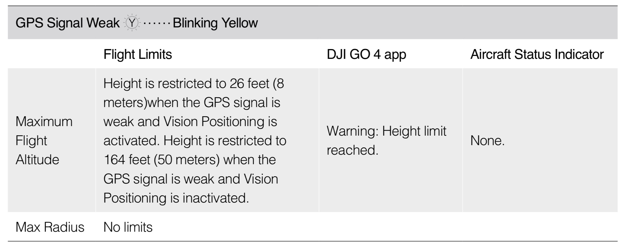

Sar104's pointed you to the reason for this.
The solution for you if you want to fly in a poor area for GPS reception, is to turn off the VPS sensors and you'll be able to climb to 164 feet (or higher if you pick up GPS on the way up).

When everyone is bored of speculating, there's always the manual:
thank you for pointing to this! Do you think it is an app limitation and using Litchi i can go higher without GPS, or it is in main controler of phantom?
Thanks again, looks like i am left without much luck to complete my job...
Reactions: Archaeo Drone
As @Meta4 mentioned, if you turn off VPS the limit increases to 50 meters. However, since flying with poor GPS positioning can cause other problems anyway, I'd just switch to ATTI mode, which will remove those restrictions.

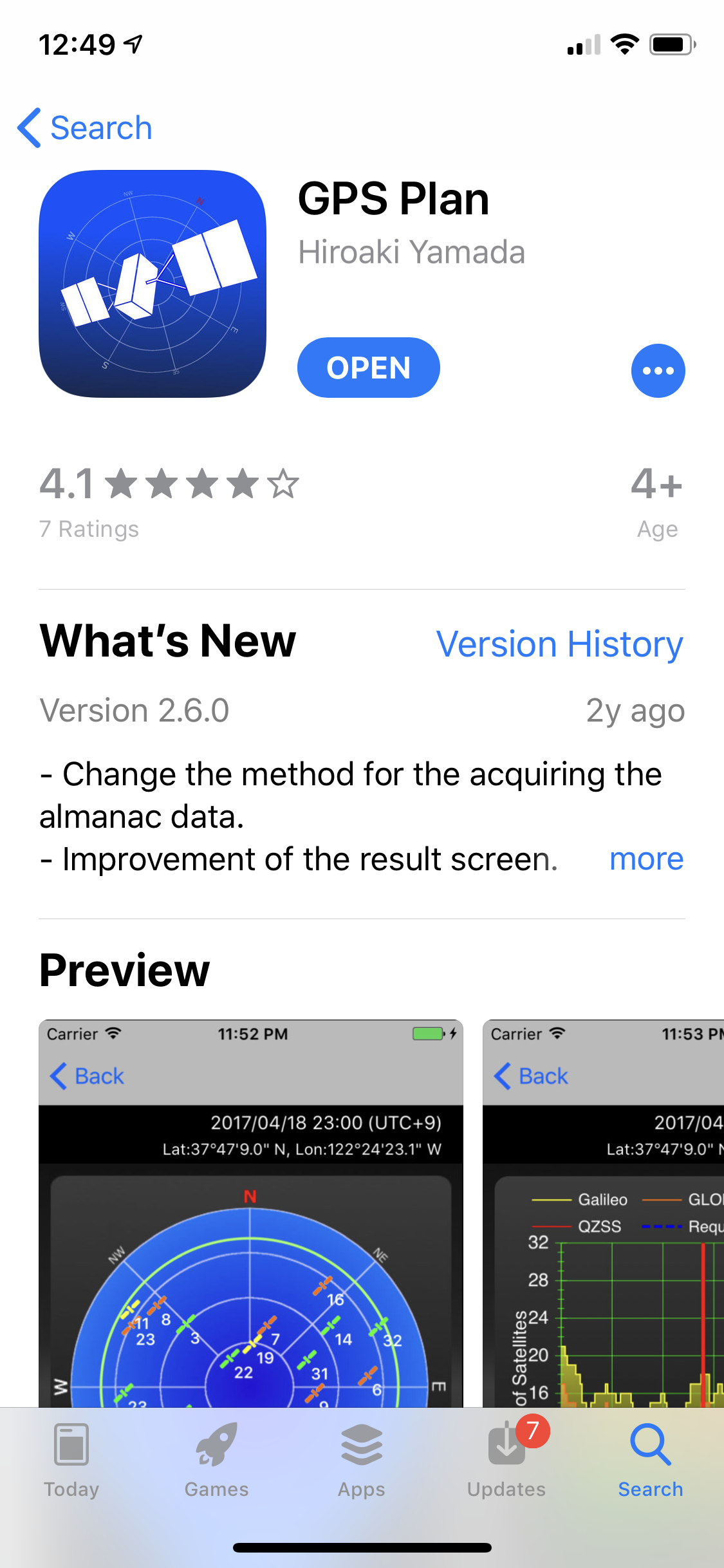

This app works good! You can set the angle above horizon limit and get a better idea of what GPS coverage will be.
