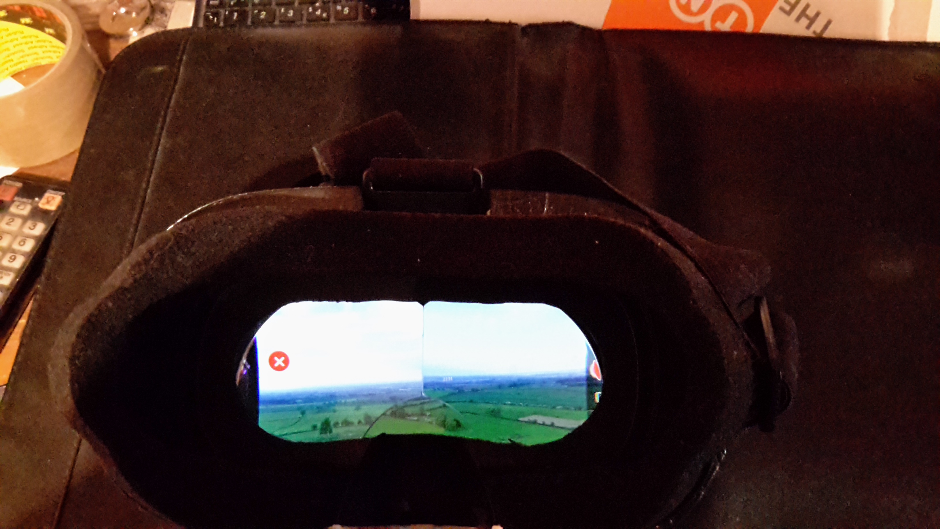

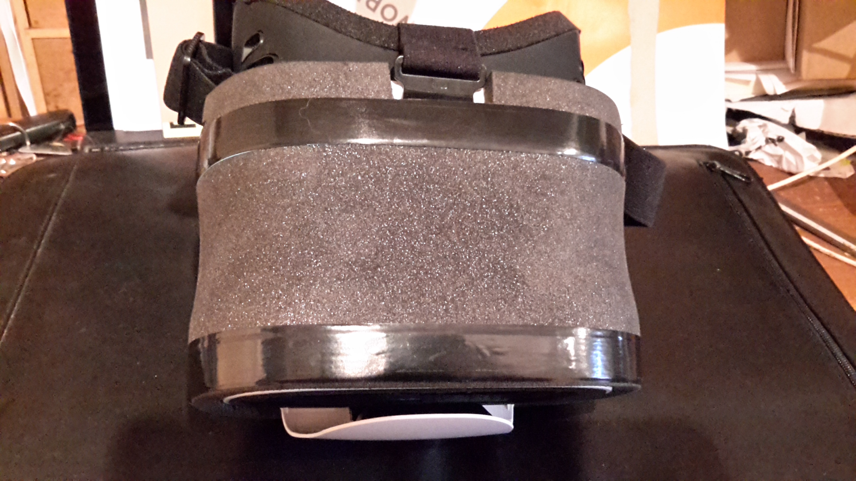

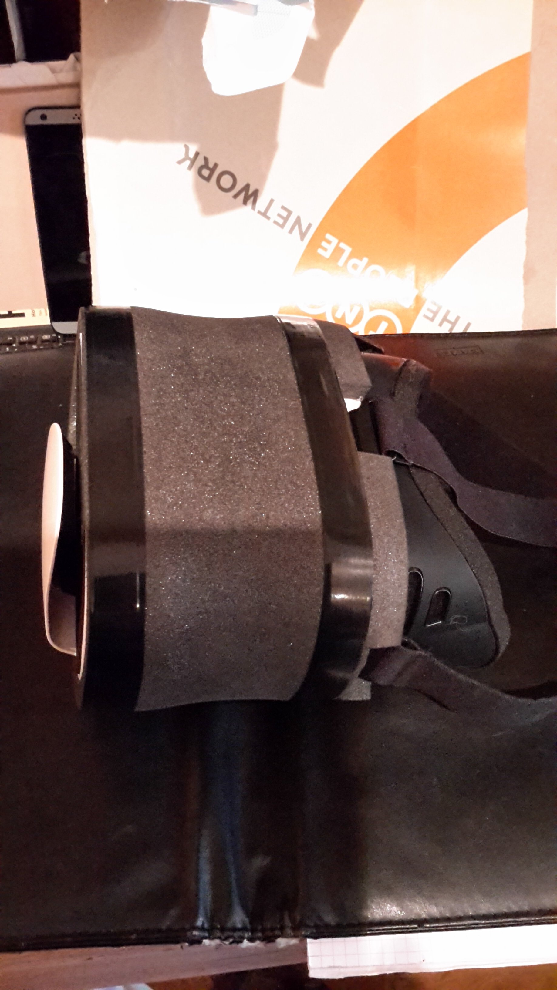

I made my own with a set of VRs and some RHO lenses, fly using USB, only problem I encountered was not being able to toggle between photo and video or cancelling RTH being as the phone is clipped into the front of the goggles, an option I may look at is using another phone in the holder and splitting the usb
[Doink] That looks just like what I did. Can you PM me. maybe we can compare notes. I used a HooToo viewer and it works fine but is kind of heavy and I wish it was more adjustable since some people see double in mine, some don't.

View attachment 65232 View attachment 65233 View attachment 65234
