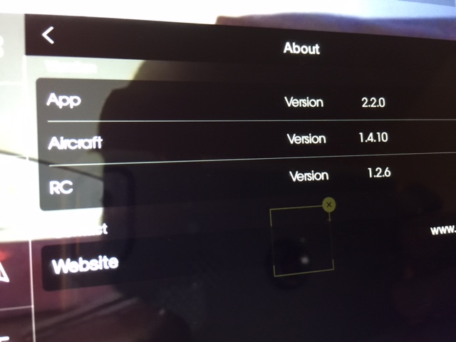

Here is the read out on ABOUT.....says latest are loaded on but I still get warning UPDATE REQUIRED! :(

Here is the read out on ABOUT.....says latest are loaded on but I still get warning UPDATE REQUIRED! :(View attachment 29965
UPDATE REQUIRED refers to your remote. Your remote needs to be 1.3.2 firmware to be latest.
Download 1.3.2 and update the controller as per DJI instructions.
***REMOTE CONTROLLER UPDATE IS REQUIRED if it is NOT the current 1.3.2***
Some users are still on 1.1.8, 1.1.9, 1.2.6, and 1.2.8 on their controllers. The latest 1.4 firmware will NOT update the controller. You need to do a 2 stage update. Get the bird and remote up to 1.3.2 and then do the 1.4 on the BIRD ONLY.

Dji assumed everyone is on 1.3.2 on both bird and controller. This why they stated update on rc is not required. The 1.4s instruction is firmware for bird only.
Dji should have stated that firmware update 1.3.2 is required before 1.4.
If you have 1.4 on bird, then download the 1.3.2 and do firmware update for controller. This will get rid of the update required warning. remember to do all the batteries to 1.3.2 as 1.4 does not do battery either.
