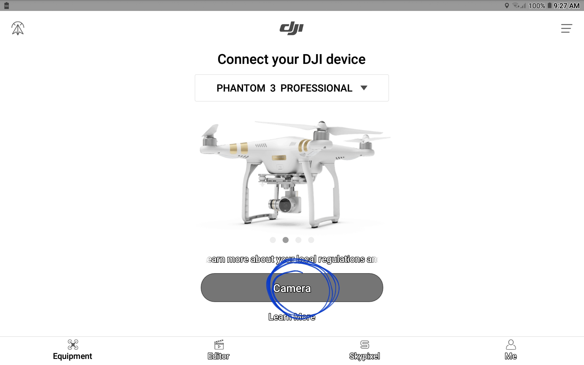

Batteries all charged up. Turned on remote, turned on battery, hooked up DJIGO App. The P3P does the D---DD. On the equipment screen all I see is my name and "Growth of Value" whatever that is. Then Footprints, Top Distance, Max Takeoff Altitude and Top Speed. No camera. Drone wont start up. Yellow light flashing and red light solid.
What am I doing wrong? Updated firmware from DJI website and it said the firmware install failed because the firmware I have is already as new or newer...
Help!
Can you click on cam instead of flight data or is that how it come up,,if you can enter cam view and check aircraft status,,,,also need more light colors,, link light,gimble,rc light colour and drone lights on rear
Ok actually figured out the Camera View issue; however, now when I try to start the drone I get the ESC error. One thing after another. I remember now this is why I quit flying it - because of the ESC error. I'll review other posts and topics, but if anyone has a quick link to the fix, I would appreciate it!
