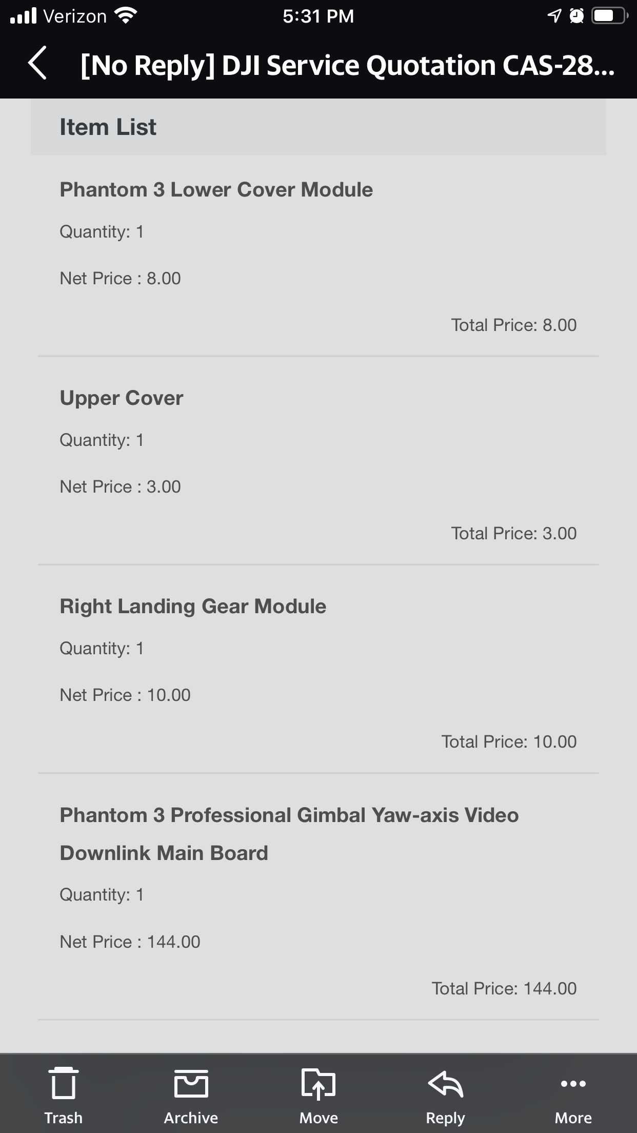

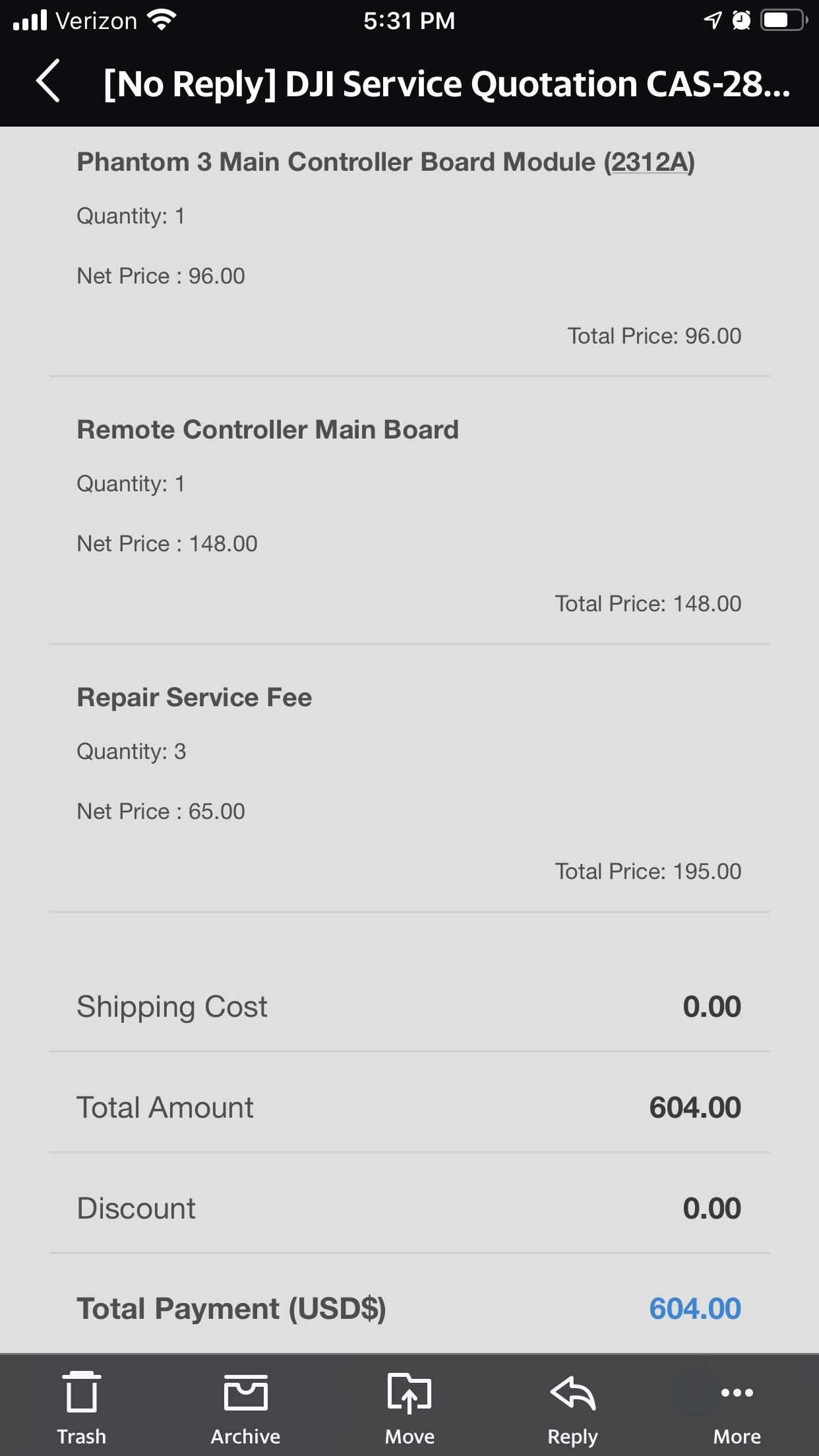

yup, I agree. I ran into the same issue. I actually sent my drone in for assessments and was sent an email and Bill for $600. Long story short, their customer service straight sucked, finally got my drone back 4 months later, and of course I wouldn’t pay the bill without speaking to a specialist which I never got the chance to. I had to tell them I was speaking with my lawyer just to get the drone back. Attached is a list of items needing to be replaced (even though it has never been crashed).
yikes good thing u did not pay cause this list looks like 2 many parts not needing a change!
