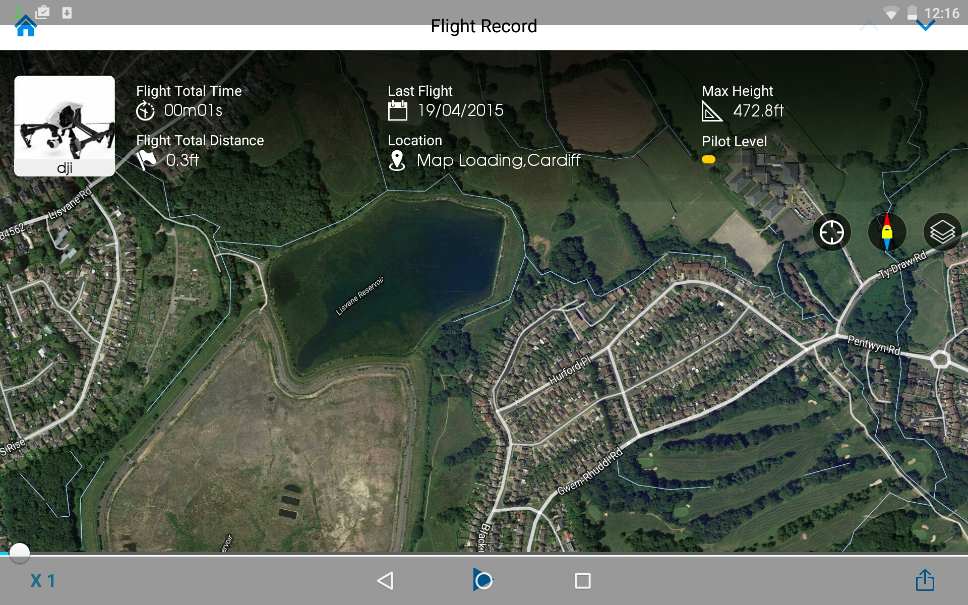

After I took the Phantom 3 apart put it back together and flew it past 400 feet for those who are worried about the ceiling height
