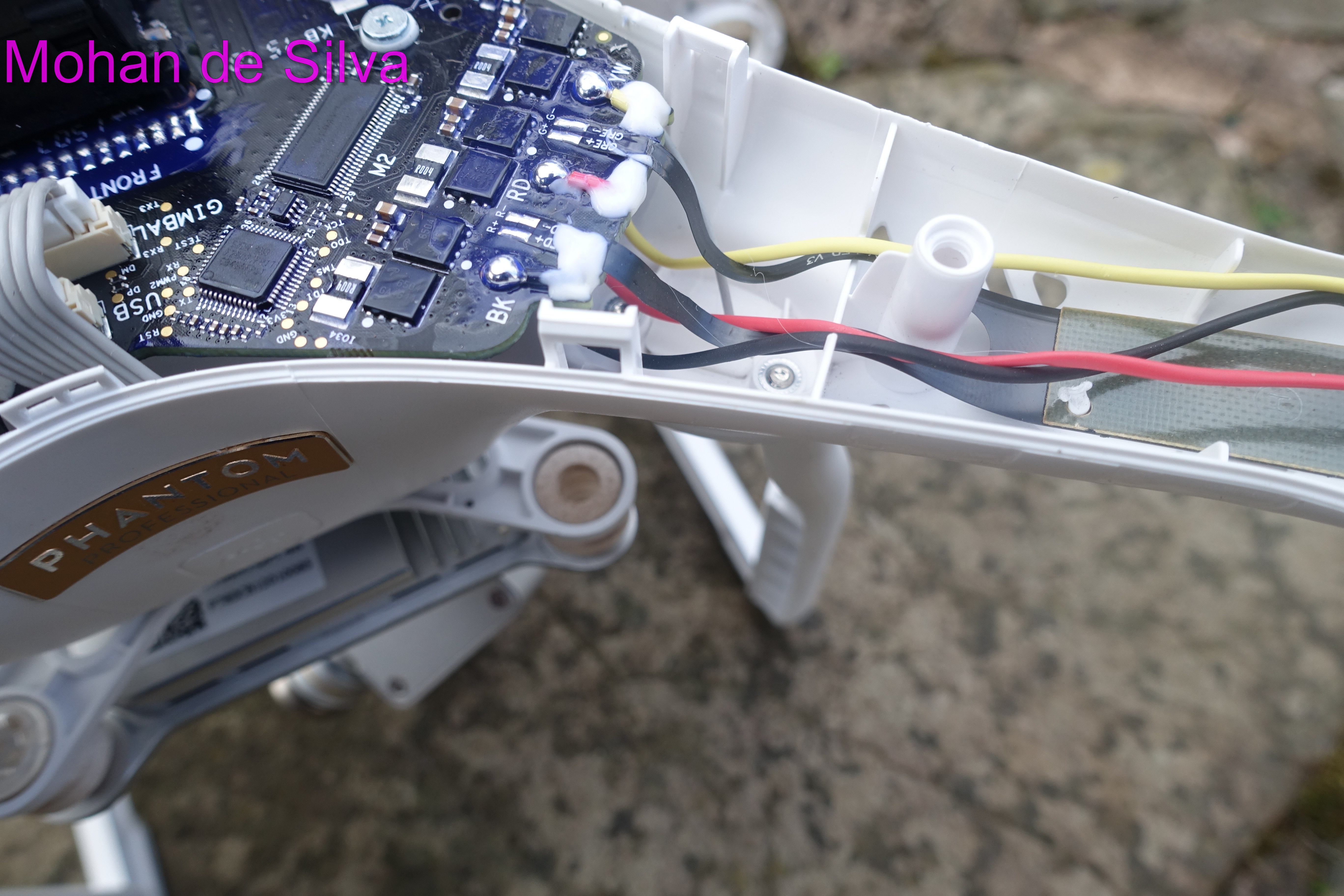

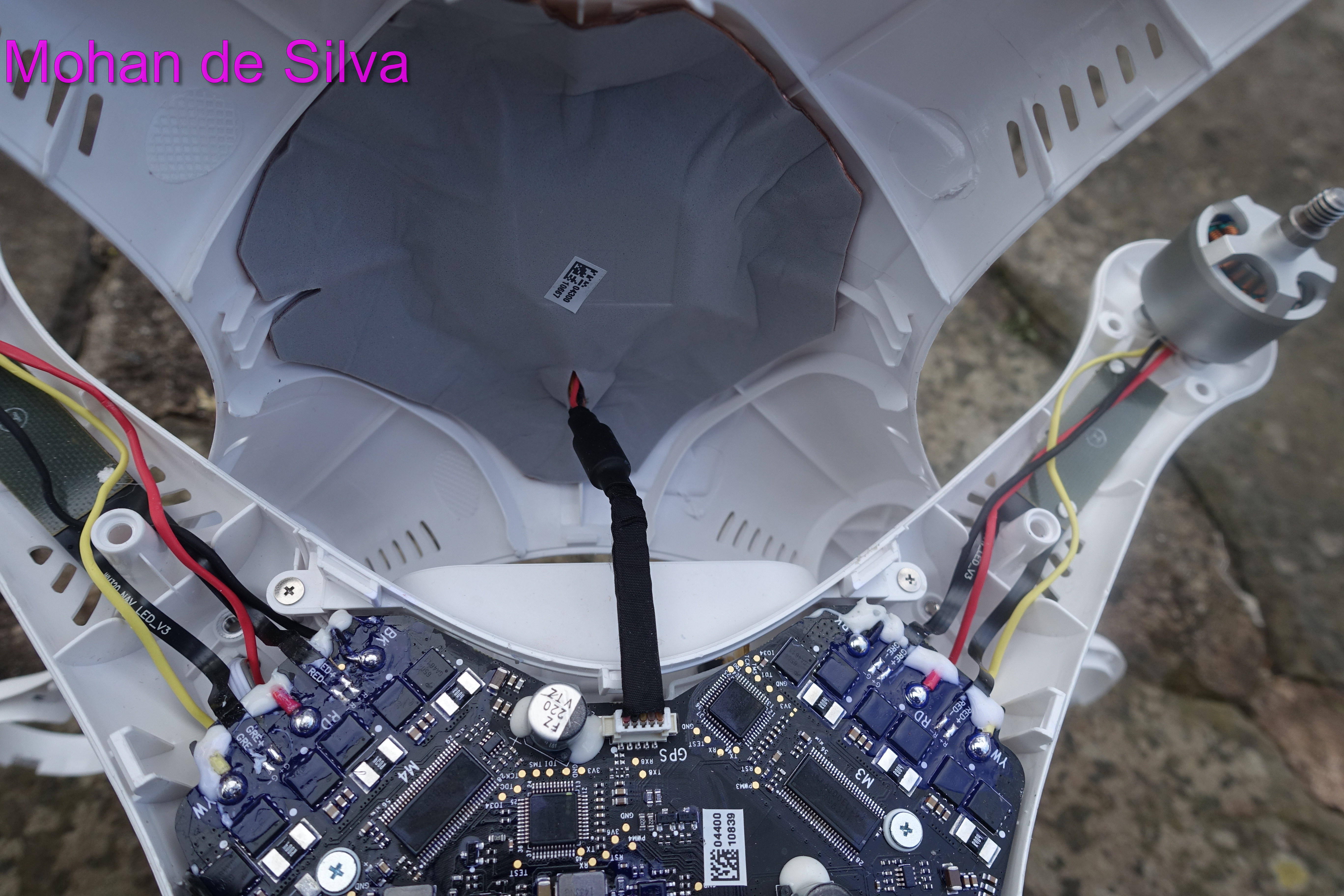

Internal Pictures
Taking the Phantom 3 apart is a Pain in the Rear. It is worse than trying to take an ipad apart. The new phantom 3 has locking tabs that need to be pushed into release the cover.
The screws are different - no more 2mm Hex and philips. The larger screws need a T8 and the small screw at the tip needs a T6

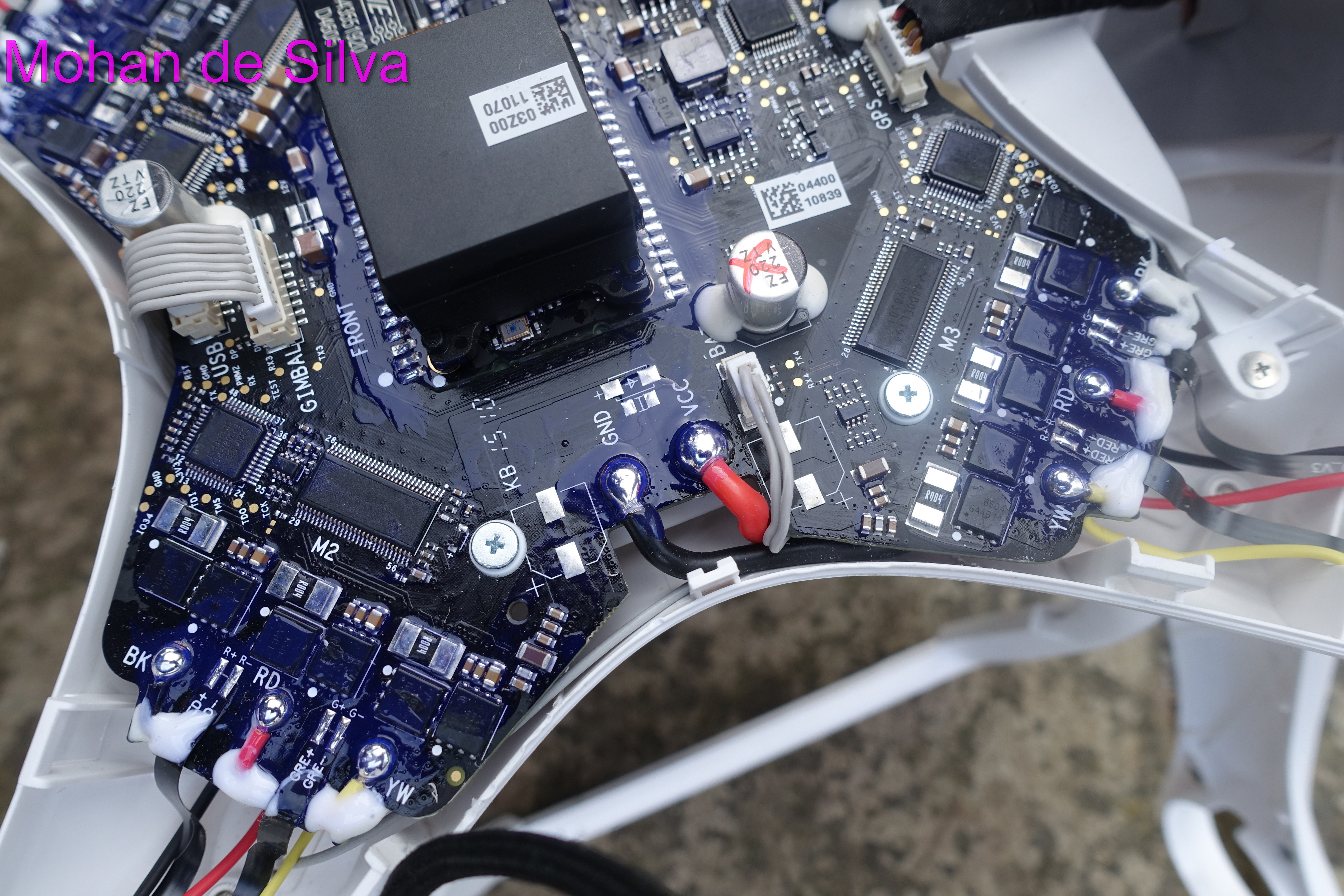

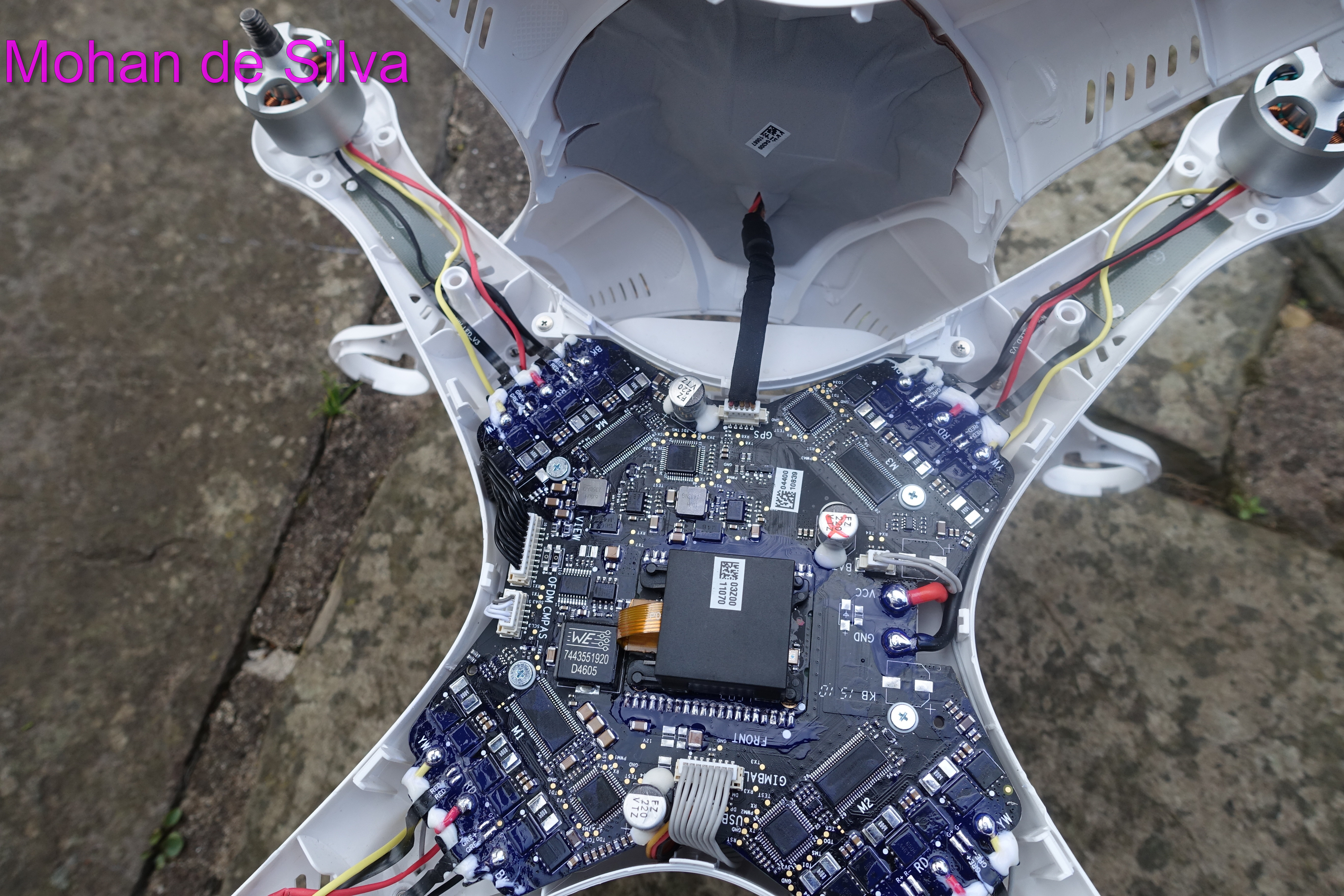

Hood off with GPS

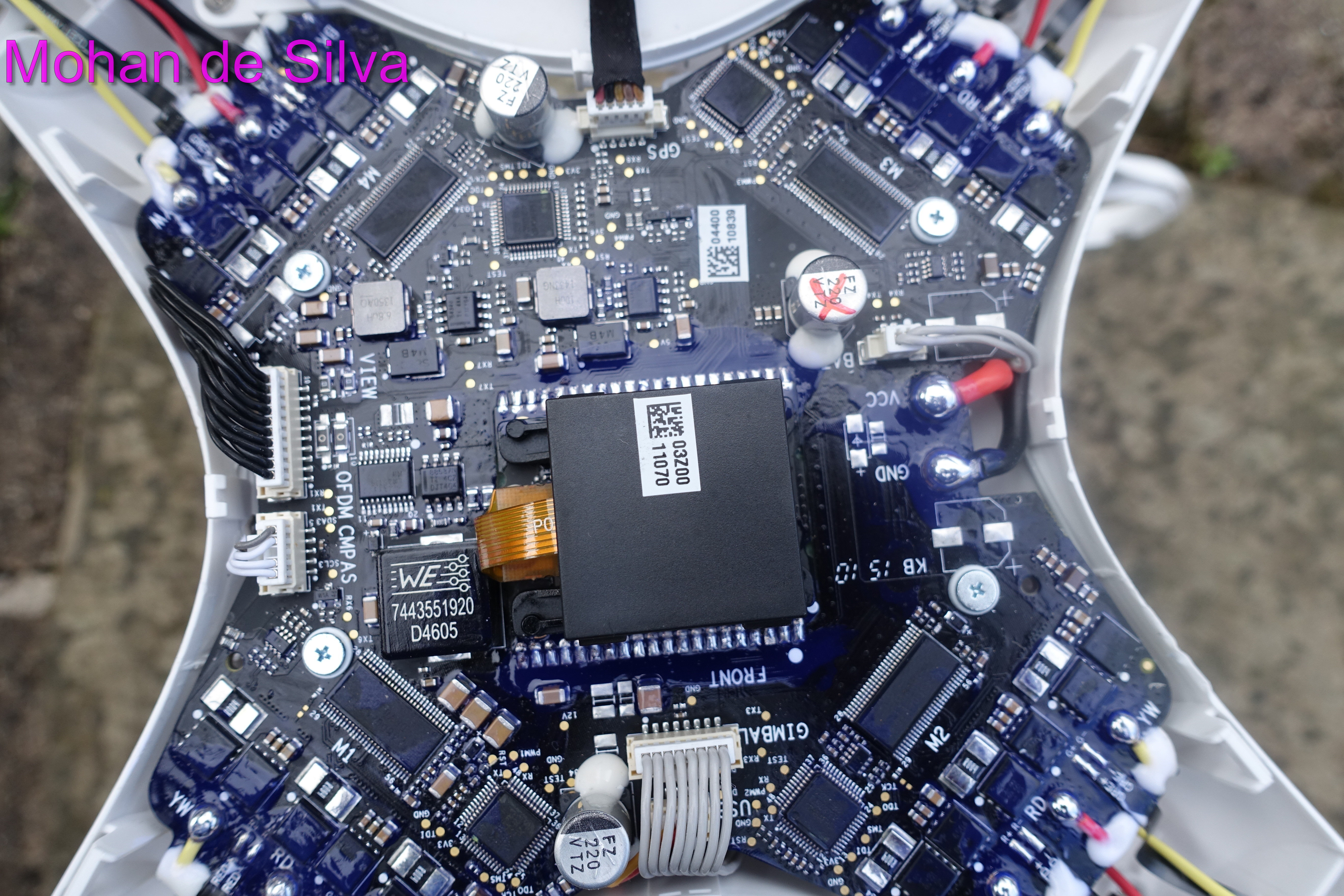

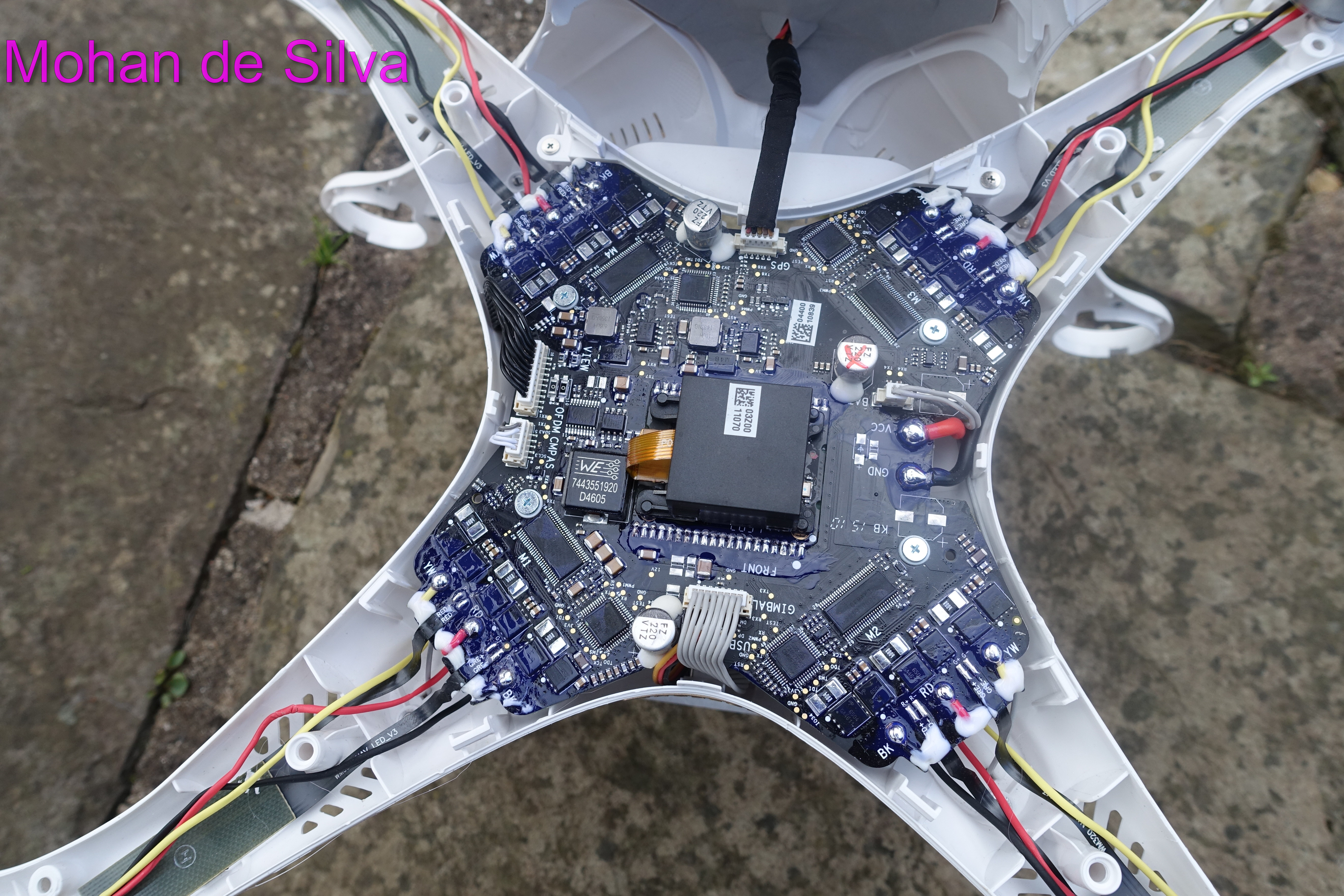

More detail of main board
Big Black Box with Ribbon connector

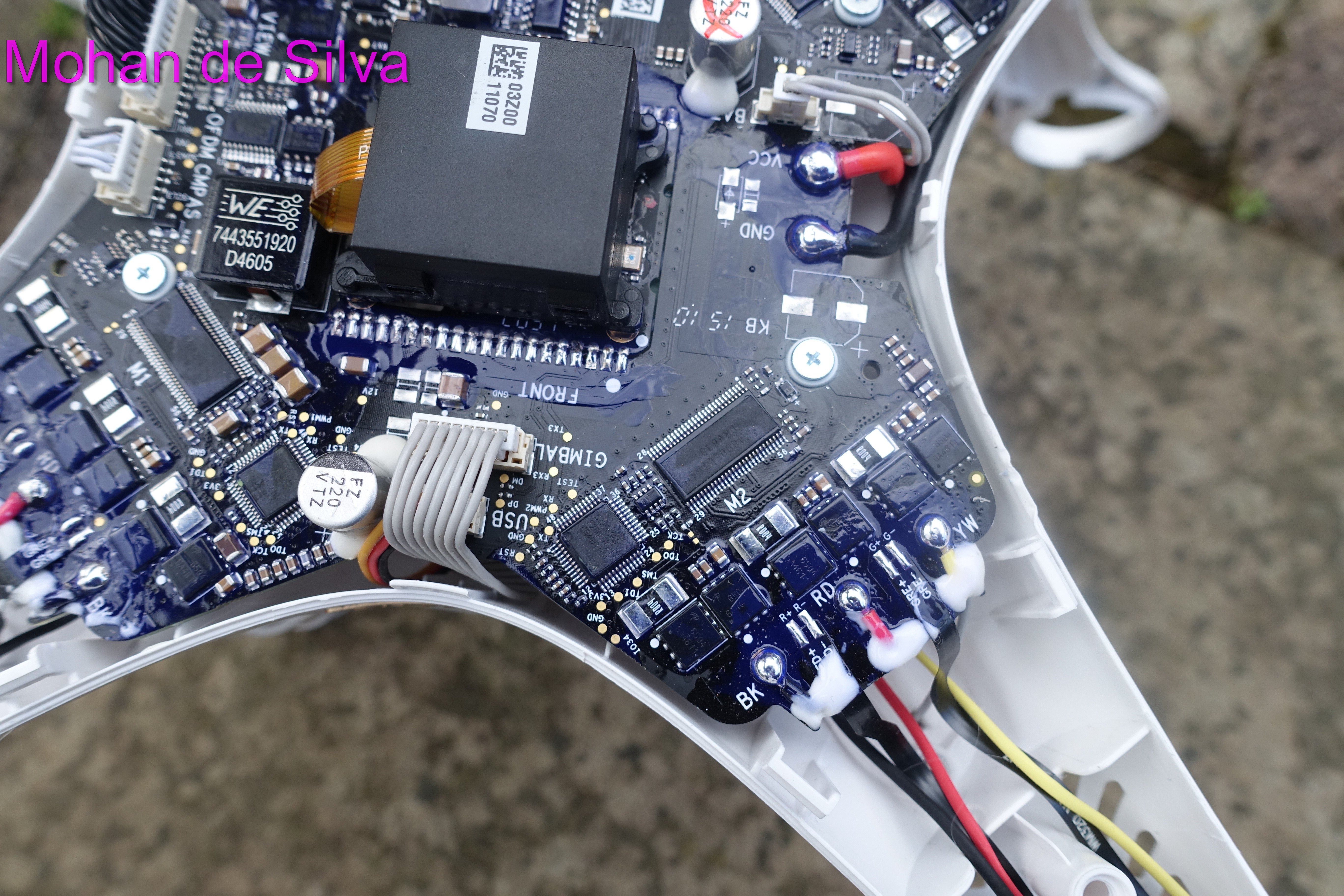

Another view - also ESC
Gimbal connector
Close up of GPS connector

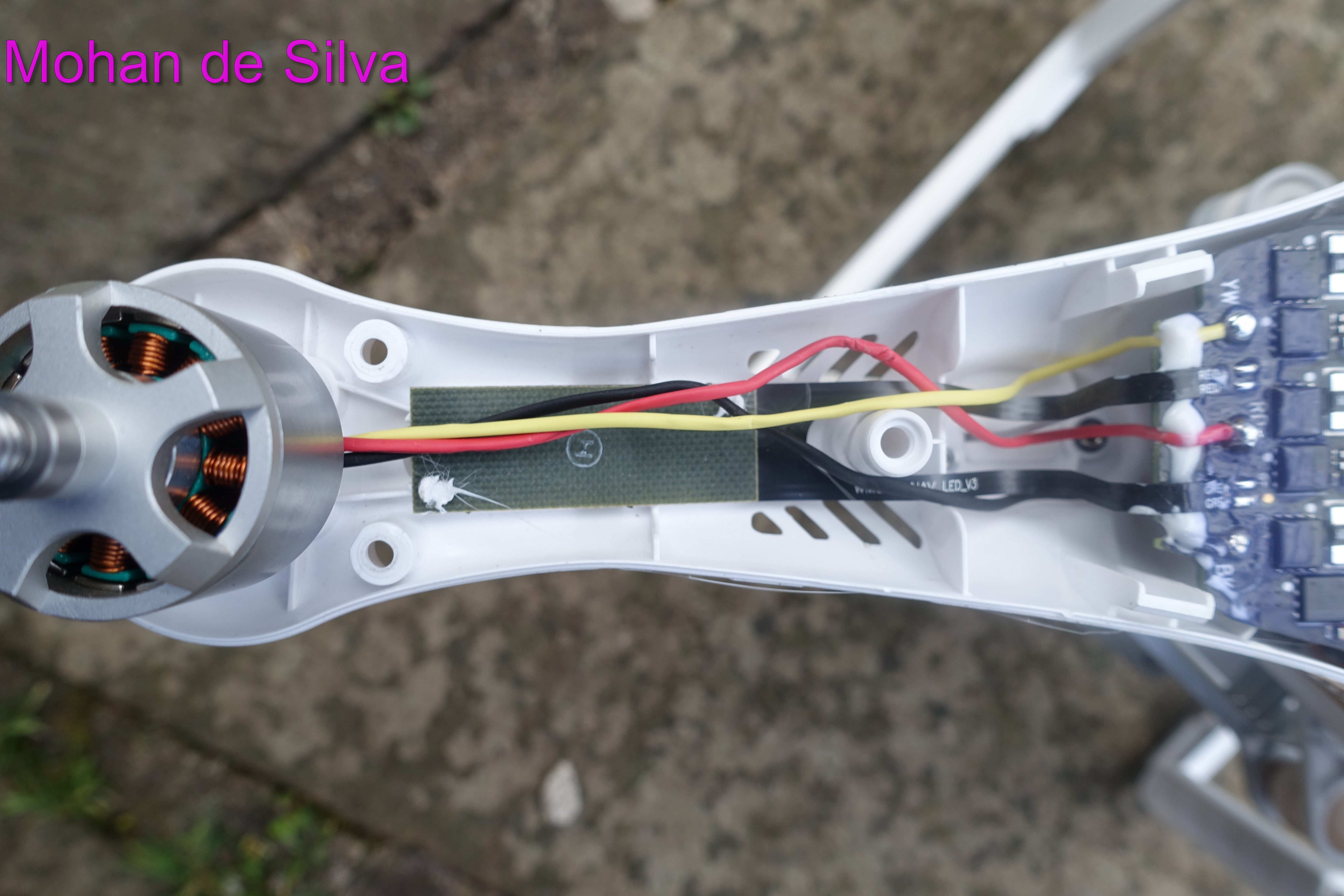

Motors

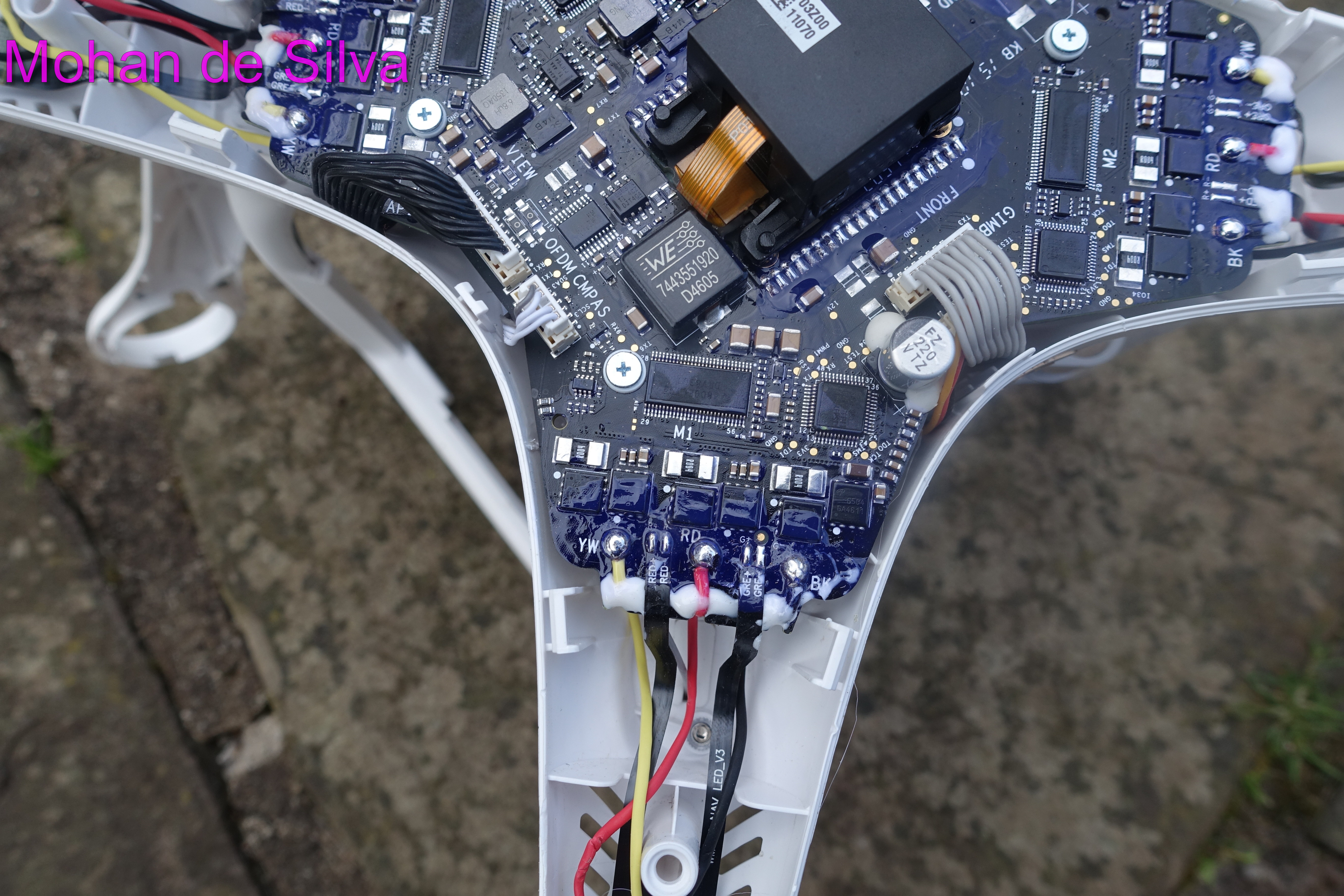

Fets on main board
Main powe
Part 2 to follow
At least they have put some decent gloop at the end of them motor wires on the esc end to stop stress on the solder joints, there learning at last lol
