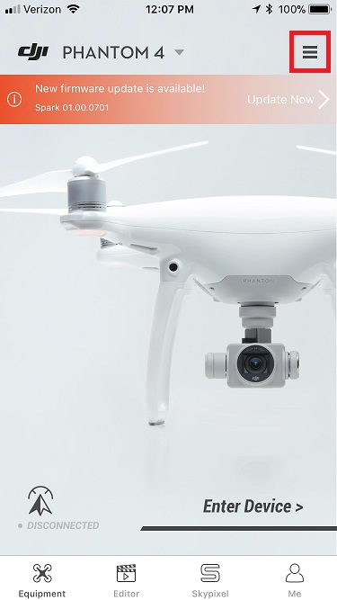

What happens when you connect the remote controller to your phone, start DJI GO 4, and click and hold the three lines at the top, right for ~5 seconds?
That should display a screen that shows the current remote controller firmware version (along with the version you can upgrade to).
