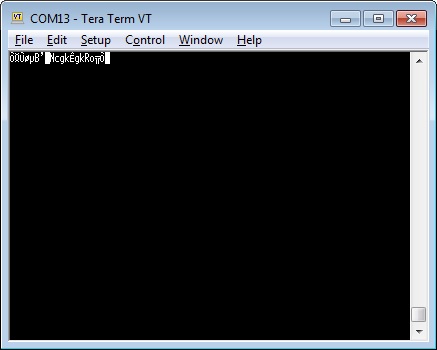

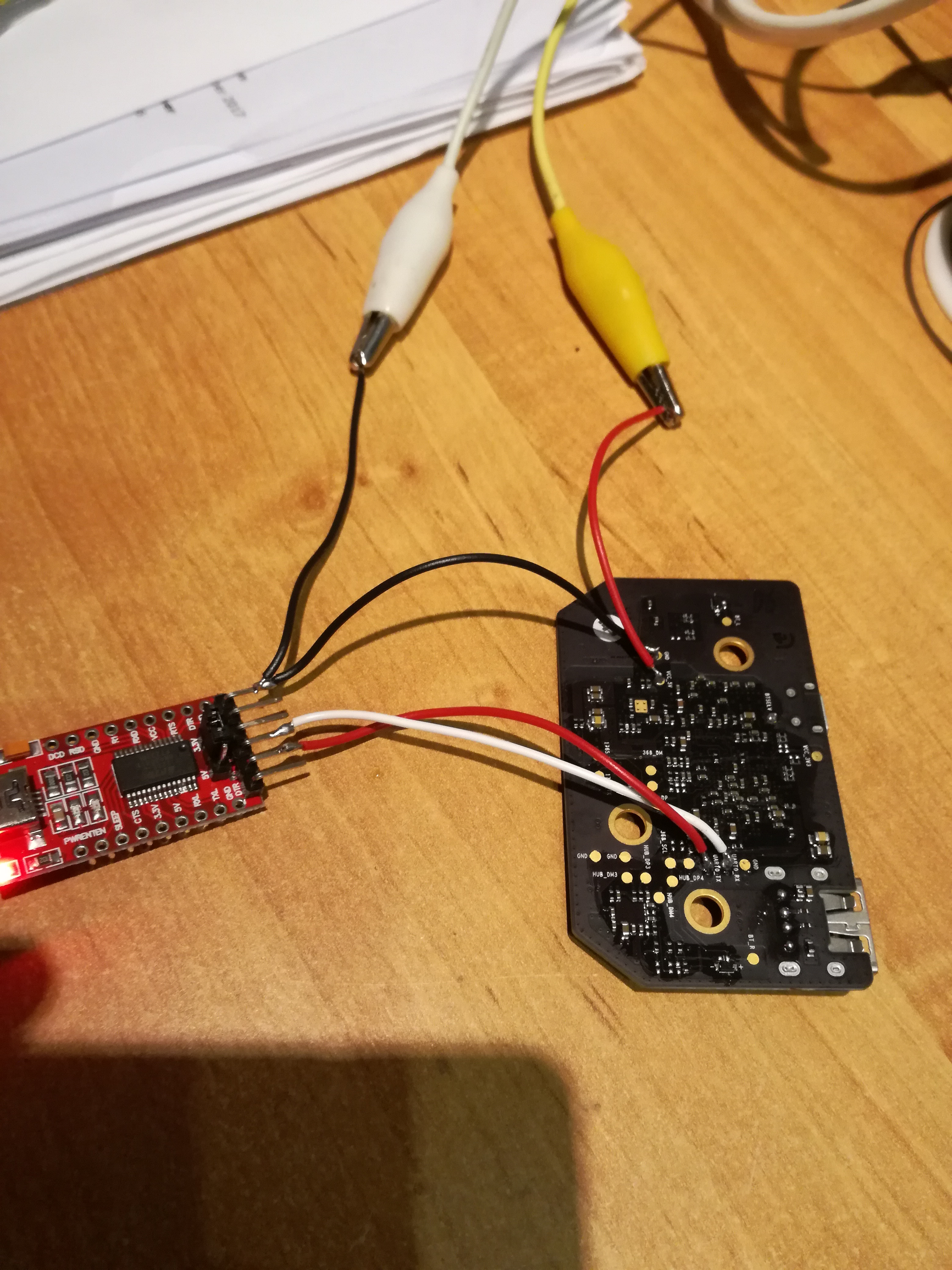

Im getting this gibberish when I connect mine USB board (P00928.03)
It draws 0.7 amp from the 5 V supply which I think is a lot.
I have gnd to gnd, and 5V to 5V
It helped changing speed to 115200. Now I get bootme when btselv and 3.3V conencted. But nothing without the boot wire.
