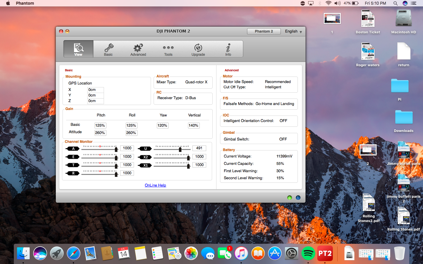

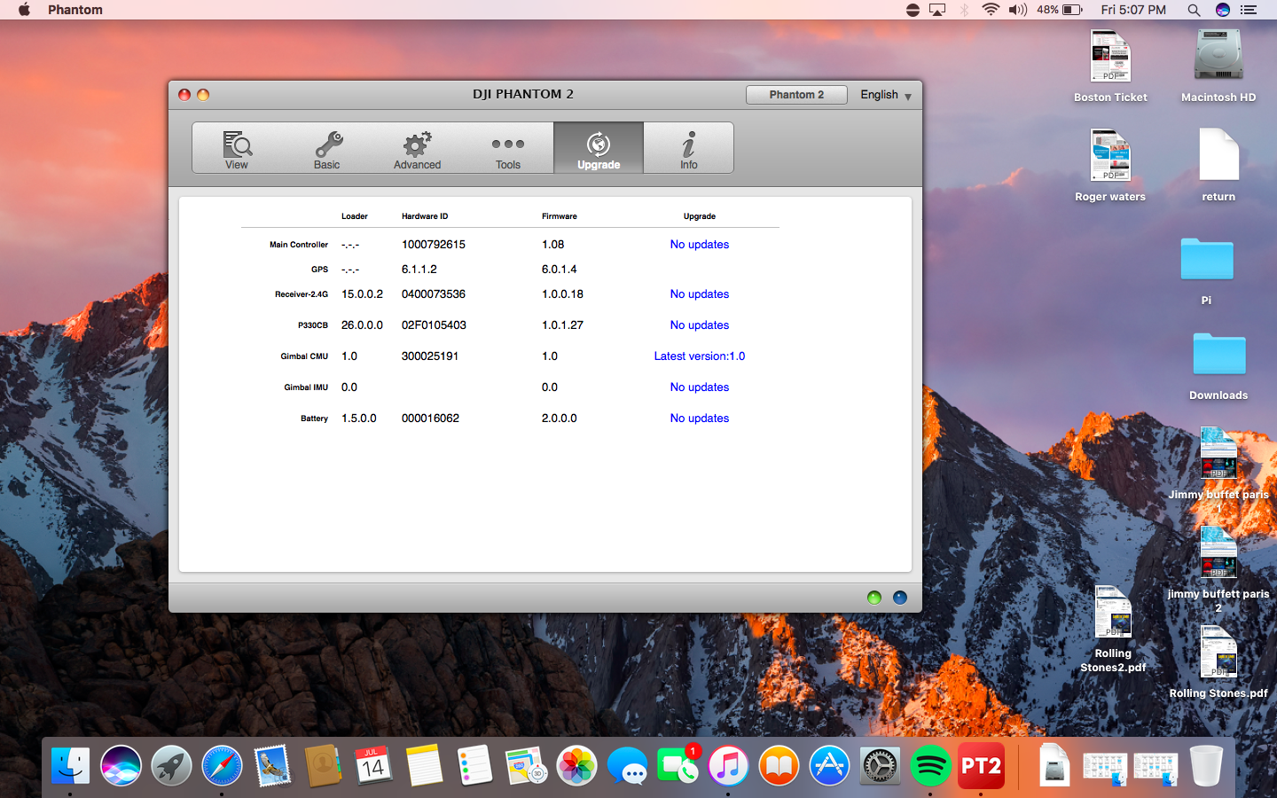

If that is indeed a new P2 is shouldn't have v1.08 software nor come with H3-3D gimbal either. None of the FPV equipment has anything to do with the gimbal not being recognized on the upgrades page. One I would like to see a screenshot of the upgrade page if you would. Next, I would like a screenshot of the front page when you first plug in the P2 to if it like the following photo.

View attachment 85361 View attachment 85362
Since are logged into DJI you will have to upgrade your software in order to gain access to the gimbals software. There are two upgrades on the DJI site software version 3.8 and 3.6. Personally, I stopped at v3.6 and have no interest what so ever in v3.8 or the NFZ in DC or Japan.
Try logging into DJI site and see if it will the latest upgrades and you do not have to update the P2 assistant software if you want is the software for the gimbal. I did the same thing when I installed a new H3-3D and of course, after logging in I received the latest upgrades but only used the gimbal upgrade. There are some changes in the newer P2 assistant soft in regards to the gimbal and the gain settings due to the extra weight of the gimbal and camera. But of course, that's your decision to make.

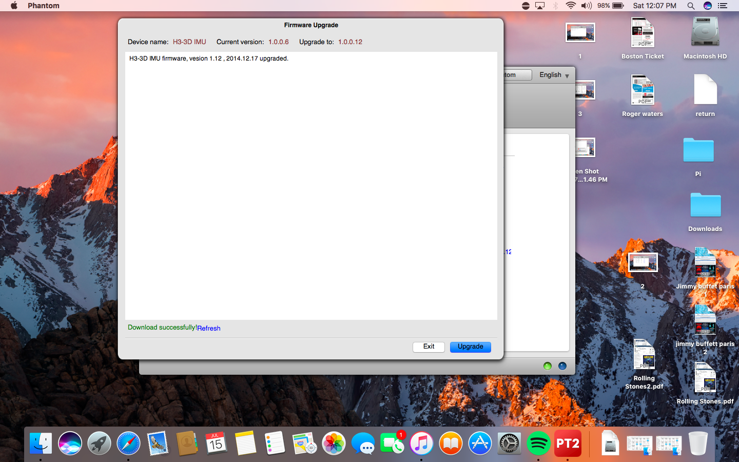

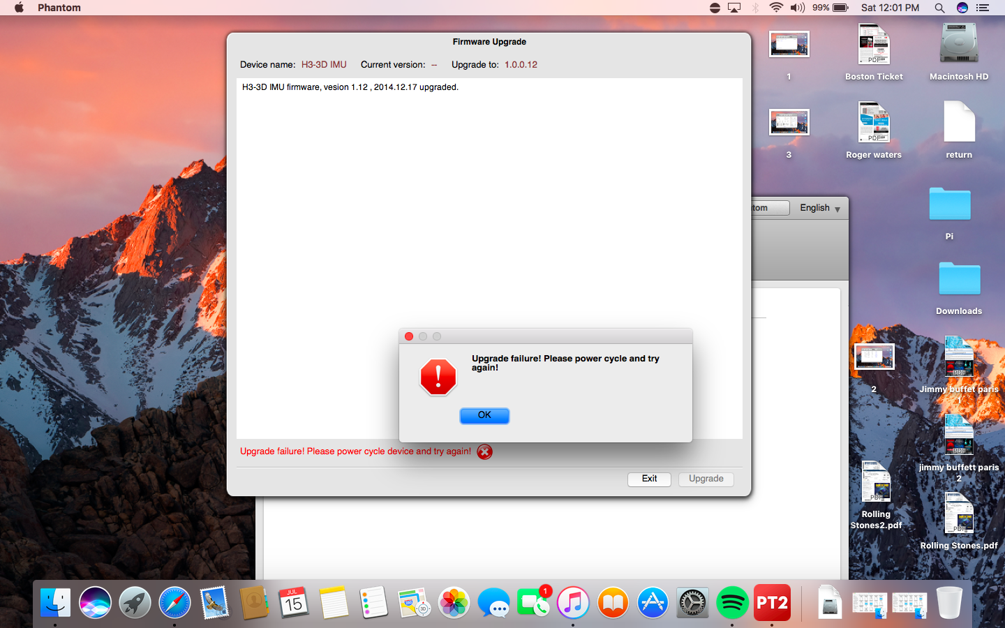

Sorry, yes I did the reset. After doing the reset i still get the same error as before. It will not take the firmware.
The only other thing you might try is to upgrade the P2's software to v3.8 which is the last updated firmware then see if you can update the gimbals software. If you do not what the DC or Japan NFZ then try to update it to v3.6.
