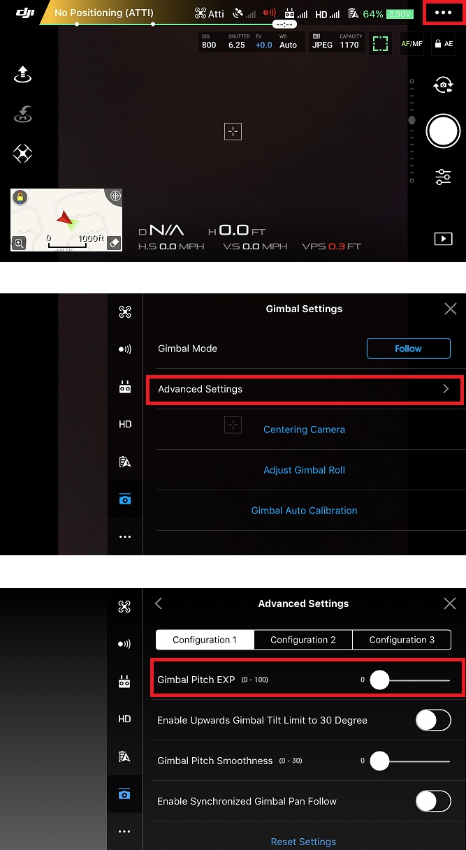

2) Increase the "Gimbal Pitch EXP" setting in the following section of DJI GO:
