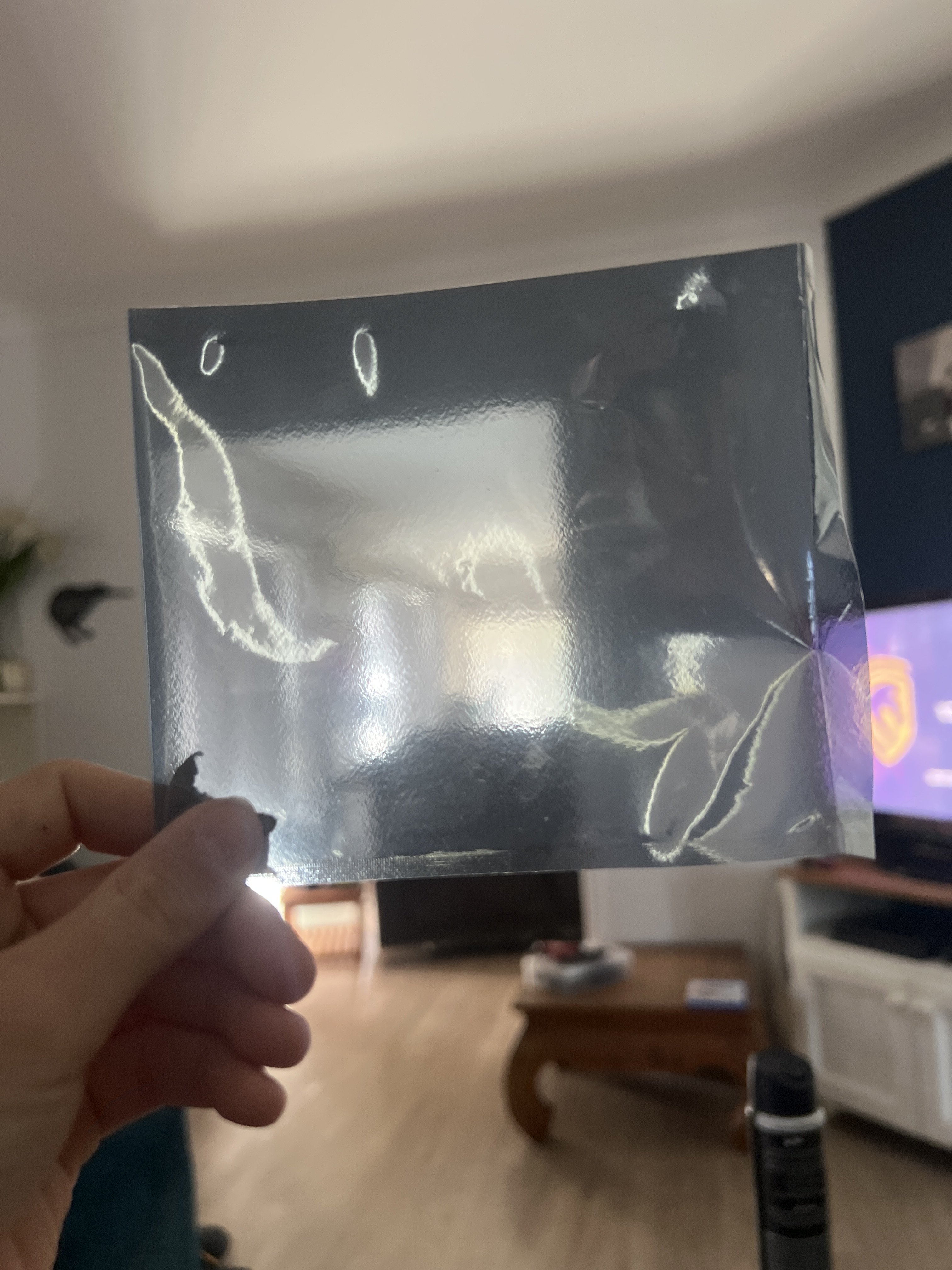

my ph3 stan gimbal is not rotating and i have replaced the flex cable. but before replacing the flex cable the gimbal was working but twitching and would not stay still and the camera wasn't working. and gimbal status is saying gimbal gyroscope error is there a fix please help thanks:) and i dont have money to spend so if i dont need to spend that would be great

First question........was the replacement flex cable a Genuine OEM Part #85 flex cable? It should have come packaged in an official DJI smoke colored plastic bag/package.
If not, the majority of other flex cables by other knockoff manufacturers rarely work correctly.....and some do not work at all.

OEM is 'Original Equipment Manufacture' part , manufactured by DJI. There are other flex cable manufacturers out there that copycat the parts and sell them at reduced prices.....most do not work correctly.

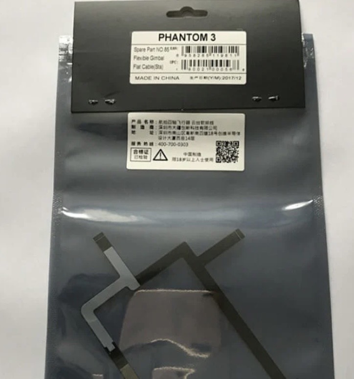

Besides the Smoke Colored Plastic
Is there any other key information?

The DJI Phantom 3 Standard Part #85 is the Flexible Gimbal Flat Cable (also known as a gimbal ribbon cable or yaw cable), designed for the 3 Standard model. It enables the gimbal's movement and is a commonly replaced, tear-resistant polyimide (PI) part.
Key Details About Part #85:
  • Purpose: Replaces the flat flex cable that connects the gimbal to the mainboard to fix gimbal control issues.
  • Compatibility: Specifically designed for the DJI Phantom 3 Standard.
  • Material: High-quality Polyimide (PI) with gold finger contacts.
  • Installation: Requires delicate handling; often sold as a "DIY" part, but requires technical skill to replace.
Reactions: RodPad
Packaging and label... part #85..
