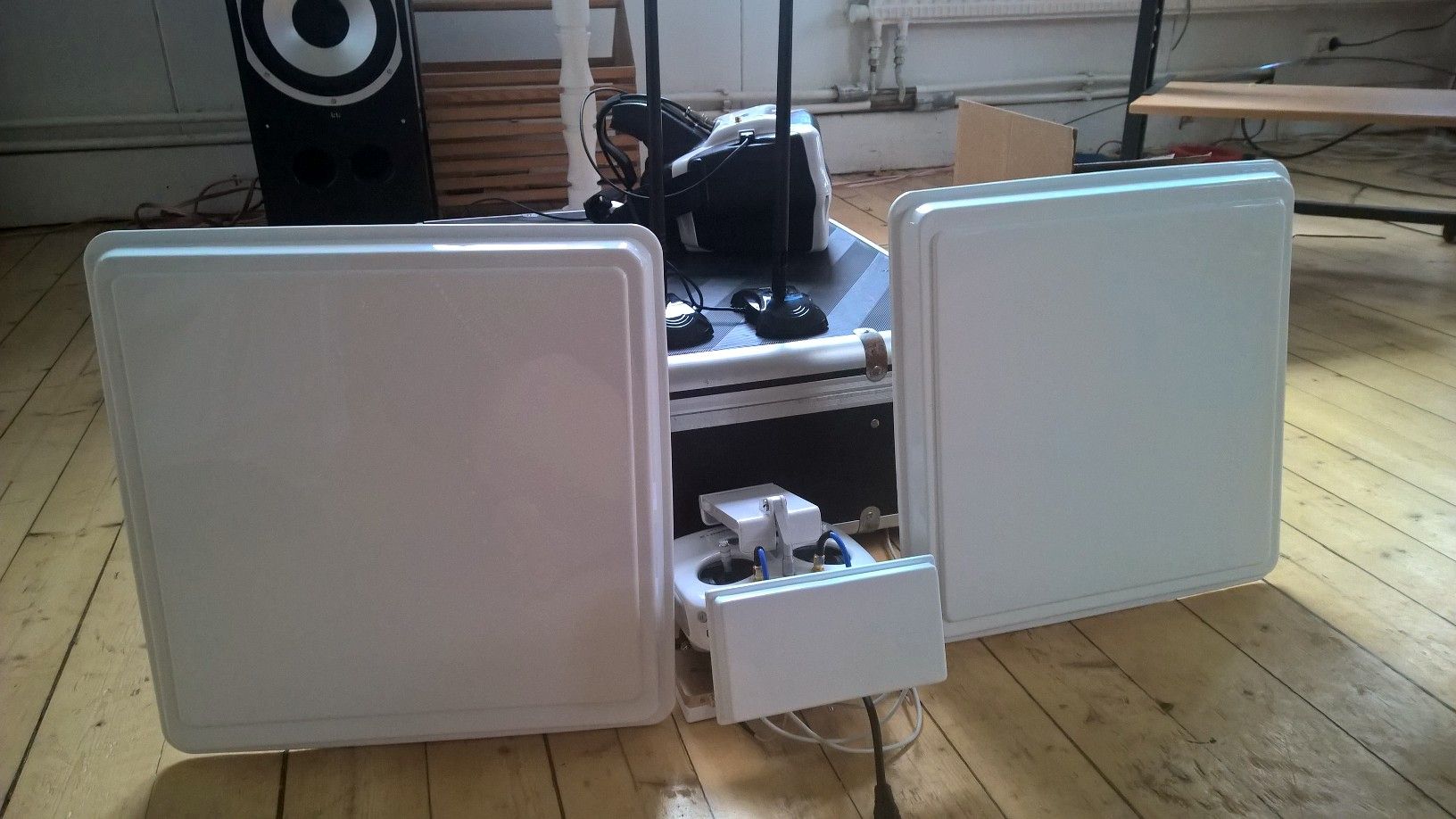

Now I got a step further!
I tested following:
SH golden 3W amps newar to RC and long cable to roof antennas (15m): Same result as described earlier: LEft one white, right one stable blue. This test was only to see if problem is still there.
Next setup: SH 3W amps close to RC and SH silver amps 4W close to antenna. in-between same 15m cable. Result: Now right SH golden 3W is stable blue and finally the left one kicked in with wild fast blinking activity! -In other words it works!
However, the HD channel indicator on the DJI Go app is disaplying high level on almost all channels but red.- Sometimes lower level and green. Fluctuating a lot. I also noticed that when I was within 100m of the antennas that slight distortions occured. Once I went more far away it was clear. It seems I distorted either the bird side gear or the RC HD input. I went 3km to check and both signals were always on full level. This is a good result.
Next time I will test only the 4W SH silver on the roof. In total there is 6 combinations possible to test.
Yea.- I wired a 12V cable up to the roof and need to build 2 little weather proof boxes for the amps.
Currently I just hide them under a rubber sheet...
Soon the parabolic magnet foot antennas will arrive. There is some more tests ahead!...
