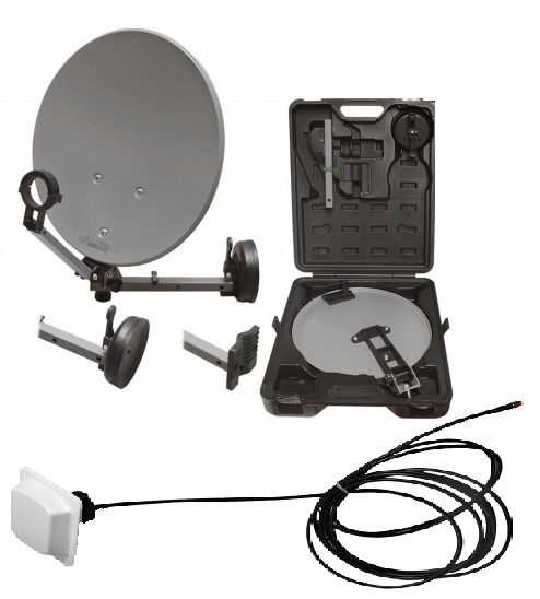

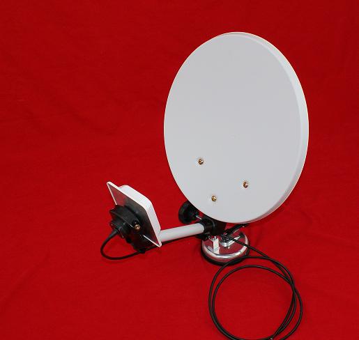

The next step is to test these parabolic antennas that are made for camping actually. (see attached picture). That gonna be fun to see result! :)

The next step is to test these parabolic antennas that are made for camping actually. (see attached picture). That gonna be fun to see result! :)View attachment 57785 View attachment 57786

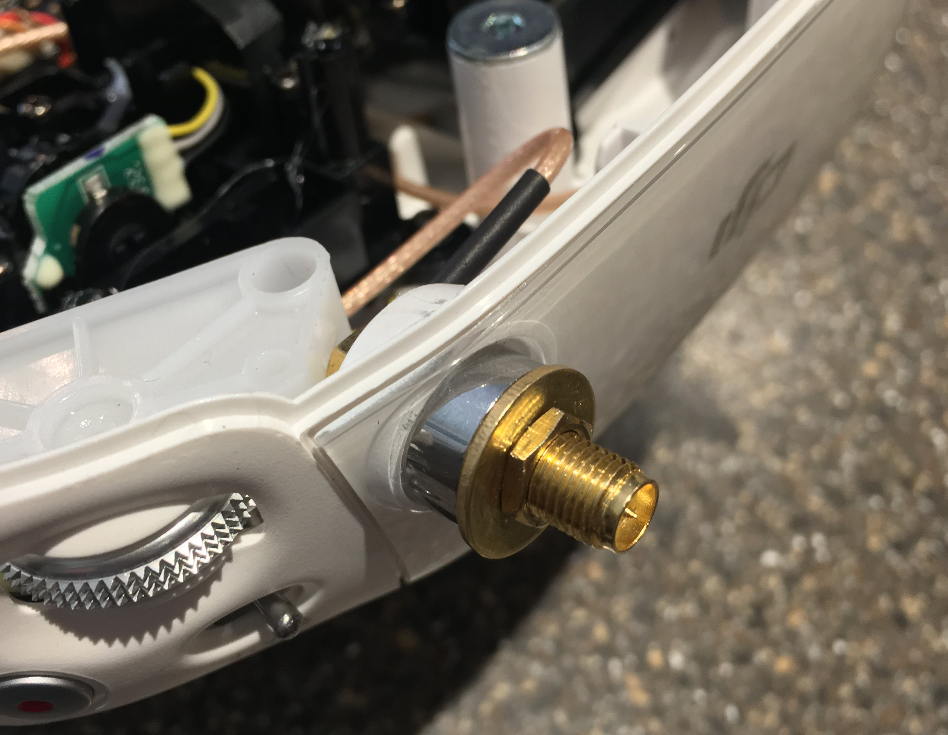

The connection of the wire to the connector is very fragile, so you need to be careful when installing them.
To provide a secure fit so they don't twist and damage the internal connection when screwing the antenna cables on and off, I added a larger washer so the nut seats evenly on the "chrome" ring.
This was after replacing the first set of cables which I damaged with the twisting. They don't have to be broken off to have a damaged wire. They still worked for close flights, but distance was limited regardless of which antenna was used.

Yagi.pl they got loads of antennas. Also parabolic and other stuff.
The parabolic with magnet foot is called Have camping 40 Hv.

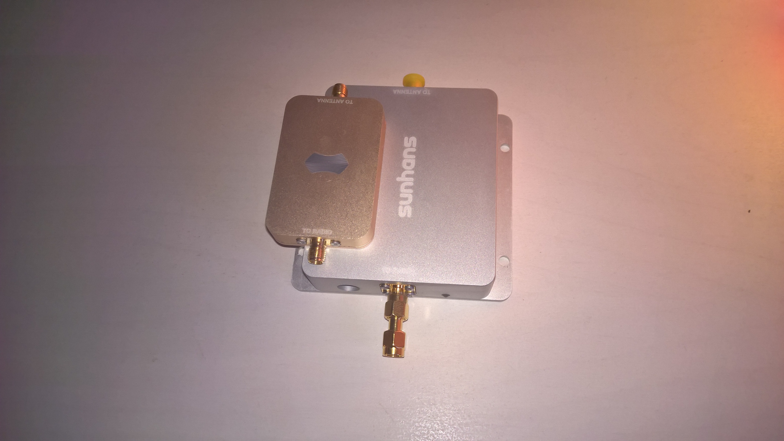

WP_20160623_22_33_01_Pro.jpg ..in the meantime the 4W Sunhans amps arrived so I got a pair of gold 3W and a pair of 4W. (on Picture) Anybody knows a good till to test/measure Wifi signal strength? I'm afraid of frying the RC, the P4 or the second amps...
