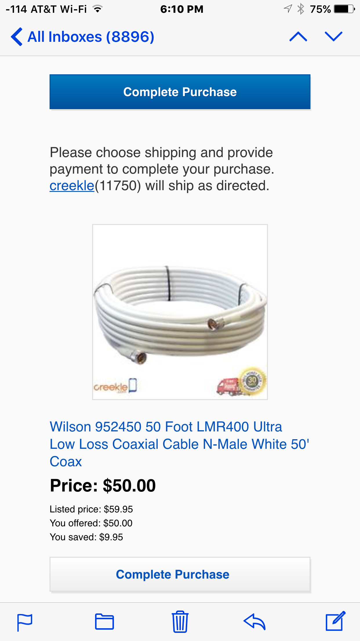

This guy accepted my offer for $1 a foot, actually better, free shipping @ that price is about as good as it gets. Lmr has a loss of about 6.8dB over 100', so I'm at 3.4dB loss, if I can make it 40' that's like what 2.72dB loss. It may not be worth it to cut it and do one of these badass connections myself, I've looked into it, I'm sure I can do it with the tool for $29 (Amazon) but at least 50' I won't be short. I have a 25' sitting here of TM, this is Wilson but from what I've found, same specs, same quality, it's made here prolly off same manufacturing plant. Only difference is its white, they have blk too.

50ft is completely fine and remember I have another 10ft of lmr 240 from my remote and can go farther than the battery can get out and back. I was going to do the battery mod but now my p4 motor mounts have both cracked on the back. I've never crashed or had a hard landing so a battery mod is **** if u ask me because it's just a matter of time before they crack and warranty is voided.
