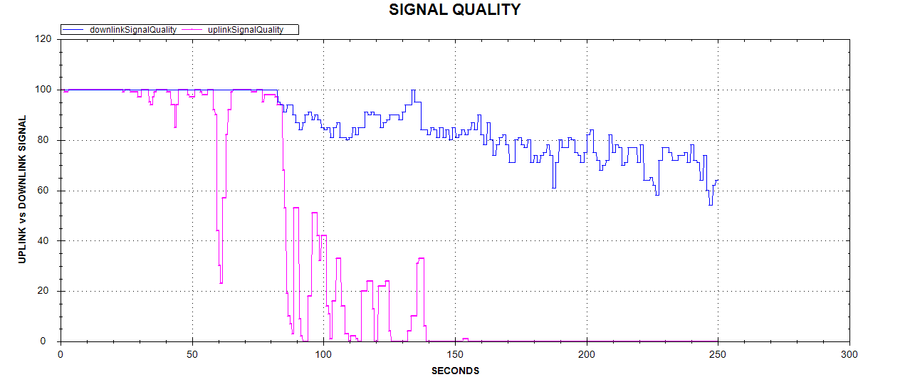

It really doesn't matter what mode you were in at this point. Your RC signal was so bad that you never stood a chance. Here is another plot that shows the signal level, vs the flight modes. You can easily see where RTH was activated and where it was cancelled. Your signal was between 0-20% the entire time after you canceled RTH. I think it was just bad luck that you actually were able to cancel the RTH at all. As was said before, had you allowed RTH to continue with that terrible signal you would have been fine.

This was not an RTH failure. It was simply the fact that the OP cancelled the RTH that was already in progress as it was designed to do. And due to the bad uplink signal ( Which is why RTH was initiated in the first place), he regained signal just long enough to do the RTH cancel, then completely lost all uplink control which resulted in the drift away.
