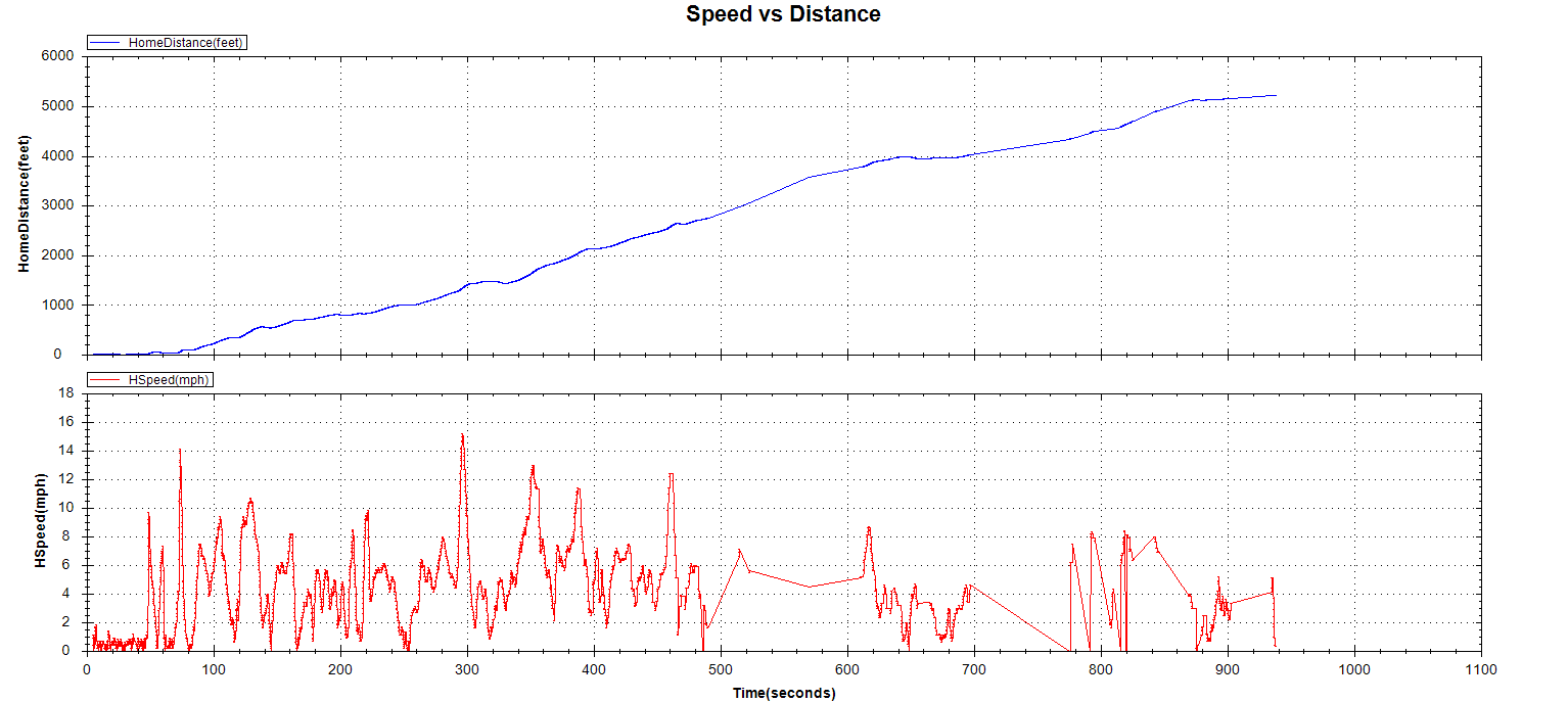

Here is the flight so everyone can enlighten me as to what I have done incorrect (I am never wrong of course). ;)
DJI Flight Log Viewer - PhantomHelp.com

Glad you found it, it must be in good shape, any kind of storm like that must have some winds.
Looks like the wind was taking it away from you, you have some 8 mph speeds like 2m 40s, but your distance was increasing. The return home speed I think is like 8 mph, but it was being pushed away at 8 mph. That would be maybe 16 mph wind?
Your RTH elevation would have increased the wind speed. If you took over the controls and did full power better chance of getting closer instead of drifting away. The Phantom will fly about 30 mph, that would have made a 15 mph return instead of a negative 8 mph.
I learned some time ago, go up your elevation, flip it to Atti and watch your drift speed and direction for a second or two.
Looks like a relatively simple analysis to me. But, I would say the wind was much greater than that. More like 20-25 and gusting at times the way the aircraft was struggling and being pushed away.
Reactions: JoBe and RodPad
So the HSpeed is Negative values?
The larger the numbers the faster or slower it was being blown away?
Your graft 300 seconds (15 mph).
300 seconds / 60 = 5 mins.
5 mins on flight log (9.5 mph)
What I'm I missing? ;)
Rod
What I'm I missing?
I did not graph the pitch and roll values....They were all over the place. The aircraft was really struggling to maintain speed. Wind speeds are not linear. If you have flown in any wind at all, you will note that ~20mph winds are too strong, depending on your altitude. There are around 3 disconnects in the graph, thus you cannot include those in wind calc.
Around 1:20 we see the drone is holding position at 37m altitude
At 1:53.6 and 103 m distance, 37m altitude, you initiated RTH.
As the drone climbs to 70m we see it can't maintain position and is being blown off course at 7-10 metres/sec
That suggests a strong wind as the Phantom has no trouble holding position in a 10 m/s wind.
When RTH starts flying back it's making slow progress of about 0-3 m/s.
However it's not always in the right direction.
The wind is gusty and the drone is alternately gaining and losing distance.
The wind increases and at 2:30 the drone is going backwards at 6 m/s.
At 2:41 you begin to bring it down to 53 metres and the speed drops to 2-5 m/s but it's still going backwards.
At 3:25 the wind drops briefly and the drone actually gains about two metres toward home before the wind increases again.
But at 3:26 you climb back up to 67 metres again.
The Phantom continues to burn battery in RTH while it's being blown backwards at 0-7 m/s
You take it out of RTH mode a few times but never do anything that helps correct the situation and go back to RTH again.
At 15:34 with the battery level reaching 13%, the Phantom gives up and commences autolanding 1.6 km from home.
What's the lesson here?
1. The wind is always stronger up higher.
Early in the flight we saw how the drift speed increased as the altitude increased.
2. RTH is a slow driver and in calm air it will cruise along at 10 m/s (you can fly at 16 m/s when you do the driving)
Leaving the drone up high where it could not fight the wind was a serous problem
Leaving RTH to do the driving was another.
What you should have done was to get the bird down out of that wind and taken control to fly home at lower altitude.
You should also be aware of the wind strength and direction before launching and after.
If you are going to fly in windy conditions, launch and try flying into the wind (not downwind) and check the drone's performance against the wind.
If the wind slows the drone significantly, you know you will have a problem if you have to fly against it.
3. In a strong wind situation, never fly away downwind. Your return trip is going to be fighting that wind.
4. Setting a high RTH altitude can have negative consequences.
If you don't need a high RTH, don't set a high RTH
