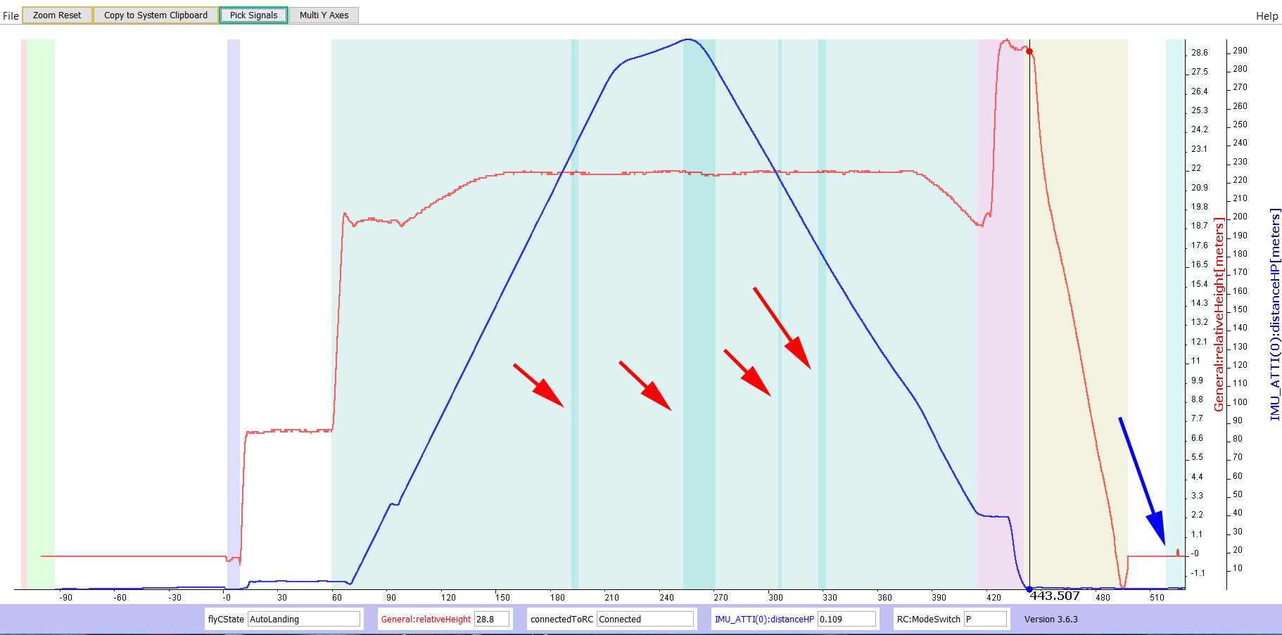

#4
194.318 : 15075 [LED] changed: rc completely lost
This is only one of several during the flight. There is no signal loss during the RTH portion. Only at the very end of the flight and the aircraft was already on the ground at that point. There is really no way to determine a cause for the brief disconnects, other than possibly antenna orientation. You can see the disconnects below and these are also in the event log.
