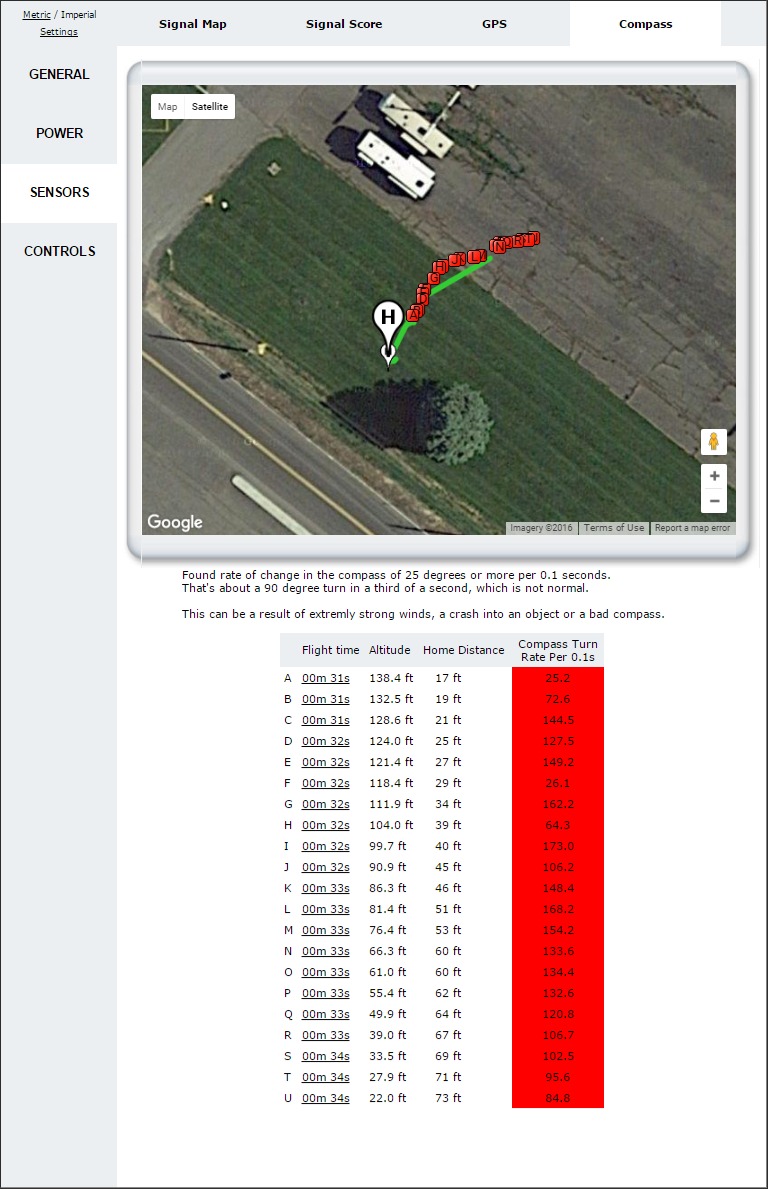

What about your compass data? Looks all outta whack..Shows all lit up in red in HD report:
Did you have any metal objects near your drone when you started it up? Any magnets? New area?
If compass got messed up, maybe that was what caused the crash??
This may sound strange but when HealthyDrones shows compass error its usually, if not always, an indication of a propulsion issue. HD indicates a compass error when there are large changes in the heading. HD assumes this can't actually be happening and that it must be a problem with the compass. If there is a propulsion issue (broke, lost prop, or ESC failure) the AC will spin and HD will show compass error. I've seen several flights where this has happened.
Makes sense, and good to know.. thanks! .. if i found similar compass errors in my log, i would think its a... well.. a compass error..

Happy to report I finally got satisfaction from DJI. I just don't understand why everything is so complicated with them. They sent an email stating the damage assessment was complete and an invoice would be emailed in 24 hrs. Nothing was received after a week, so I posted in their forum. That got their attention and I was contacted by phone, and an invoice was sent. They wanted over $500 for repairs!! I called back to ask why it wasn't covered under warranty. I was told they were unable to retrieve the flight data fro the unit. Well duh! The unit was toast, it went up in flames!
Keep in mind this important tidbit. On the DJI Global Technical Support Form, there is a spot to include your DJI account information , and you're asked if the records are synced.
So I was told they would look into it again. He came back with this:
I have been working closely with the flight log analysis team very closely on this for you. I have been informed that we are not able to retrieve flight log information via sync from the DJI GO App. The aircraft's flight data record was damaged and cannot be read unfortunately.
Ultimately we are unable to retrieve the data and have exhausted all options. We want to provide the best solution for you however we are unable to confirm if the aircraft malfunctioned in any way.
We would like to assist the best we can, I was able to approve a 30% discount for the current invoice amount.
I called back and told him that was not acceptable. We went back and forth with phone calls and emails. I'll spare the details. So it turns out he was not using the email provided on the technical support form. WTF? Why do I even bother filling that thing out? Clearly they aren't reading it. Once they used the email provided, giving them access to my synced records they sent the following email-
We do have the finalized results of the flight log analysis.
It was detected that the aircraft spun in a counter-clockwise direction without any obstructions in the vicinity. The team theorizes that the data shows the possibility of a failed Motor or ESC or the likelihood of a propeller that detached.
Your repair will move forward under warranty coverage. I have ensured that your repair has been moved forward.
Thank you again for working so closely on this issue with me.
If they had just read the technical support form in the first place they could saved everyone a lot of time and aggravation. All the while they kept stating "Customer satisfaction is our top priority." They have the end result correct, but the way they go about achieving that is simply astounding.
