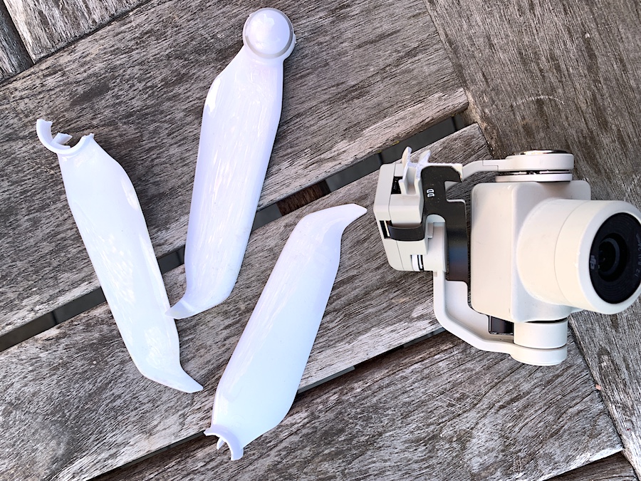

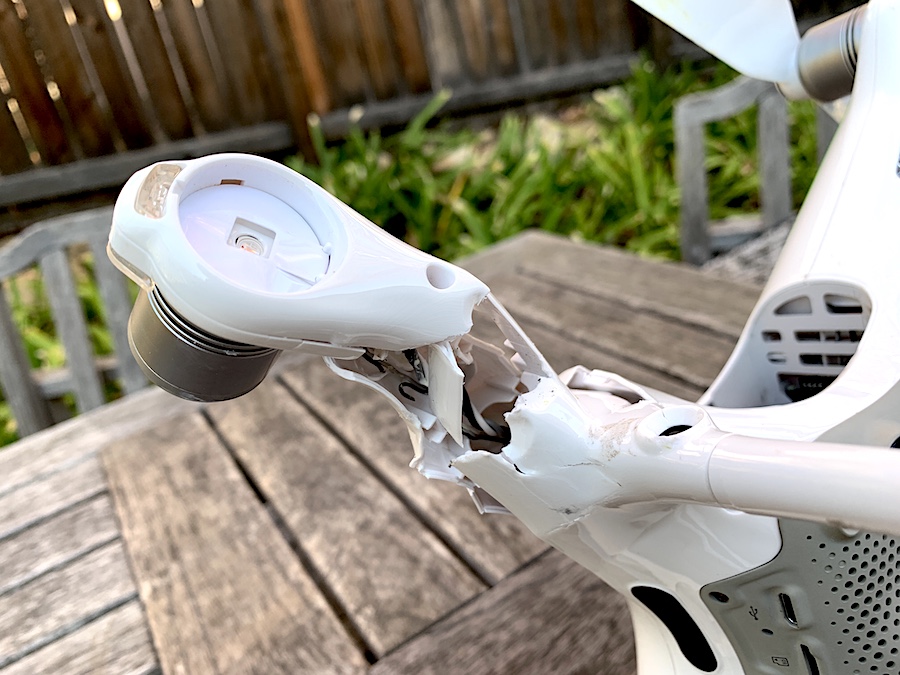

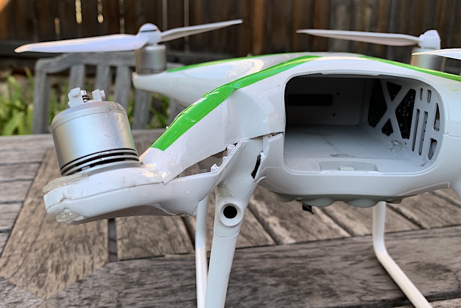

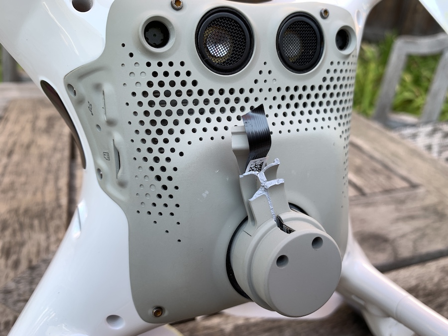

D D S, that sounds great, Here are some pics fora preview. Maybe it's not totaled?

Pics of the damage:
I couldn't find the device .dat file anywhere. I looked at all the entire controller files...I think. Don't think it was a loose prop. I checked them before the flight and two were shattered off on impact, and two were still mounted.

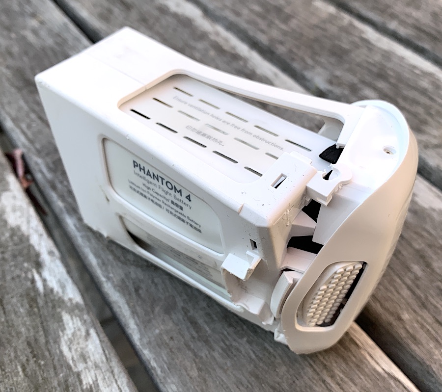

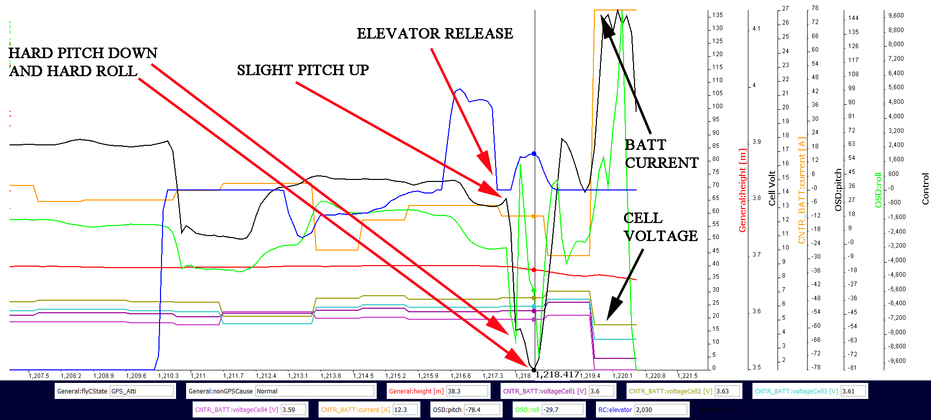

Looking closely at the battery, as seen in the picture above, the damage to it seems way too extreme for the craft to have dropped 100' to concrete and then ejected the battery upon impact. I think the battery went bad (or maybe just one cell of it, from the flight timeline of battery behavior) and was forced out at altitude, dropping to the ground separately from the craft. The impact point on the battery is on an area that would have been contained within the Phantom. The gel cell pack itself is distorted and mis-shapen, still contained in the enlarged and cracked plastic housing. I think the battery was going bad chemically and likely expanded and forced itself out, and that's the moment I abruptly lost all contact with the craft and all logs ended. Miraculously, the battery neither exploded, leaked, or caught fire. It is somewhat possible that the battery was not fully engaged even though I always check that after insertion. Perhaps it just fell out and all the damage to it's shape was from landing hard?

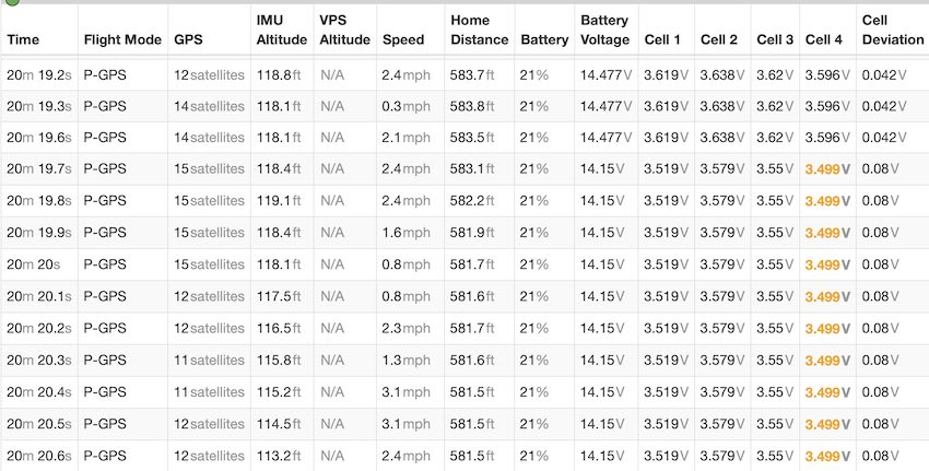

The last flight log entries show one cell of the battery dipping just below 3.5v. (shown in orange type). Could that be an indicator of the event I'm describing?

Pics of the damage:
Oh :oops: ..still under warranty? Its probably torn the esc ribbon inside aswell,the esc on rubber mounts and hard impact takes it past its limit and cables rip...new shell,ribbon set,gimble and cam and it will live again..some reason a wrecked phantom tears at the heart(probably cause it cost so much) ,my new p4 has yet to gain my full trust .and never will,

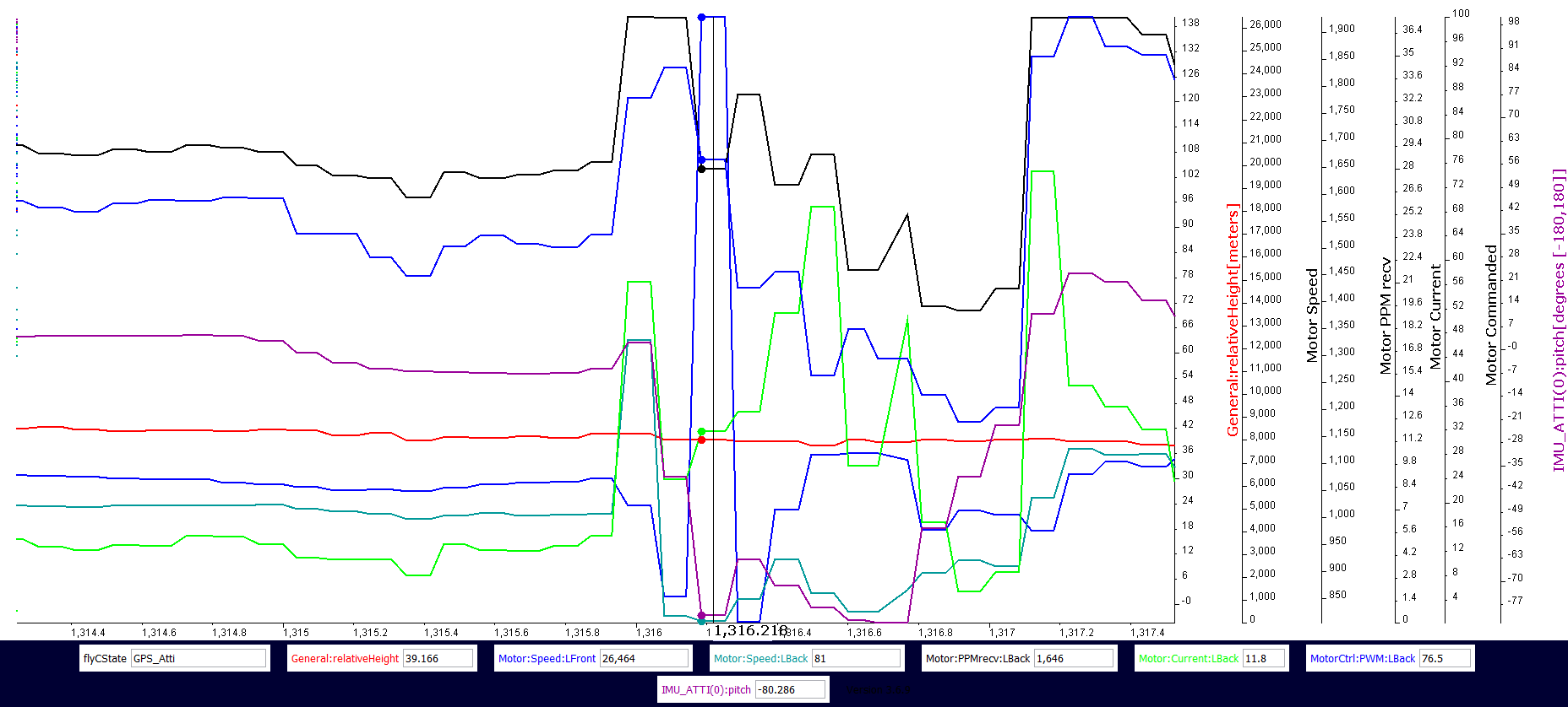

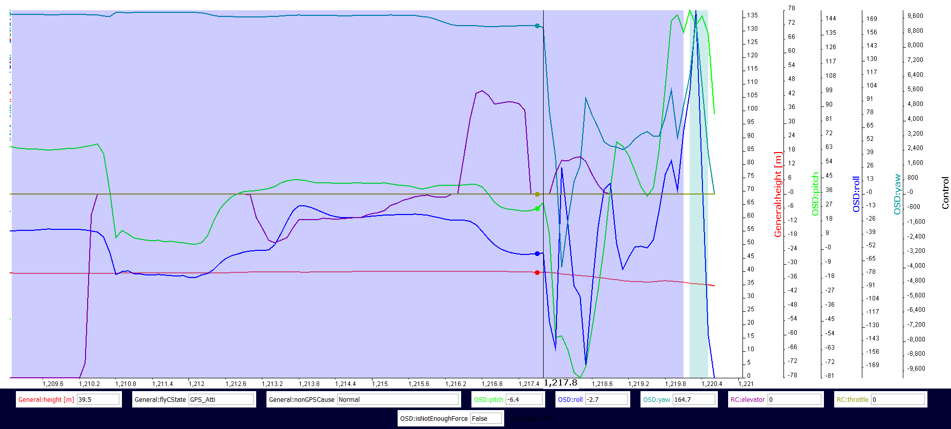

This still looks like a lost prop. I think the left rear. The battery cell drop was due to the high current increase and not related to the incident. As soon as you released the elevator, the aircraft started to pich up to stop, then immediately pitched down and rolled hard. From your photos it looks like the left rear suffered the most damage.
Two props were still attached, and two were destroyed upon impact, one being broke in half on the arm that took the major hit. I believe the other one broke and released as the craft tumbled ofter landing. Pics above. There was no full propellor found that might have separated from the craft. These are my observations at the scene, no conclusions drawn. The battery damage and the moment all signals ceased (at altitude) tell different story. Thanks again for your help, FlyDawg.
These signals are approx 3 seconds prior to disconnect and are not battery related. Once the descent began the battery disconnected. Notice the motor speeds, Left Front attempting to compensate for the left rear. It could be the motor itself or the ESC or a cracked prop hub. But something definately caused the accentuated motor speeds and tilt angles and it wasn't the battery.
