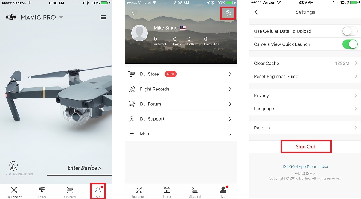

If you're already logged into DJI GO, log out and back in again. You can log out in the following section of DJI GO:
Once logged back in again, your login information will be stored locally on your mobile device and you should be able to fly without restriction (even when disconnected from the Internet). If you find that not to be the case, then uninstall DJI GO and reinstall the current version.
If that does not resolve the issue, then uninstall DJI GO and reinstall it.

After you're logged in, you should not have to login again (unless you log out or reinstall DJI GO).
