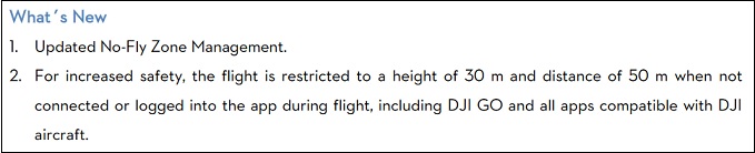

I just received my P3 4K back from Drone Nerds having decided not to have work done. They returned the drone with the firmware updated. (They forgot to remove the sd card as proof). I took off from a street in front of a home I was shooting. While aloft I walked to the back yard when all of a sudden the above-mentioned restrictions appeared. This never happened before the update. Needless to say, Drone Nerds has yet to respond to this unauthorized action.
I am in the dji app, it shows " how to connect". I connected to the drone. where do I go to unlock restrictions?
If you're running the latest firmware, you'll be restricted to a height of 30 meters (98 feet) and a distance of 50 meters (164 feet) when not logged into the DJI GO app. That's mentioned in the Phantom release notes here:
This change is explained in great detail in this video:
If you're already logged into DJI GO, log out and back in again. You can log out in the following section of DJI GO:
Once logged back in again, your login information will be stored locally on your mobile device and you should be able to fly without restriction (even when disconnected from the Internet). If you find that not to be the case, then uninstall DJI GO and reinstall it.
FYI, there is currently a known issue in DJI GO that reapplies these restrictions after switching to a new battery without restarting DJI GO. To work around this issue, you'll need to shut down DJI GO, swap batteries, and start DJI GO again.
