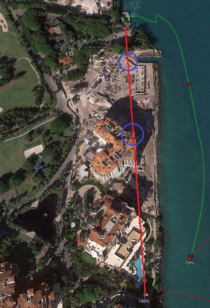

Here's what your flight log tells me:
  • When you took the photo at the end of your flight, you can see your Phantom was well above the palm trees at 96 feet.
  • The connection was lost shortly after taking that final photo.
  • Since the RTH altitude was set to 98 feet, your Phantom ascended from 95 feet to 98 feet and started returning home.
  • At that time, the battery was at 49% and had about 9.2 minutes of flight time remaining. The RTH time was estimated to take 53 seconds. So, your Phantom had plenty of time to make it back to the home point.
  • On the way back, your Phantom had to fly over at least two tall buildings. Those buildings and or the structures on top of the roofs could have been 98+ feet over the takeoff point.
  • I'm guessing your Phantom either crashed into the side of one of the buildings and fell to the ground, crashed onto one of the balconies, or hit one of the structures on top of one of the buildings and crashed on the roof.
Note: It's not uncommon for the altitude reported by your Phantom to be up to 20 feet off.
Note: The red line in the image below shows the path your Phantom would have taken when it returned back to the home point. The blue circles are the locations where I believe it crashed.
