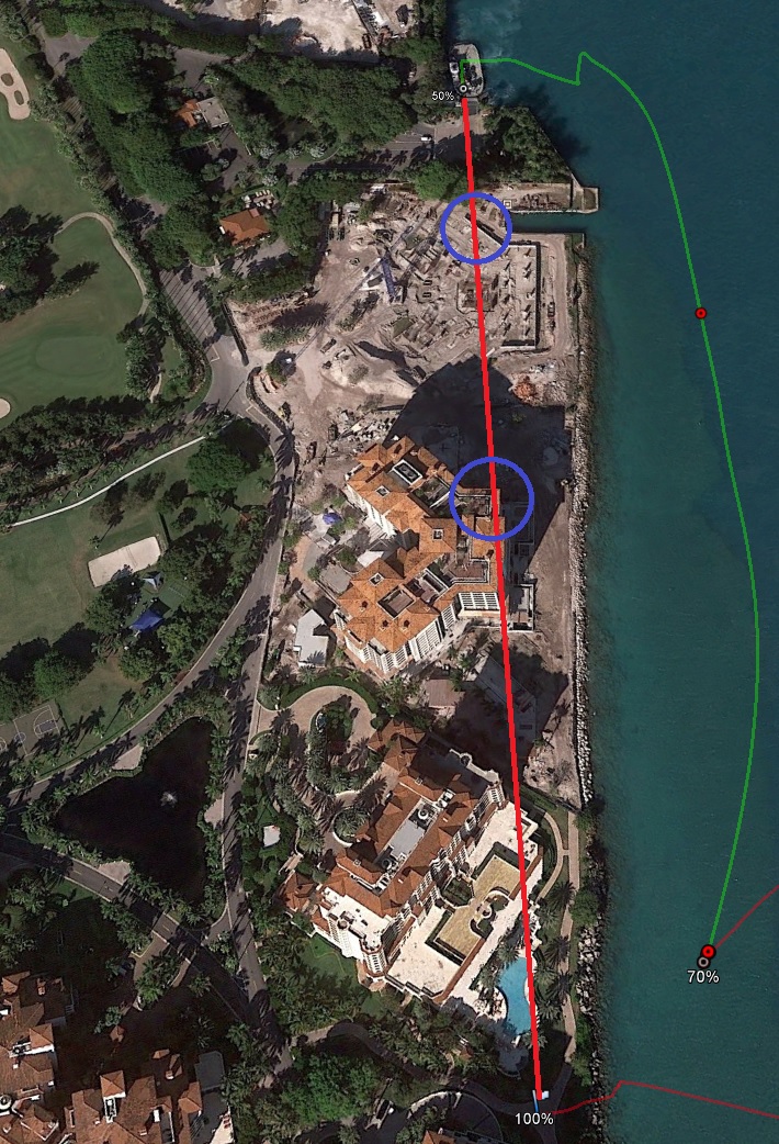

Here's what your flight log tells me:
  • When you took the photo at the end of your flight, you can see your Phantom was well above the palm trees at 96 feet.
  • The connection was lost shortly after taking that final photo.
  • Since the RTH altitude was set to 98 feet, your Phantom ascended from 95 feet to 98 feet and started returning home.
  • At that time, the battery was at 49% and had about 9.2 minutes of flight time remaining. The RTH time was estimated to take 53 seconds. So, your Phantom had plenty of time to make it back to the home point.
  • On the way back, your Phantom had to fly over at least two tall buildings. Those buildings and or the structures on top of the roofs could have been 98+ feet over the takeoff point.
  • I'm guessing your Phantom either crashed into the side of one of the buildings and fell to the ground, crashed onto one of the balconies, or hit one of the structures on top of one of the buildings and crashed on the roof.
Note: It's not uncommon for the altitude reported by your Phantom to be up to 20 feet off.
Note: The red line in the image below shows the path your Phantom would have taken when it returned back to the home point. The blue circles are the locations where I believe it crashed.

I appreciate your detailed response. The first circle is no option since this is an empty construction site. I assume it might have hit the building inbetween. I was hoping it would fly back the same or similar way I flew it (over the water).
Also, if there is absolute NO signal / reception - the drone would still remember where the RTH location was? I'm thinking of the cruise port which might have used jammers or so
It always takes the most direct route back to the home point.
The Phantom has a GPS receiver inside of it. That's how it knows how to find the home point.
First .. the port does not use jammers.
The reason you lost connection was that you flew the Phantom to a position where signal reception was blocked by two tall buildings.
This is what interfered with your connection, just like flying behind a mountain would interfere with your connection.

Your Phantom never lost GPS, you just lost the connection between the controller and the Phantom when you flew behind tall buildings.
Three seconds after control signal was lost your Phantom would have initiated RTH and since the RTH path was through a tall building, that's where the flight ended..

Can I blame DJI for this? How can I suddenly lose complete control, even on it's way 'home' I didn't have any control over it nor did I see anything on my screen and the drone was close by then. the distance from the building to me is close.
What caused you to "suddenly lose complete control" was that you flew behind two 12 storey buildings that blocked your signal.
What caused the crash was the pilot not understanding how signal is blocked by large obstacles, not understanding how RTH works and not setting an appropriate RTH height.
The Phantom performed exactly as it was programmed to and would have returned safely if proper piloting was exercised.
Most definitely not. It looks like one or more of the buildings blocked the signal when you descended too low. Your Phantom likely crashed into one of the buildings before there was a clear line of sight between you and it.
GPS tracker for the future? recommended? what brand/model
I recommend you set the RTH altitude to the proper altitude prior to each flight. 30 meters is the default setting and it was way too low for the area where you were flying. To keep it safe, I'd recommend you set it to at least 50 feet higher than the tallest estimated obstacle.

If the building under construction doesn't work weekends then there's a chance it's sitting at the bottom of the wall... But 98' would also put it into the 10th story and it may have flown through a window and into a wall inside. Either way, if you want to find it, then the construction site is the starting point. If you set your return height to 300' then as it goes up and rises above the buildings, you can regain control before it even starts coming home. Just having it start the return by going up high enough to clear anything between you makes a big difference. Depending on where I am flying I will set it at 400' or whatever I need to clear the mountains between.

If the building is under construction it could have flown inside, seen a wall in front of it, and tried to rise above the obstacle, crashing into the roof. The interesting thing to me is that if you were getting a notification that the motor was obstructed, then it had already crashed, but your controller had a connection. Therefore, the last GPS position obtained should be very close to where it is. By looking at the flight log, you should be able to see that location, or by loading Litchi, the Where's my drone function should give you the coordinates to put into your phone.
