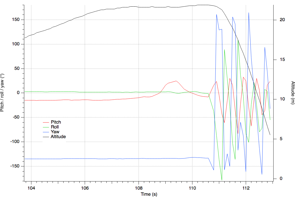

I'd love to be able to see what you see here in this flight graph....please where at the 110 seconds how can you see that the prop came off.......I want to some day be like you and read these and help others here.....Thank you...and besides the prop issue what else can you see in the multi colored lines.

The aircraft pitches up and rolls left, which implies loss of lift rear left. The rear left is a CCW motor, leaving two CW props balancing one CCW prop, which causes the aircraft to enter a CCW spin. The final clue, which requires having seen these events before, is the 2 Hz oscillation that is typical of a lost prop.

It appears that the left rear propeller came off at 110.6 seconds into the flight. It's likely that you had not attached it properly. Did you tighten it or just spin it on?

That's the one. Nice data, but they don't really help. Unwrapping the higher sample-rate attitude data reveals the same as before:
Looking at the motor command data at the end of the flight shows what I expected:
At 110.6 seconds the FC suddenly requests 100% from the rear left due to loss of lift, and at the same time drops the front right motor to counteract the backward pitch and CCW yaw. Without the motor speed data there are two possibilities. One is prop loss, which would have resulted in the rear left motor speeding up, while the other is some kind of motor or ESC failure that led to the motor slowing down or stopping. The former is apparently ruled out, while the latter makes little sense if the aircraft flew fine immediately afterwards.
I can think of no credible explanation for the event.
