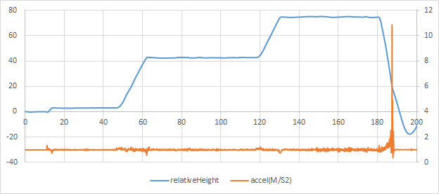

This graph shows relative Height and total acceleration.
The problem started at about time 181 resulting in a steep descent and crash at about time 187.493.

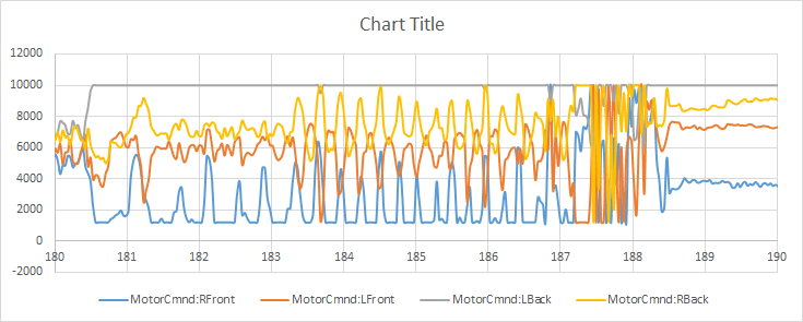

This plot shows the commanded motor speeds for all 4 motors
It shows that the left back commanded went to the max value when the problem started. At the same time the right front commanded went to a lower setting. This indicates that the left back lost propulsion and the right front commanded was reduced to compensate. This behavior is normal when propulsion is lost on one motor.

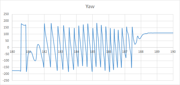

This plot shows that the P3 started to spin when the problem occurred.
This also is normal with loss of propulsion in one motor.
