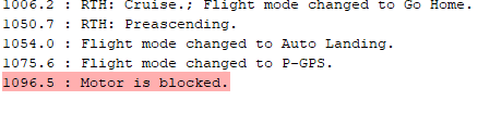

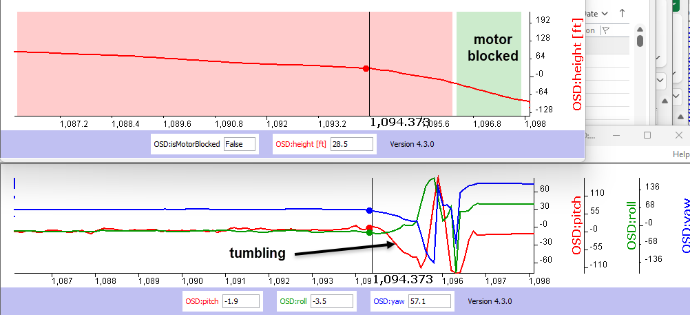

Looks like a problem with the right front motor. At time 1094 secs the P4 began to tumble. Rolling CW, pitching down end over end and yawing CCW. All consistent with right front reduced propulsion. The P4 also began it's uncommanded descent.
Then at time 1096.5 the eventLog shows that a motor was blocked.
The foregoing is a pretty good guess. Additional confidence could be gained by looking at the .DAT log file.
The foregoing is a pretty good guess. Additional confidence could be gained by looking at the .DAT log file.wo

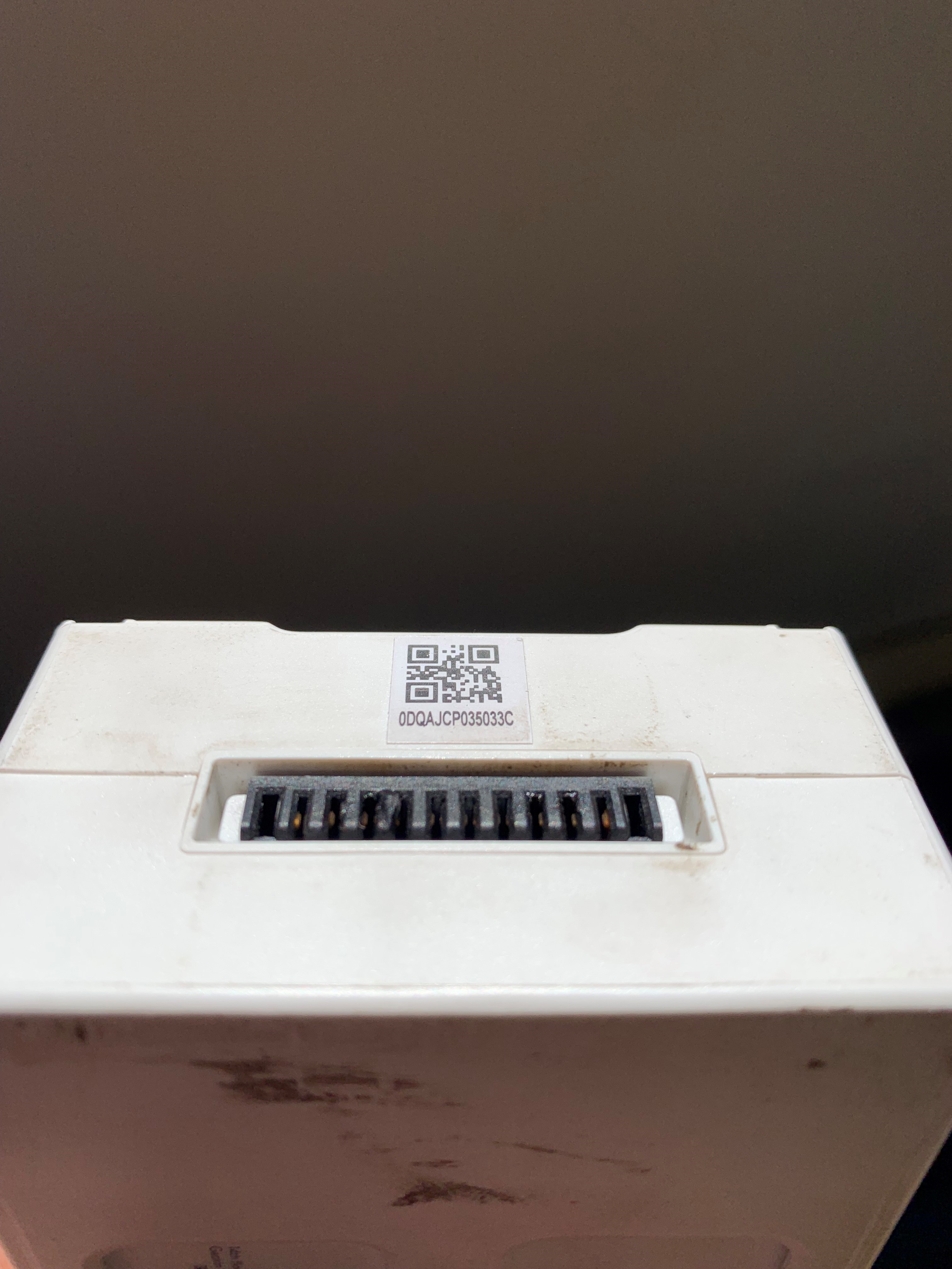

Another thing that I just noticed with the battery (attached photo). The connection seams to have melted. This could also be due to the fact that the gimble ribbon cable was damaged from the crash and in the process of retreving the flight data, the cable was shorting out and smoking. I do think this drone can still fly, but I also think its a total right off, i wouldnt trust it in the sky anymore. Time to upgdage to the the Mavic 3E I guess
Alos, this is the second P4 RTK drone that we have had. The first one was sent back under DJI refresh as we kept getting a "Cannot takeoff. Ensure the aircraft battery is properly connected" warning.

I only did this second flight to confirm that the drones propellers stopped on their own and no controler input was done while it happened. And that was comfirmed.
Thanks,
Reece
That's probably best. I can't really determine the cause. E.g. at the end where motorSpeeds go to 0 the voltage at the motors shows 0.0. That shouldn't happen. Normally, the motor voltages will be close to the battery voltage. I don't know what would cause that...
