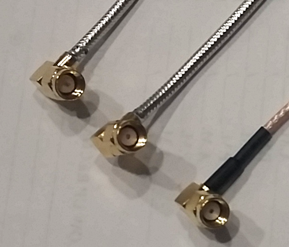

I've emailed that guy in Florida 3 times in the last week, I've got no response. I think he's got what we want, but based on his website it appears he doesn't want to sell a DIY cable kit. He appears to be leveraging to get the conversion work at $250/job, something that takes about 30min to do and $10 worth of cables. That's not going to fly with most of us (pun intended). I could get these cables made with a Chinese cable maker if I had high res quality photos of the connectors needed on each end. Those guys in China have no MOQ requirement, and they make pretty good cables I found out. I've bought a few custom cables from China for the external FPVLR cable setup I needed for my Q500 with 2W amps, using 90 degree SMA connectors, and the quality looks excellent (see below). All it's going to take is someone here in the US to realize there's an opportunity lurking, and those cables can be made up very easily, no problem.

Freddies cable kit (when available) should something everyone should want when installing a DBS Mod or FPVLR kit. This kit would alleviate the need to drill holes in your controller shell, and make the installation look more like an OEM setup. Of course, Freddie is a competitor since he sells antennas too, so you won't find DBS or FPVLR endorsing his "original antenna hole" cable kit.
