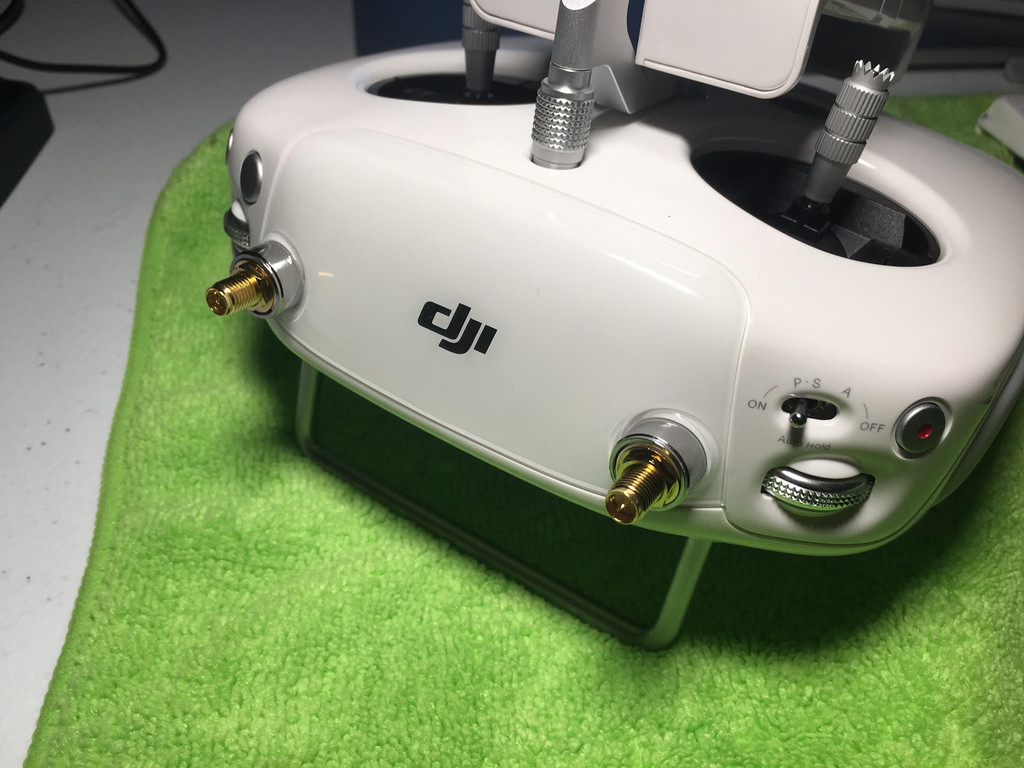

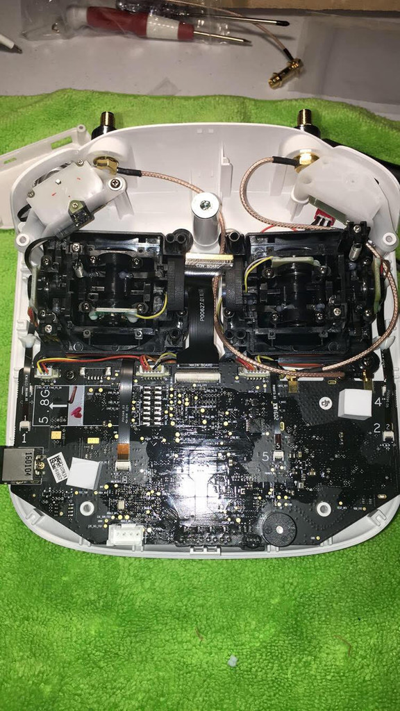

Here's what I did in sparing the controller in drilling holes. I used the internal cable that came with the DBS panel antenna as you can see in the picture and I put a 5 minutes epoxy then install the washer and nut after epoxy cured. I've used the DBS unboosted until I decided to boost it just recently. I bought the booster kit from Jake of MaxxUAV and here's the finished setup when I'm done with it.
