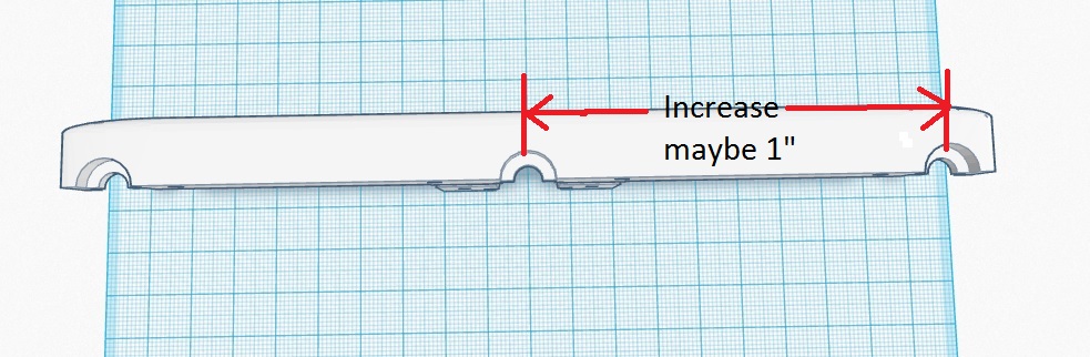

Hello Pilots!
TL;DR: If someone has a 3D design for an antenna mount for P3S, please share as I'm sure it's much better than mine. Otherwise rate my antenna mount please.

Obviously 3D printing my own is the most attractive from a value for money standpoint, and the most fun. I have searched high and low for a model of the mount I can print to no avail, so I butchered together my own.
I would greatly appreciate feedback on the design so I can get this printed properly once, instead of getting useless plastic back. I will modify it as necessary, and if anyone wants I can share the design file if/once its viable and useful. Or better yet, if anyone has a design for one already I would appreciate it.

I'd like to see one that was slightly wider, so that all 3 Alfas could be ran straight up and down. Or offer both types so that people can choose.View attachment 78591
Yeah, I was a little concerned about that distance.
I left it as is (9cm) because the m25 is 9cm wide and the m04 is 6.6cm wide (according to Alfa website). 4.5+3.3= 8.8cm. I will increase it though.
Other than that, does it appear a viable design?
Looks good to me.
Appreciate your input.
This is why it's worth having a second pair of eyes. On closer inspection, that distance was 8.2cm, not the 9 I intended. Whoops. It's 9.5cm now. Fingers crossed I didn't fudge any other measurements lol. I'll get this printed and uploaded to thingiverse tomorrow in case it will be of use to anyone.
