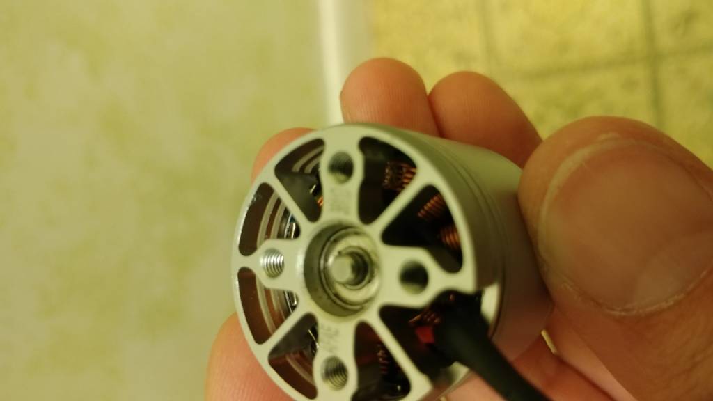

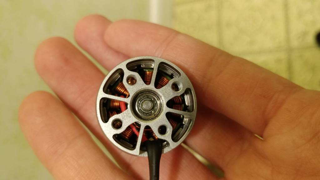

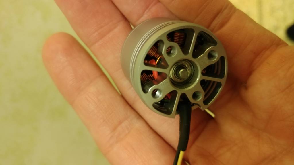

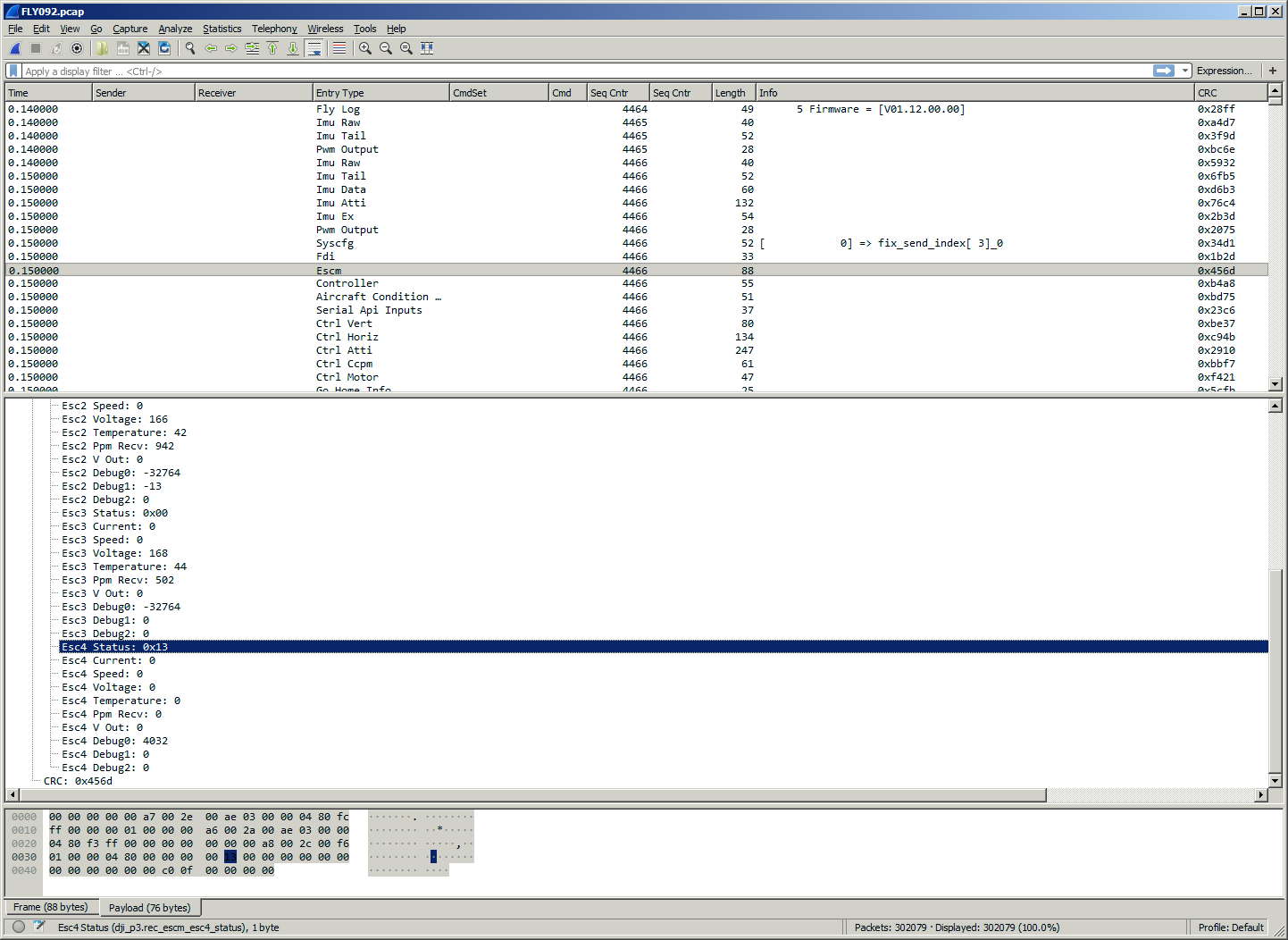

I just got my P3P used the previous owner had obviously come down hard and busted the gimbal, bent one landing gear and buckled an arm slightly. I installed the props when I received it and they weren't far off in alignment so I took it for a flight. It took off and flew without the camera fairly well so I set it aside until I managed to get a hold of a replacement camera. I them installed the replacement camera, did a firmware update the first time appeared to have failed as it just continued to beep well over an hour. I reset the P3P and tried again after downloading the update again and this time it seemed to have been completed successfully. Afterwards I attempted t start the bird up to ensure everything was satisfactory and I repeatedly get an ESC error. I've been poking around for 3 hours now trying to figure out how to read or find out what these log files are telling me but I can't seem to figure it out. So I'll see if I can manage to attach the log and see what you guys can tell me. I've been flying a P2V for a bit wanted to do an upgrade. I also can't seem to get the controller to do an update to the firmware but I think it's on the current software? The only thing I did other than that was attempt to remove the "quick release" prop guard mounts from one arm but when I put the screws back in I felt it might be too long without the mount and the motor seemed to have some resistance when I turned it by hand so I put everything back where it was. I don't remember which motor it was that I had messed with though. Well any advice or help would be greatly appreciated. I've attached the log file in ZIP form from my last attempt at starting the bird.
