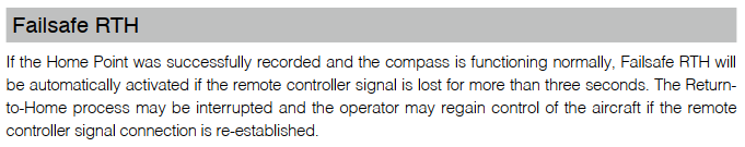

Powering down the remote controller will initiate Failsafe RTH (see below). Using the default settings in DJI GO, the Phantom will fly home and land. If the Phantom is not able to use the GPS data for some reason (e.g. poor GPS signal or compass failure), the Phantom will auto land at its current location instead of attempting to return home.
