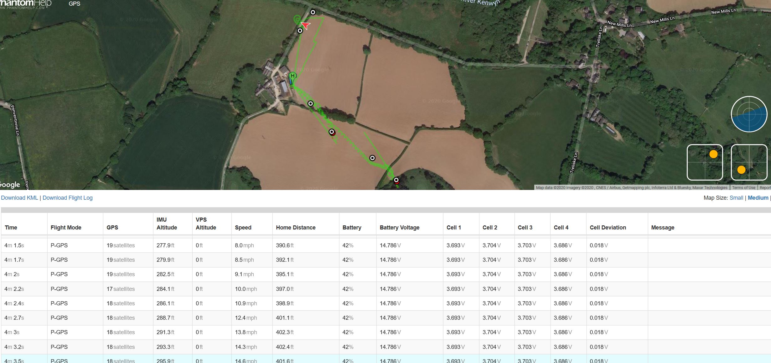

I was using Litchi for a panoramic shot. When completed I pressed the return to home on the controller and totally lost control of the aircraft. You can see the corkscrewing on the attached photo.
As far as I can remember, I couldn't come out of return to home. As reported on a previous post I may have panicked and pressed more than once which I believe toggles between RTH and cancelling. At one point the controller issued an overheating warning. As you can see this corskcrewing happened again, couldn't reduce height manually. Interestingly on the first corkscrew using the 'phantom help' site - see below, the joystick controllers seem to be pushed across and up which I know they weren't. The previously day I had a flyaway which luckily landed softly in a hedge where a similar joystick lock could be seen on flight log. I have been recalibrating before each site. I have been also having to recalibrate the joysticks often recently due to beeping. Could this link to the errors with the joysticks on the flight log.
The corkscrewing was because your controller was giving inputs on all 4 axes for almost all of the flight.
You need to that controller fixed or replace it.

Thanks for replying, yes I had never heard of joystick mode which appears to be the opposite of 'no joystick' mode i.e. the user has no input. Excuse my basic knowledge a relative beginner and only just exploring flight logs.
I had read elsewhere of switching to sports mode and back, which I guess atti would do the same. It is something to do with litchi and panos apparently.
I will look into the cost of replacing or fixing the controller.
