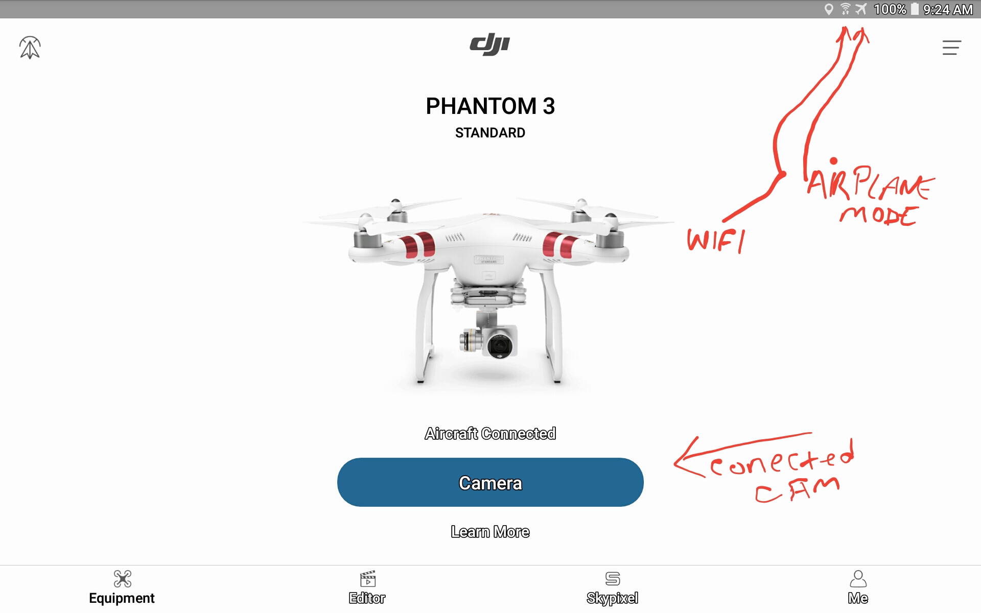

Here's mine ,conect sweet with airplane mode on,,,,,rc and AC make there own wifi,your device is just to receive,,,not saying your device no good but do you have another to eliminate the device causing this
