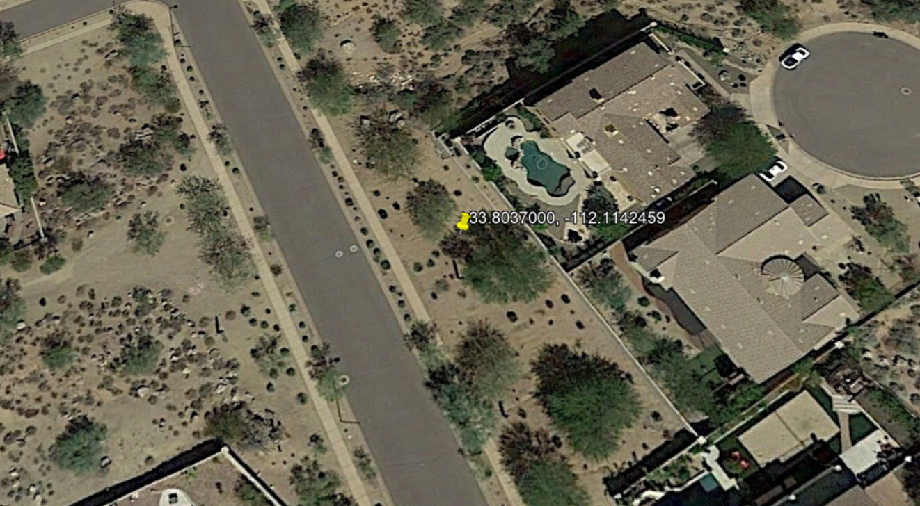

@CharlieU .....In response to @LarBear360 Is this the location you were flying???View attachment 96492

I'm finding that out. I returned to the crash site which is only a block from my house. I looked at the total area above, below and around trying to determine why DJI said pilot error. I then looked over the flight data again. The possibility I see is the quad was under the tree with the yellow flowers in the picture below, . I could see on the video feed rising terrain. At 5.5 mph I most likely thought I could climb to avoid terrain and flew up into the small bottom branches of the tree. The quad then fell 11 or 12 feet to the ground upside down. I say upside-down because all the carbon reinforced props were broken, prop caps were off, the gimbal-camera was detached and the battery ejected. The broken plaster mark on the wall was probably old age and lack of attention.

By the way, if you enter those coordinates into Google Earth there are no walls there, only trees.
If you zoom in, you will see the wall that runs along the property line. :)

No warnings I was flying about 5 miles per hour looking for a small drone that got caught in the wind. I would have been with in obstacle avoidance distance from the wall if I continued straight ahead about 3 ft farther without any control input. I thought I could climb up over the wall. Unfortunately I was under a tree at the time. 3 ft farther I would have been past the tree and been able to climb okay. The replacement Phantom 4 Pro is supposed to arrive on Monday. According to the serial number it's new and not refurbished. There is no R in the serial number.
