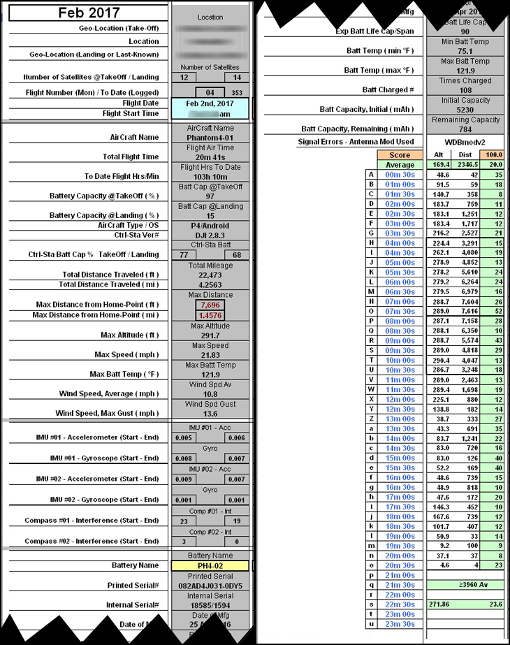

Need help. DJI won't cover flyaway crash. Ignores flight data.
DJI Phantom 3 Flyaway crash:
Once the phantom has compass malfunction on the air, the firmware logic calculates the wrong result. Even just for hovering (with no input command), it will drive it to wrong dirrection. That's what causing "toilet bowl effect".
The dangerous thing is, the phantom didn't even realize that its compass is malfunctioning, so it won't show any error message and keep calculating wrong values of trajectory over and over.
How to avoid this is make sure your actual heading is match with the heading on the map. Maybe only your self who can confirm the situation on that location, between the onboard video vs the flightlog video on your 1'st post. Make sure it is perfectly match the orientation (N,E,S,W) not only the rotation movement on the map.
And this youtube video i post here is one example, that phantom didnot realize its compass malfunction, so it won't show any error message. The worst thing is the pilot also didnot aware about it.
I believe this is exactly match your case, i can see it from the same "toilet bowl" trajectory.

I would say the odds are a bad compass calibration on the ground near metal interference.
then when it became airborne and no longer influence by that metal the compass became disoriented to true heading.
thus ---toilet bowl
as it keeps going in wrong direction and then gps tries to correct the heading over and over again!

The arrow of the drone while flying (pointing north west) is not the same of the angle of the video recorded. Does it mean anything?
When my drone is pointing North, my camera is pointing North also. The arrow of the drone while flying will be pointing North. Your video shows that your camera is not pointing at where the drone arrow is.

The first thing that catches my eye is all that metal in the bridge. The initial flyaway was probably caused by interference with the compass caused by the bridge. Just my impression. I personally would not have flown my bird there. Especially underneath it like that.

This is the 4th such crash I have seen in forums. Things they all had in common: River and bridges. In some of these cases, pilots tried to fly under the bridges. Bottom line.... be careful around big bridges and bodies of water. It appears that both conditions are needed. I have seen many cases where Phantoms have flown over water and as long as they stayed high enough...no problem. I have flown over lakes and got some very nice pics and vid.

I'm not sure the heading direction on the app is accurate though. When I turned the map on my app The Heading also turned with my map orientation. See these screenshots Imgur: The most awesome images on the Internet
But if the compass was acting incorrectly, why would the aircraft accelerate in the way that it did? Why didn't it stop moving when I pressed the RTH function? Why didn't it ascend to the preset height? And why did it descend into the water when it was a 165 feet from the home point? The AC clearly knew it wasn't over the home point. I'm not trying to call you out here, I'm just genuinely curious. I really appreciate your feedback.
And what really makes me suspicious, is that DJI continually refuses to acknowledge the events before the RTH function. Even when I call them out on it. Over the phone or through the complaint process they just act like I didn't even mention the events prior to the RTH. Makes me think they know it was a malfunction... but maybe I'm reading too much into it

Hey Everyone!
I'm sorry if this isn't the correct area for this post. If it isn't just let me know. This post will be kind of long....
So I've been wanting to get into this hobby for ages now. I finally saved enough and was persuaded by my wife enough to finally buy a drone (P4). I flew it three times before it flew away on it's own and crashed into a river....
Here is the flight data:
Here's the video of the crash:
The following is the complaint I eventually sent in to the BBB. It describes the incident in detail:
So that's the nuts and bolts of what happened. I originally got the following from DJI: Imgur: The most awesome images on the Internet
After my BBB complaint I got the following response:
Again, they ignored everything that happened before the RTH....
So here I am... What do I do now?
Thanks!!
I also filed a complaint with BBB but DJI just denies it
According to his flight log, the crash occurred AFTER op switched back to P mode. In other words, the crash occurred when op was in control. From his video, he was flying backwards in circular motion and near the ground. At his flying height, I am not surprised that a low branch or tall grass might be the cause for his crash.
One thing I found odd is when he hit the rth button, his p4 did not raise high to 20m. I wonder what was his rth height setting
