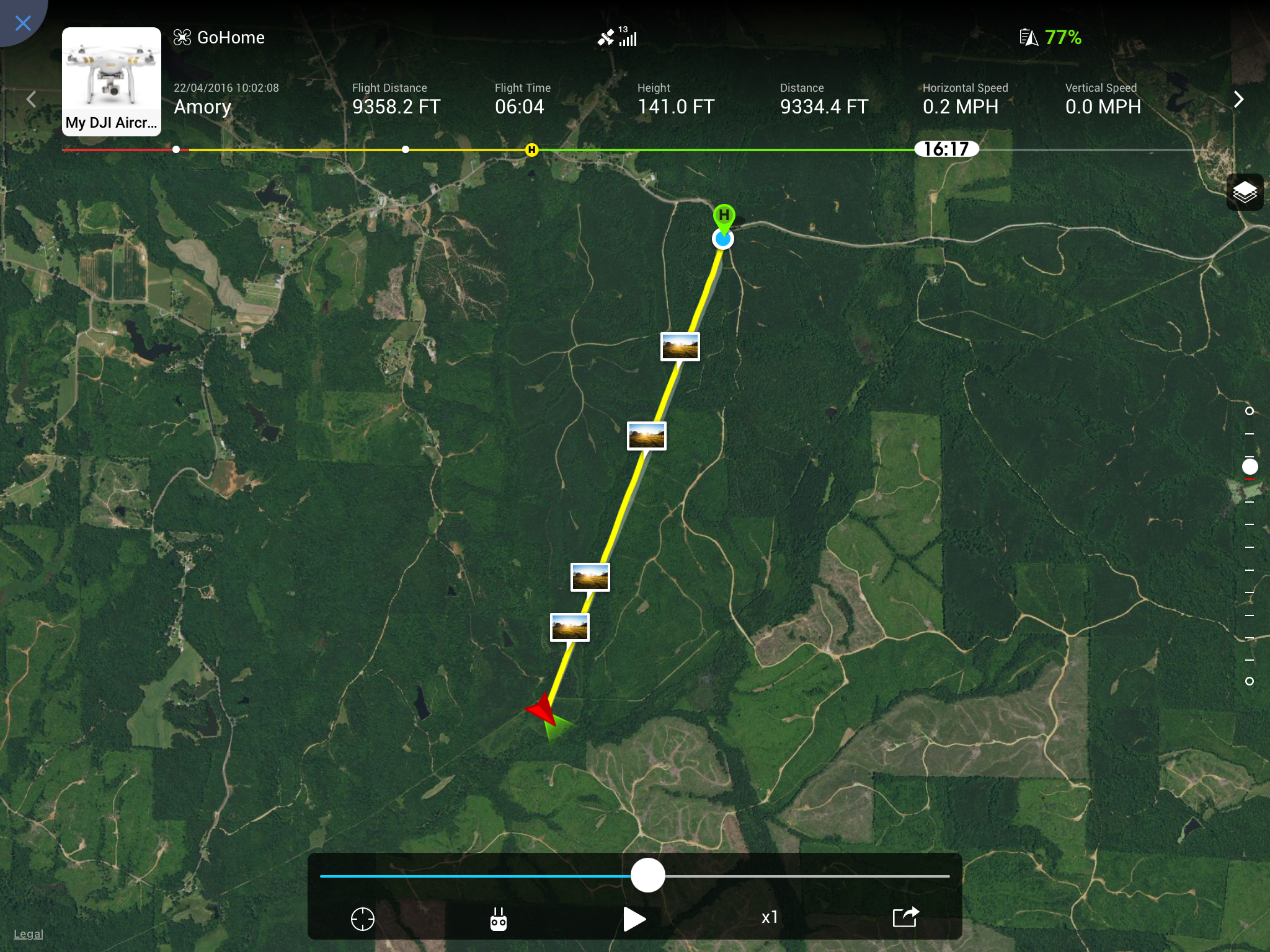

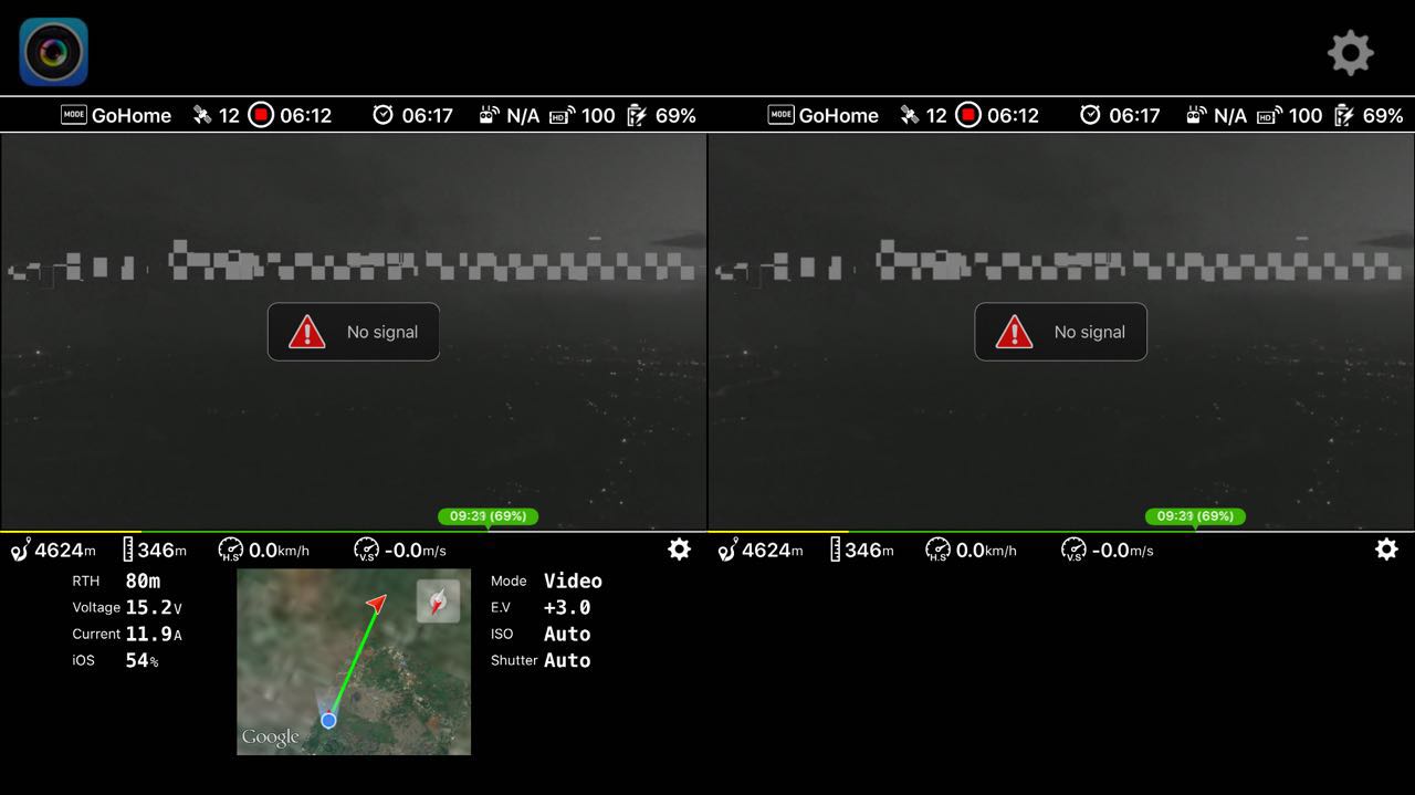

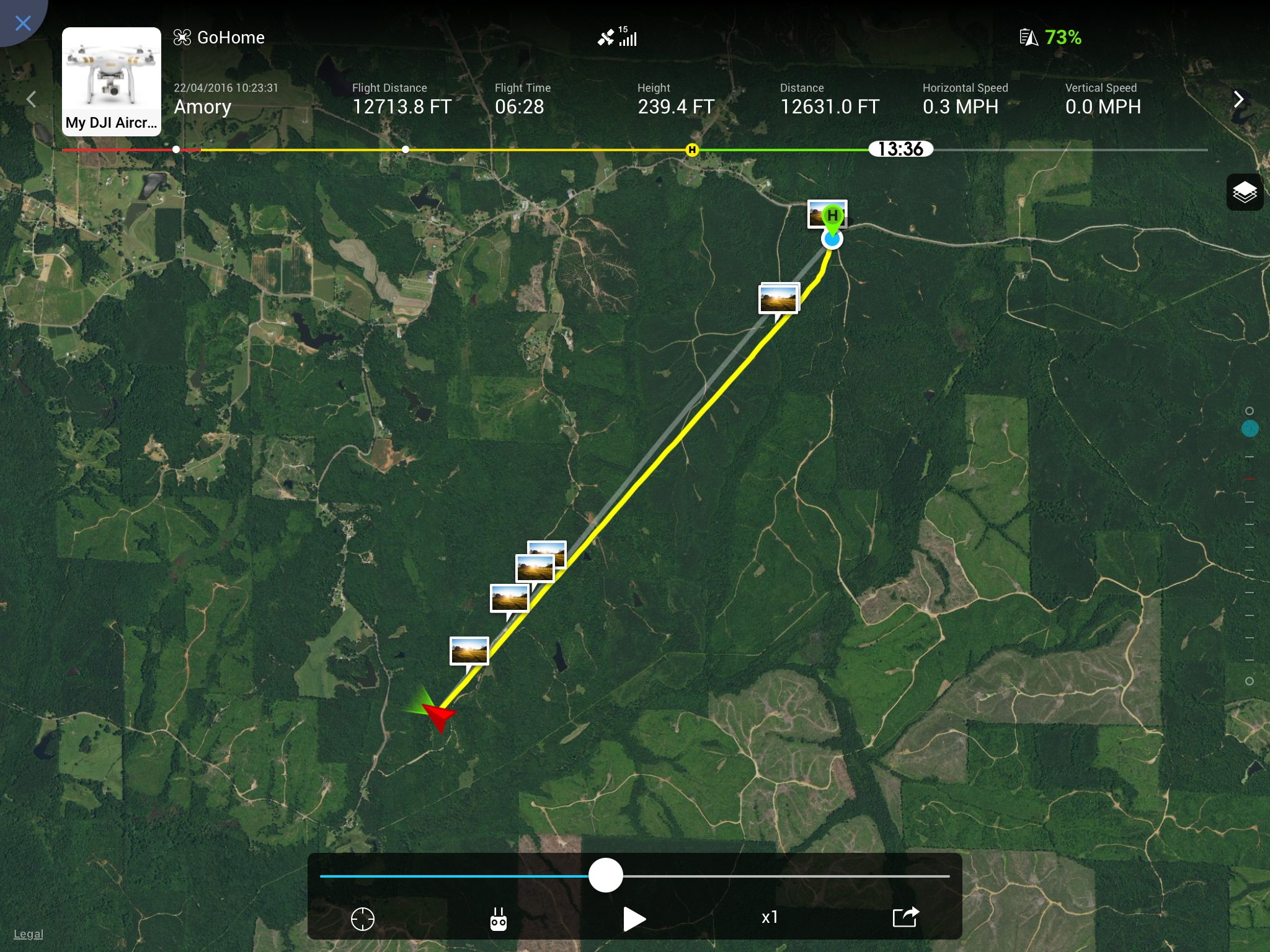

Have just got mine and out of 16 flights which only a few where to check distance stock I got these
IMG_3777.PNG IMG_3779.PNG And just ordered the same panel for it last nite .It's ether in one of your settings a bad cable 0r
one of those pins is bent over on one of your connecters .
Now as far as using an FPVLR which I have on other birds I have I say it won't , not if that's all your getting with the panel .
You have something off and would recheck my connecters real close .
After I checked and made sure the connecters were good in that TX I would also put a little hot glue or silicone over the connecter .
Just what I would do.

The pic that you've attached, is it with the "Stock Phantom 3 4K"?
Yes and it's 2 screenshots of test runs . P3 4K . Just got it a few weeks ago .
Reactions: J Dot
Dirkclod, that range is ridiculous... There is no way mine would fly that far in the best of conditions, stock OR with my DJI mod... Were you very high elevation above your drone? For instance, flying the drone in a valley lower than your standing when flying?
One thing, it does look like you are in the middle of a forest with zero signals anywhere near, which is a huge help. My max range without mod is about 2600 ft, haven't tested with mod yet (trying tonight). But that range is just out of control.
Yes I do all my testing there because of no noise and am flying into a little valley . I am lucky to have a place so close to me like that .

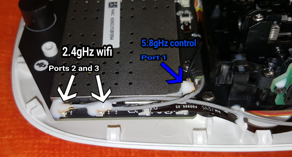

Is the 5.8GHZ the cable plugged into the spot under the screw?
See Screenshot
If anyone can confirm, I need to know, which wire ends up at which port on the ITELITE?
I have a P34k also and they didnt send instructions.
I appreciate any help.
I just thought of another question as well. What is each channel used for on the P3 4K? Does it even need 5.8 GHz?
See Screenshot
Yes
Port 1 is 5.8 and 2 & 3 are 2.4
