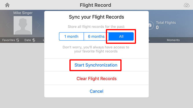

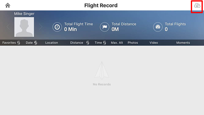

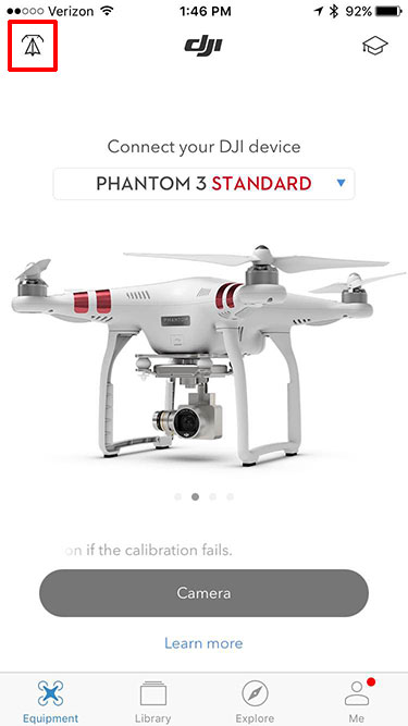

Before you uninstall DJI GO, you need to sync your logs like this:
I don't remember if that function was available before it would quit but I now know the correct process going forward.
