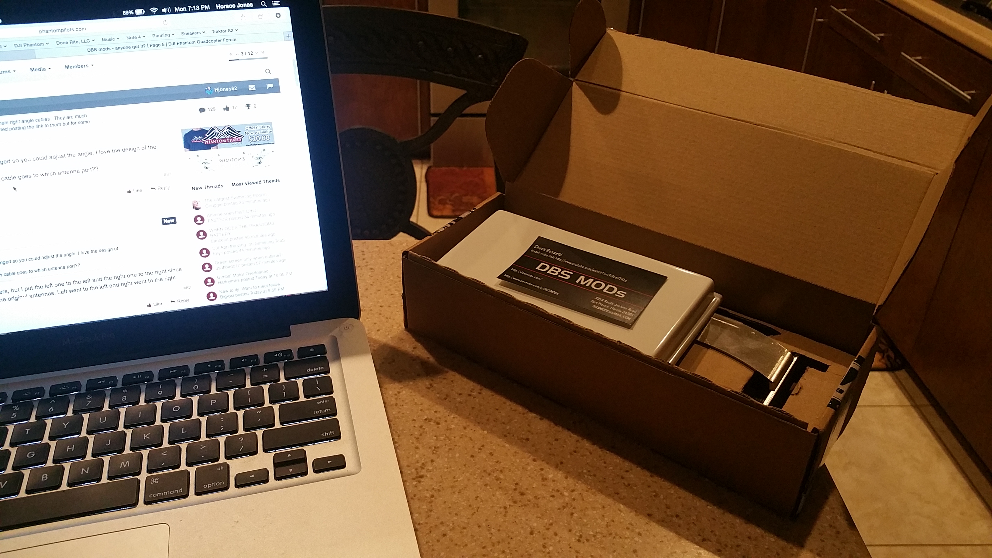

Just received my ITELITE antenna in the mail to find out the link provided in the box on a card from DBS MODs doesn't work. I went to ITELITE website and apparently it only shows a install on a Inspire remote. @DBS You guys think I can get some help here with issue?
Just received my ITELITE antenna in the mail to find out the link provided in the box on a card from DBS MODs doesn't work. I went to ITELITE website and apparently it only shows a install on a Inspire remote. @DBS You guys think I can get some help here with issue? View attachment 25971
Yep, just use the Inspire tutorial video. That is what I used. Same process except you will not do the modification for the 5.8ghz channel since the P3 does not have that.
