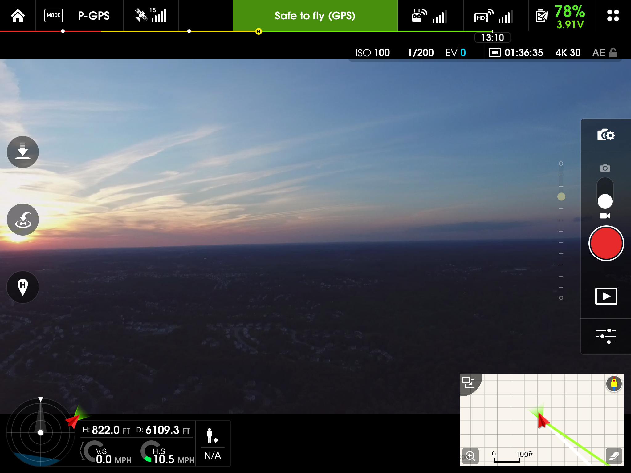

So the good news and bad news. Installed this today without having a toolkit but had a lot of tools to use at my business. You absolutely need a set of mini needle nose pliers. Could not have done it without them. Flew the bird yesterday off my balcony. Got 7850ft. Flew tonight after upgrade. Got to 13500 in the same place, then had 2 issues. Bird was 5 bars signal then nothing, returned to home and cancelled after regaining signal around 13100. Flew straight back and continued to have 1 bar for another 2-3k feet before it came back fully. Now the really shitty part was the head wind forced me to land at 7500 feet out, was able to recover but somehow my lens and gimbal are broken... Beware of differences in wind patterns as I only had <5 at take off.... 2 miles way is a lot different. And yes I turned around at 72% battery so pushing it wasn't the issue.

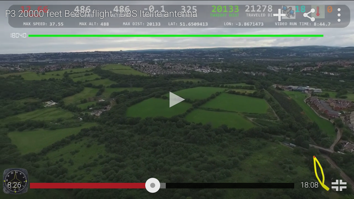

I am not sure you can come to this conclusion. I flew 20, 000 feet and I never managed to do that before in the same location
My limitation was fear of battery life. I turned around at 20133 feet as I didn't want to run out of battery. In the end I had 31% battery left. Next time I will aim for 25,000 feet same location when the wretched wind dies down.
