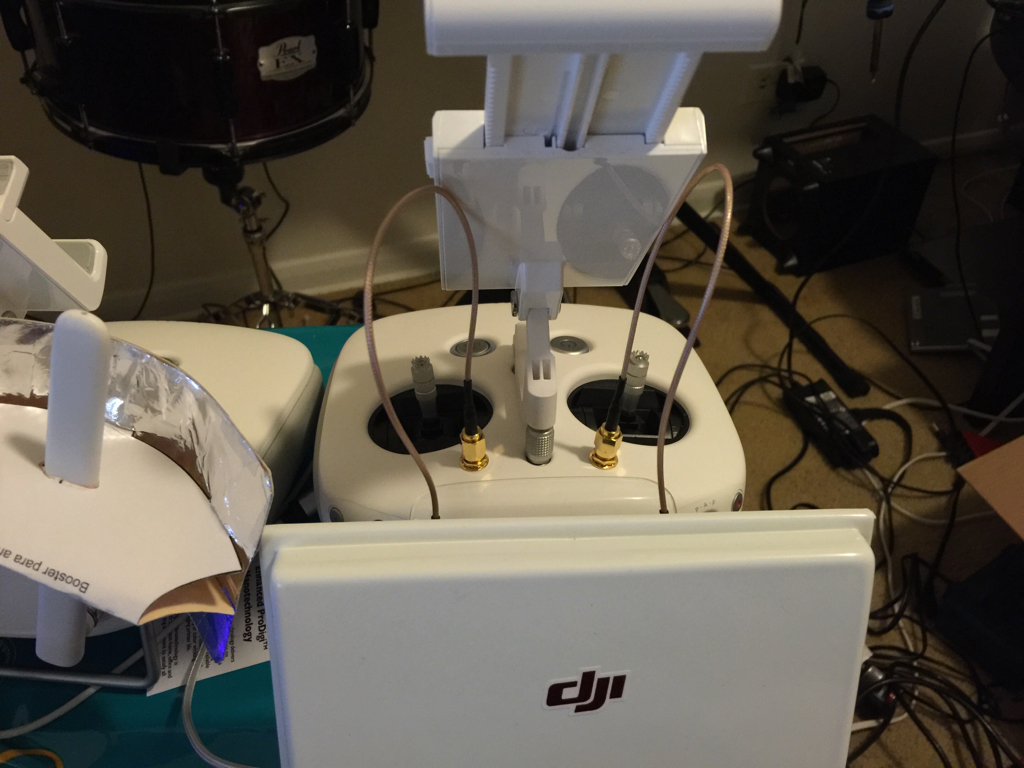

Got mine on Friday, installed in about an hour or less, easy to install. My box didn't have the little rubber plugs for the holes from the original antennas, but no big deal. Range is definitely really impressive. The plate should be pointing in the general direction of the bird (expected) but I was able to achieve an altitude that I otherwise would have 1 bar on RC and HD in my area, with full bars while holding the controller parallel to the ground. Oh also, instead of removing the ribbon cable from the little board with the USB ports, I unclipped the two side ribbons and unscrewed and removed the board itself, this made the ribbon cable removing MUCH easier than having to remove it using the needle nose angled pliers, just an FYI.
I also achieved a quite better horizontal range in my area (lots of trees and buildings) than I did stock.
I will test horizontal range tomorrow in a suburb where my parents live, but I have no doubts. The controller looks really cool with this mod too [emoji16]
View attachment 25807View attachment 25808

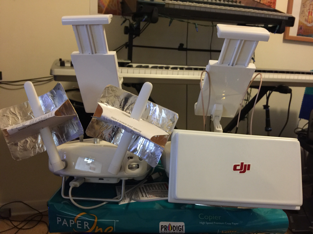

Yeah I have two P3 Pro birds, not sure if I will do the other controller yet, the little aluminum home-made boosters work quite well!
So much excess rf coax between the rc and the dbs mod antenna system, I wonder why, id tend to cable tie that down into a few rolls like a garden hose
Yeah, that's just how it was sent, maybe they don't make them smaller or something? Good call on shortening the cables though. I wonder if that would cause any kind of field change though? Though I assume that they are shielded from the looks of it. I kept them unwound to replicate DBS photos, but if anyone has any comments about winding them up and it not affecting signal in anyway, I'm down to clean that up. I don't like that the cable touches my phone/tablet, but it doesn't bother me much.
Check on ebay for 4in or 6 in sma male to rp sma male right angle cables . They are much thinker and cleaner . As well as less signal loss. I tried posting the link to them but for some reason I can't get the link to post.

I'm going back into the controller to separate the connectors as much as possible to see if maybe there was some interference from having them close. On a different note I prefer the look on the DBS much better than stock rabbit ears, lol.
Reactions: merophosis
Have you got yours installed yet ? If so how were the results ?
Yeah! I posted my pictures of the install a page or so back on the forum. The results aren't too shabby! I assume that these cables are shielded (I mean they look pretty shielded) so I don't think internal separation is necessary, since the old wires were really cheap and had a cheap thin plastic coating and they were practically on top of each other. Though if I remember correctly, when I sealed up my controller the two cables were fairly separated.
As I mentioned a few posts up, my results were better than stock. The mod is pretty dependent on orientation, so you really kind of have to point in the general direction of the bird (which is expected, but it's slightly more sensitive to this fact than, let's say the windsurfer booster)
I managed to climb to an altitude I otherwise had 1 bar on RC and HD, with full bars using this mod (same with windsurfers)
I was also able to get a much greater distance in a heavily dense tree population than I did with stock. All in all, from what I've noticed thus far, is that this mod is really perfect with a nice flat land and a long distance of just open fields, kind of like the demo video. I would have to drive out a bit to find an area like that. I'm happy with it though, I don't worry at all about signal flying with this mod at medium distances. I got the mod so that I could do some distance flying when I get to an area that will allow me to do so, which should be soon.
I agree. I like that using this antenna, you don't have to adjust anything. I'm not a fan of folding ears either. Plus the controller looks cooler now. Ha!
Actually, they are not very shielded and VERY lossy at 2.4ghz. Because of their short length, those RG174 jumpers don't matter as much but by moving up to an RG58 jumper cut to size with right angle connectors put on, you could potentially regain about 5% of lost power in that jumper. I just ordered mine. These mods are cool but only so much can be done before amplification is required. A mod I think would be much more worth while is an antenna mod on the quad. That 2.4ghz antenna in the quad has got to have room for improvement. I'm thinking a quarterwave sticking right out of the top!!
