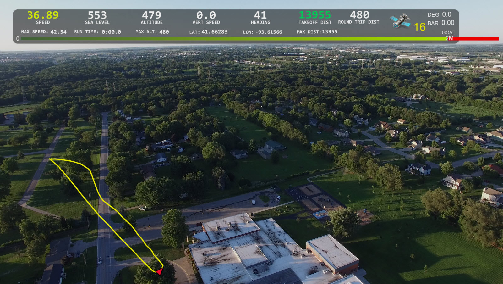

Awesome. Took it out for first time last night. Flying out of hole. Quite impressed.
