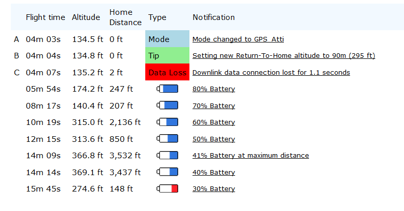

Slightly different, but its really hard to say from Airdata. You don't get enough information without the .csv file. However if you notice in the second file The home point altitude was changed, therefore assuming the home point was also changed, but need the ,csv file to confirm that, but just from looking at this, this was changed at 4:04 in to the flight at 134.8 ft..( Notice the home point distance)

Wow well spotted. Didn't see that [emoji43] I am quite happy to say I must have some how changed the home point. That I can accept. But why is the map different saying I flew in a different location? That really puzzles me lol.

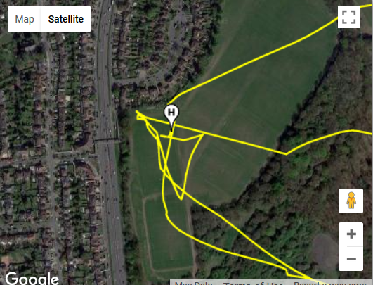

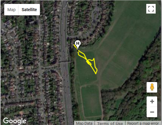

Here are the two flights, they are not that far apart.
The first one at 8:40, the second at 8:44

If you zoom in on the pics, you can see they are at the same location. As in post #11.......These are zoomed to closely match. The home points are not that far apart......

I'm also not seeing the problem here either - as @Fly Dawg points out you are just looking at two different zoom levels. If you adjust the two airdata map images from the links in your first post to the same zoom, you get the following:
The homepoint has moved slightly, but it's exactly the same corner of the same park.
