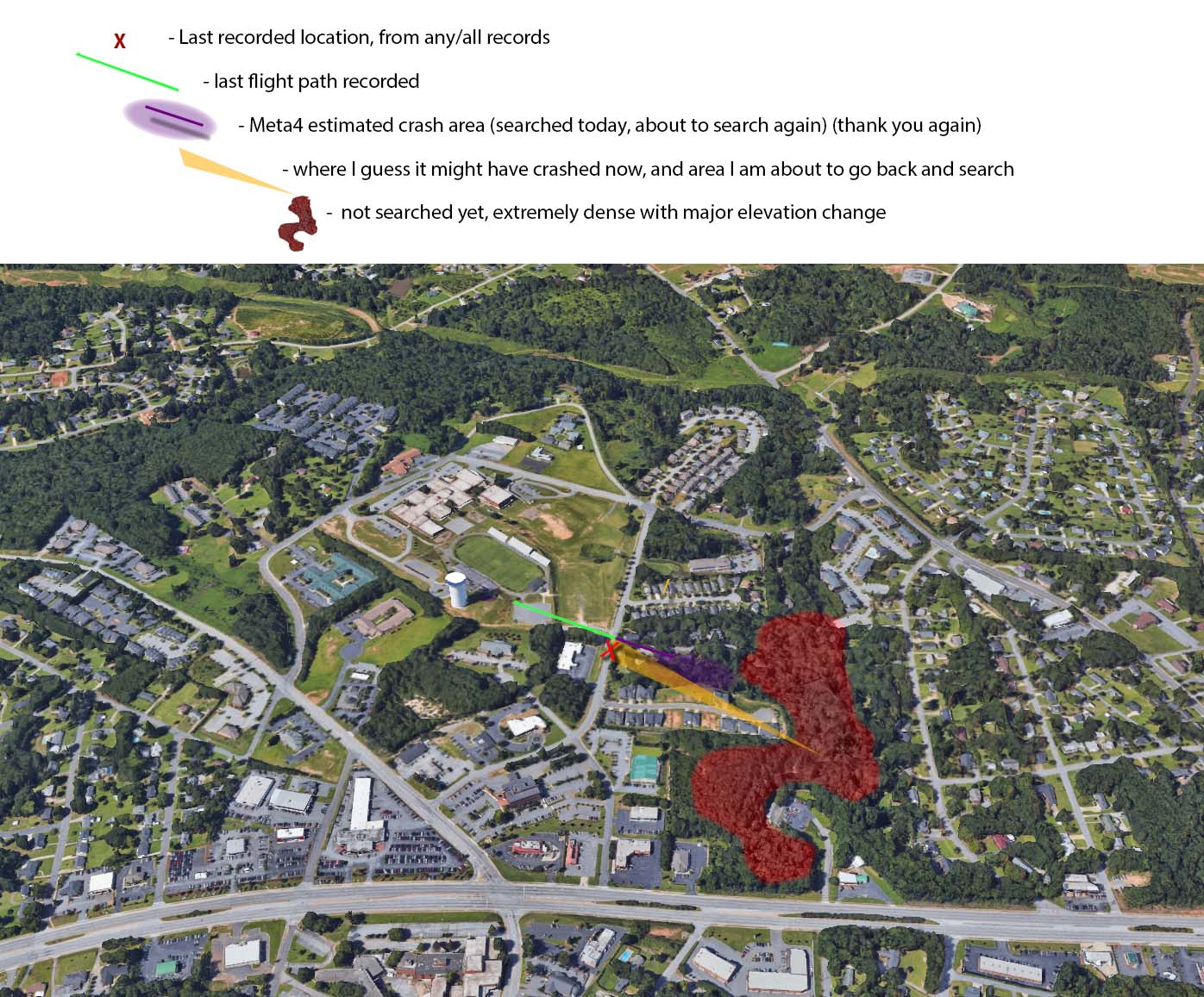

The small arrow indicates where signal was lost and the larger arrow shows a likely search location.
There are quite a few trees in that area.
The Phantom could have caught in one as it came down, possibly further west on that yellow line.
I totally agree with you, 3putts. This morning I searched that area, high and low. No luck. I will elaborate further in 3-4 hours, when I have the time. For now it remains a mystery. One that would be far less mysterious, if I knew the answer to one question.

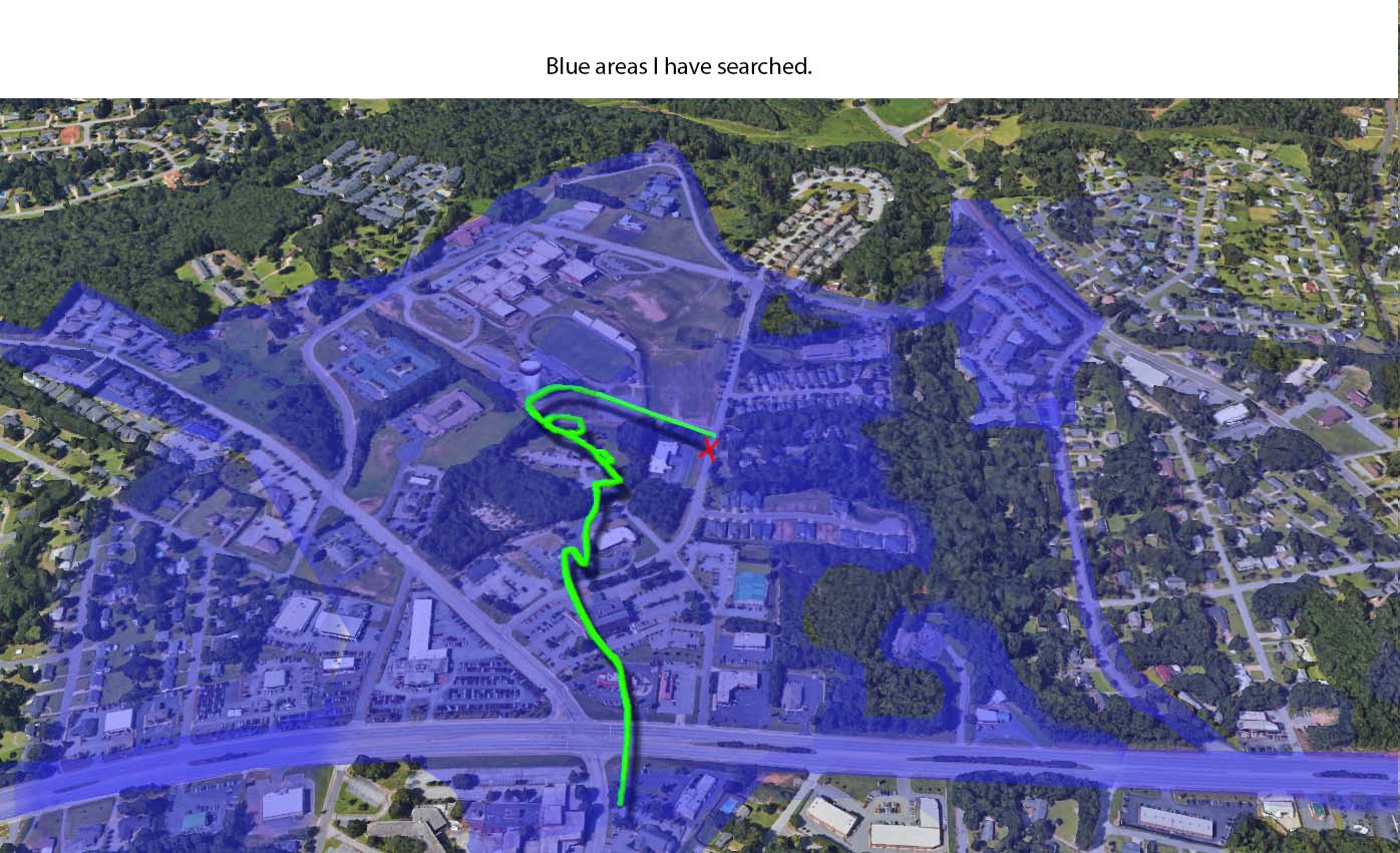

Check these out for more info.
Yes, they have reserved a chapter for me in the DSM-VI.

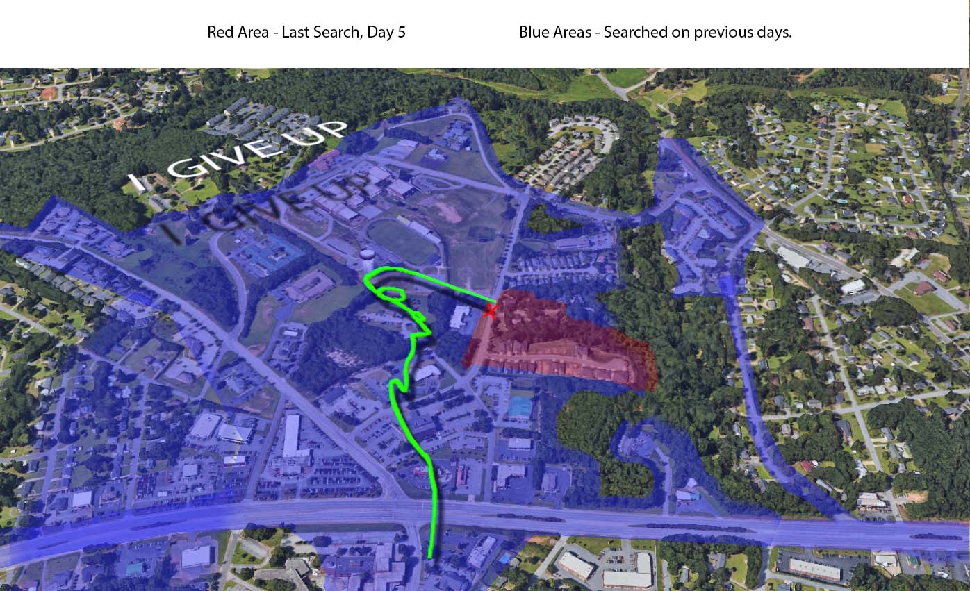

Just got back from my 10th time out. Some of the area searched today was for the second or 3rd time. I really appreciate the interest and advice from this forum, so I do wish I had better news.
Alas, I just do not.
