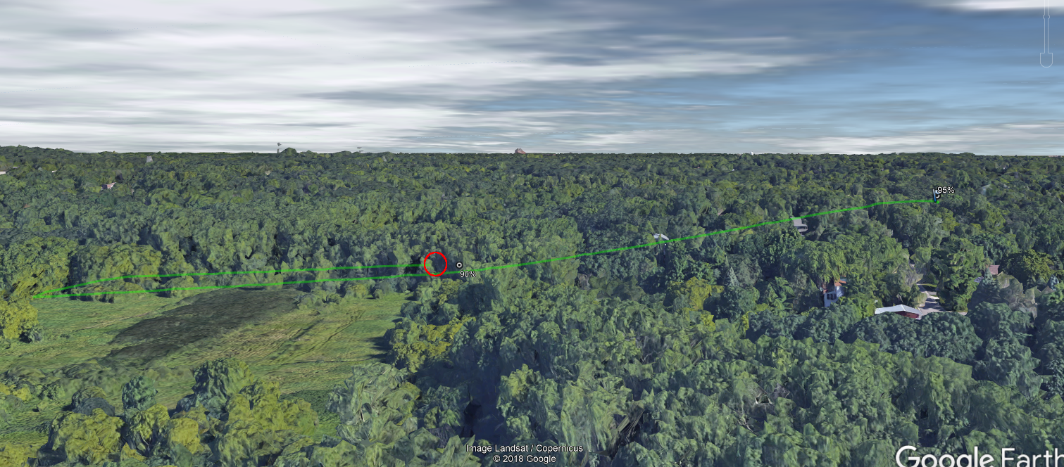

Just looking at the altitude prior to impact it is showing only 43 feet. Is that accurate? If it is, just by looking at street view near the crash site the trees in that area appear to be taller than 40 feet.
Well, looking at the KML file from the phantomhelp site (using google earth) it does look like you're flying quite close to the tree tops rendered (note: google earth height renders are approximations so some may be higher or smaller then rendered).
Also, your second waypoint out in the clearing there looks lower than your original altitude over home-point, it it possible your last waypoint's altitude was set too low?
Certainly looks like your phantom plowed into and/or got caught by a high-reaching branch on the return leg.

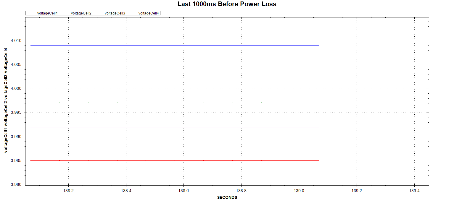

I agree with the .dat, however in every impact instance of every flight I have looked at ( And there are a lot ), there are always extreme deviations in attitude at any impact. The data is transmitted at 10hz. That is more than enough time to see any sort of impact.
Hmm, true enough, and it's very likely this is another case of sudden voltage drop in the last 200 ~ 500 ms before FC logs stop. Still, data from the aircraft is far less refutable.
Not according to the log's. This is the last second of the flight. There are no deviations whatsoever. It simply stops. But even the .dat file will not tell you much more in a case such as this. But when you have the device logs for the Entire flight, it is still quite useful.
So that 42 feet means that it was 42 feet above "HOME". Not those trees. Yes those trees are like 80 - 100 feet tall. The last part of the video feed shows that the drone was WELL CLEAR of any and all trees. So yes I am 99% certain this was the fault of the battery disco. I was flying from on top of a hill. Let me say, that is where the drone mission started. If you look at the path of the mission, the drone had passed WELL clear of all trees on the way down. So on its way back it had already cleared the highest trees before it even got to the waypoint 4. I guess I have to upload images to Drop Box and I will show ya.
Don't dismiss it, the previous two suspect battery disconnects I analyzed showed a sudden voltage drop from 15V to ~7V in the last 200ms before FC stopped recording. In both cases app logs just stopped as your analysis shows.
Yes altitude from home point with a deviation of +/- a foot or two as it's derrived from the barometer. I can certainly see it climbing back up again on the return leg but it's impossible to rule out anything at this time.
You need to configure it sharable......
Don't dismiss it
Not dismissing it entirely, however all the data points to the same issue that has been noted on numerous posts and analysis with the P4's, which many of them I have looked as have a few others. I can understand a different issue with your noted voltage drop but these are different. This is apparently why DJI added the latch sensor to the V2's, as they as well seem to understand there was an issue with the battery dislodging. This data shows exactly as others have, and points to the same conclusion. That is all I am saying.
