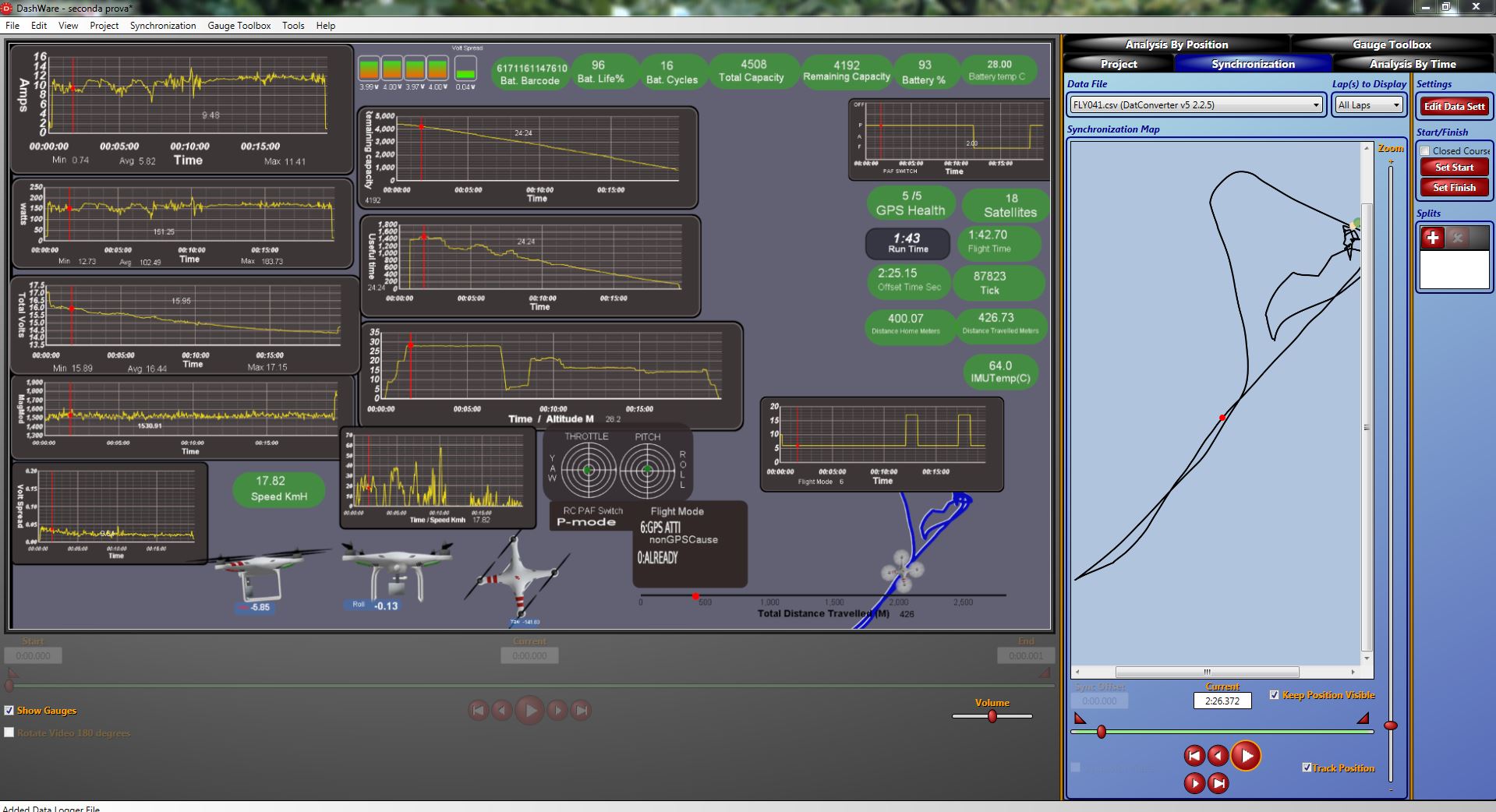

So it works now on my side !
What I did was to install DatCon 2.3.0 and use the same settings about Time Axis that Luap Showed me in the image above.
I don't remember exactly which settings I used but I'm sure they were not the same .
I think on wednesday I choose " Flight Start " as first choice and then " Motor Start" and " Motor Stop in the other ones.
I have to work now and can't test differences in my convertion trying different choices but I will do it later.
The sure thing is that now the correct path is shown, as in the attached image .
thanks for helping and compliments for this outstanding job!
Luca
Luca
