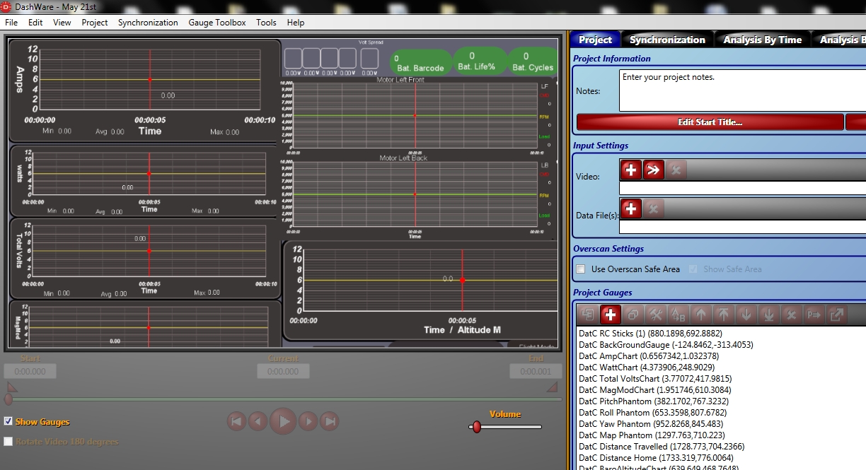

b) . On my standard windows setup it will not resize any part of the gauges, and the canvas remains locked. This is the number 1 reason I have not shared any dashware created videos using the most data detailed converter.
Hi Frank, you need to select a Video File by clicking on the + circled below in black of size 1920x1080 to resize the canvas to the template size. Let me know if that works. Maybe post it in a new thread so as not to hijack this one.
