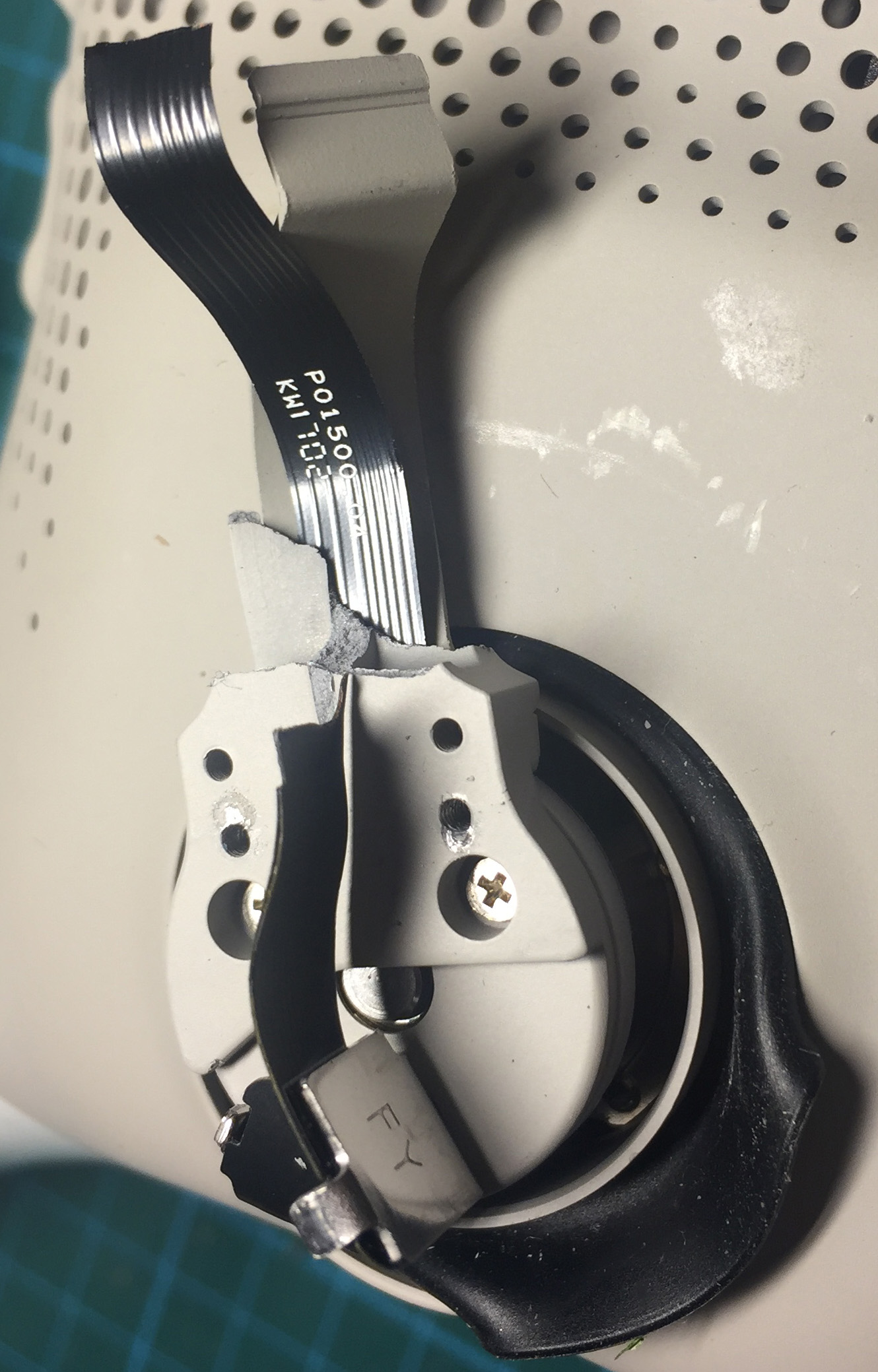

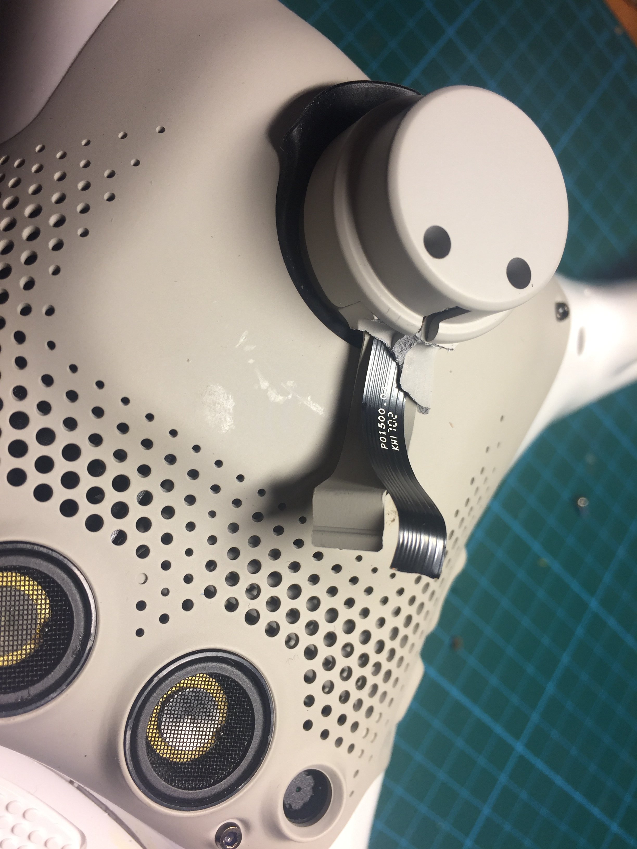

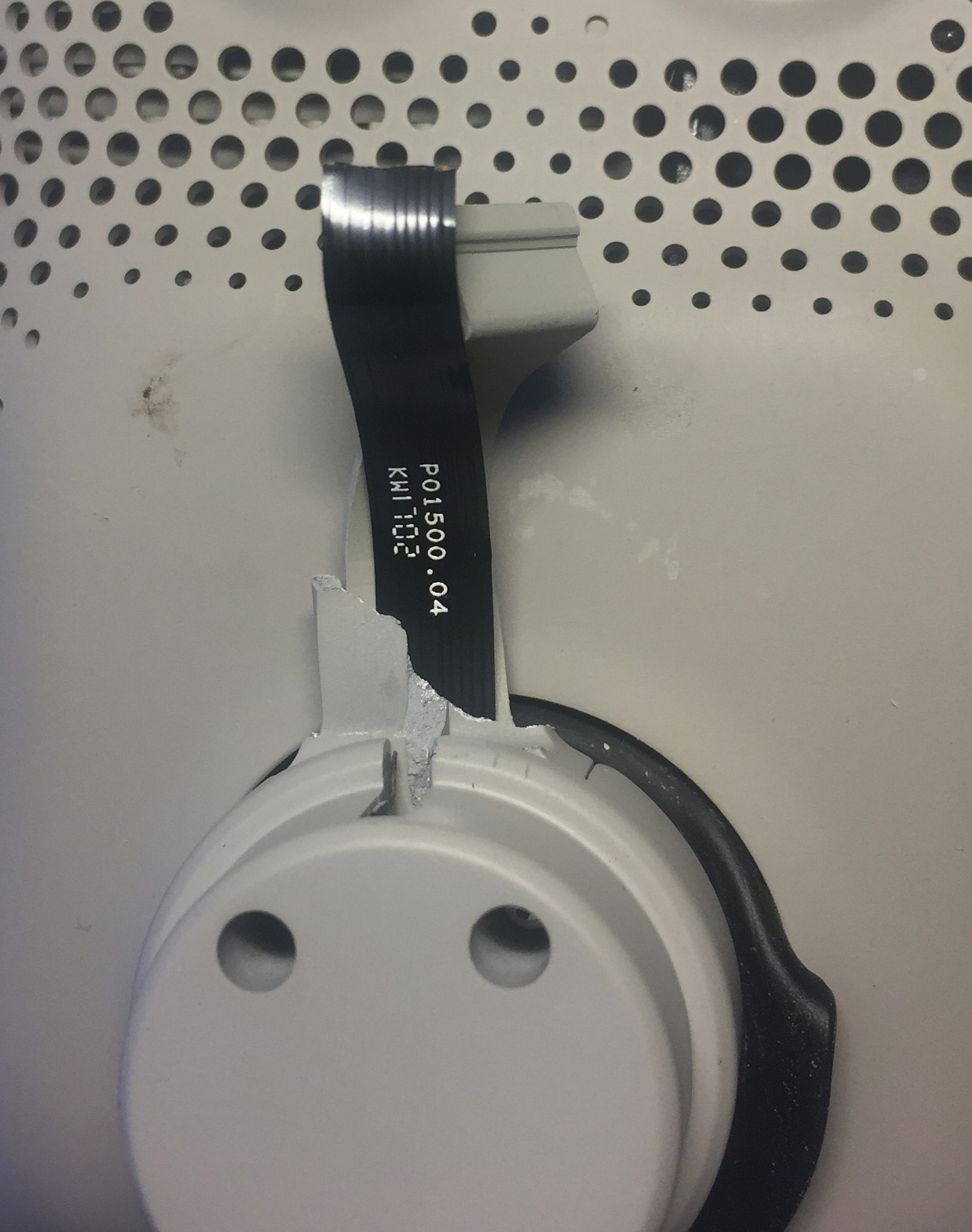

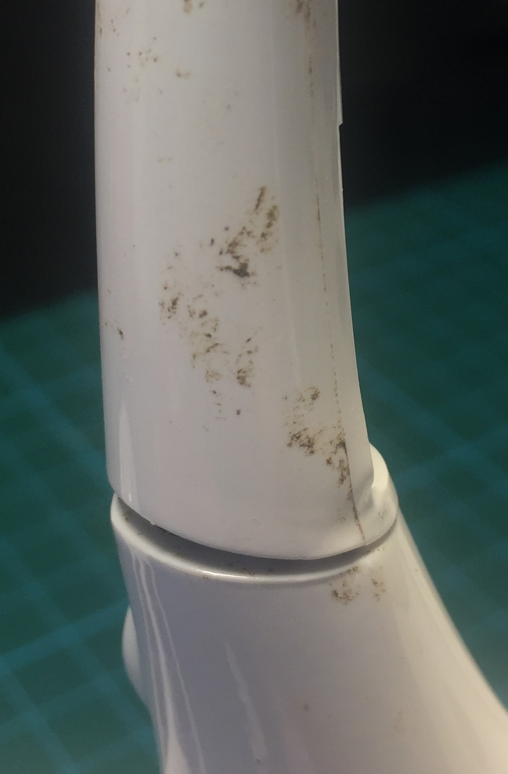

I flew my P4P into a tree top so it fell to the ground and injured one leg so bad it needs to be replaced even the other leg got a smaller bang, so it's probably best to replace that one too. What's worse is that the gimbal went straight off but the camera is intact and looks well! Even the inner shaft of the gimbal, the one inside the gray stomach, seems to bee fine. I have tested the machine in general (without the props) and it seems to work OK and answers good to the joysticks. – Is there anyone in this forum that has parts I can buy or do you know where to buy these quickly? Preferably within the EU.

The good new is; You should be able to google for the landing gear or try Phantom Help. However the bad news is; unless the gimbal parts of the P4P vs P4 are interchangeable, and I don’t know if they are, it’s not likely your going to be able to find the individual parts to rebuild your gimbal. Maybe another forum member knows if they are interchangeable. You can however find the entire assembly, but it’s pricey.
You may be better off sending it in to DJI for an itemized repair estimate.

The P4 and P4P Gimbals (yaw arms in particular) are NOT interchangeable. Bummer, I know. The real bad news is that it would be better for you to send your drone to a repair shop rather than fix it yourself. I crashed my drone into a tree, breaking the yaw arm. I bought the parts ($80 worth) and tried to repair myself. Unfortunately, DJI uses soft screws which strip really easily and impossible to get out if they do. So, I sent the camera module off in pieces. Guess what? I had to buy a brand new module ($700). Arrrrrg.

Since a week back, I have ordered 2 landing gears (DJI original) the gimbal yaw arm and gimbal yaw+pitch motors from Ebay. Delivery though, can be as late as 21 december! I will let you all know if I succeed to mend the P4P. If so, I will approximately have saved 550 dollar, maybe more!

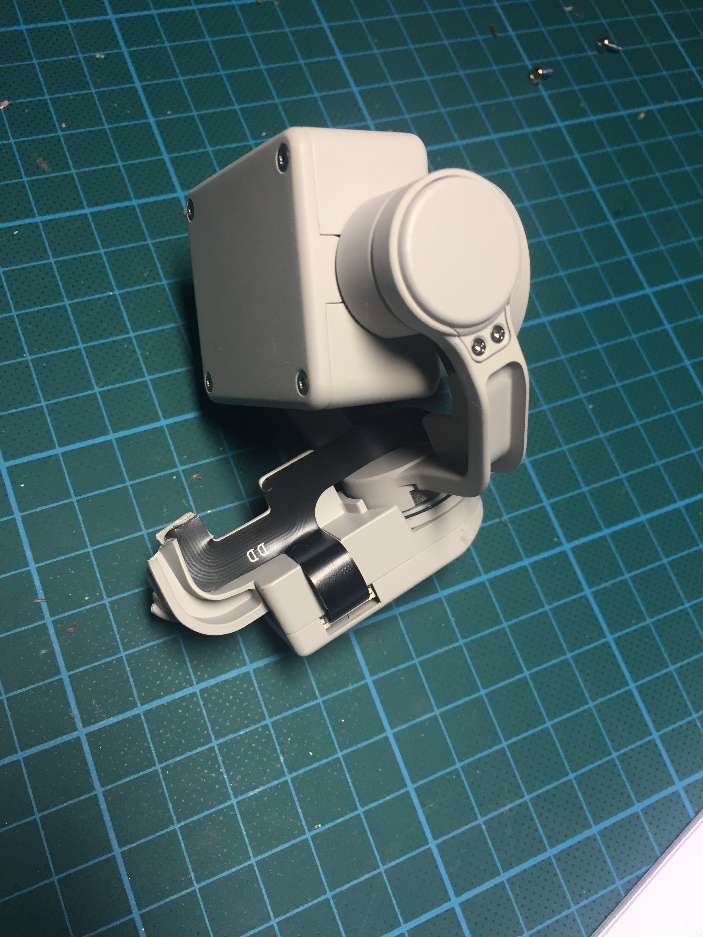

Sorry I havn't come back to tell how it went with my repair! Well I got my gears from three different shops in China, the landing gear original from DJI. Following a one hour Youtube video I managed to fix the gimbal. But! the long ribbon cable was longer and had a smal extra connection compared to the original. The shop insisted that it was the right one so I just mounted it and it seems to work. The only problem is that the camera is aiming some degrees to the left. I have made all thinkable calibrations and even tried to force it to point straight forward but it won't accept that and I don't want to twist his neck of. So if anyone has a ingenious tip to solve it i'd be more than thankful!

Did you do a dual axis gimbal calibration?
This kind of calibration is identical to a standard gimbal calibration except you balance the craft on the rear motors so the craft and camera is pointing straight up. Execute the same calibration routine in GO4 as you normally would with a standard calibration.
After that do another standard calibration with the craft level.
